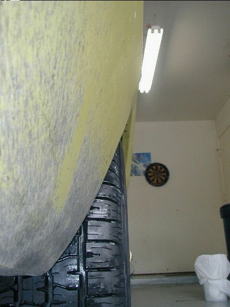

    Here is a pic showing where the rub was. It has to be a very hard launch to get it to sink far enough down to get it to leave this light etched line. These are the 255s on 8" rims. And this is WITHOUT any other mods, such as spacers, rolled lips, etc.
