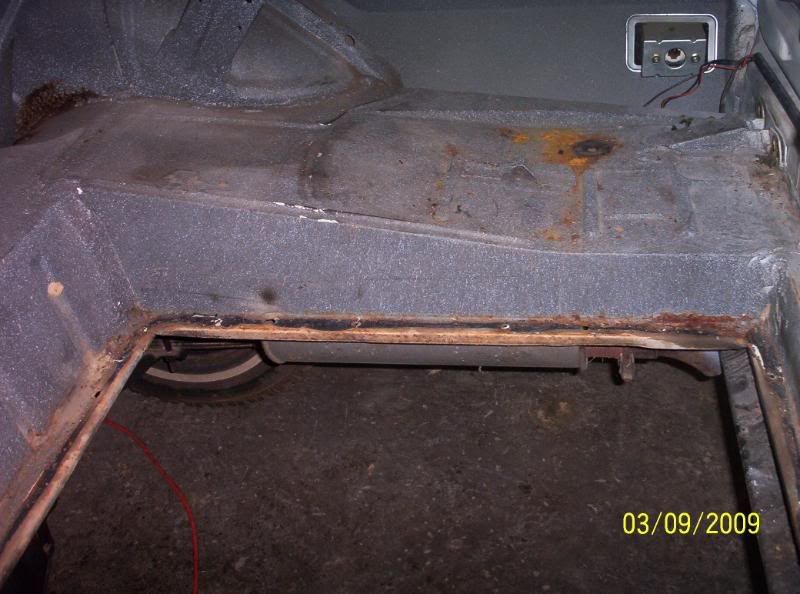

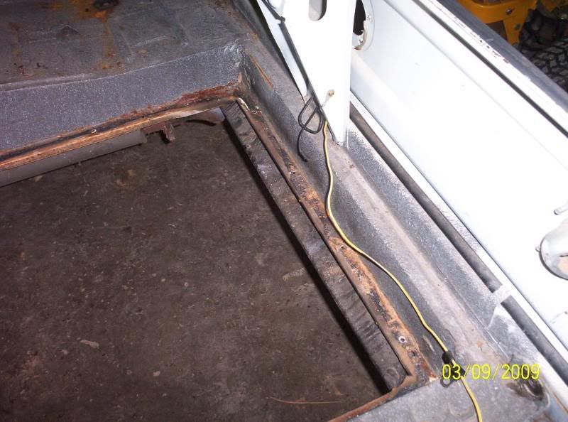

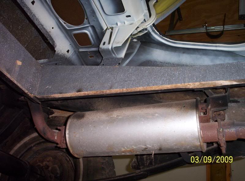

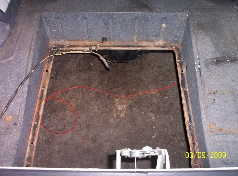

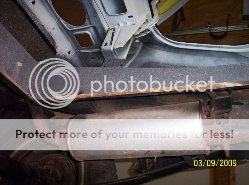

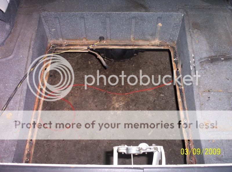

    before with stock tank removed
    Muffler must be relocated

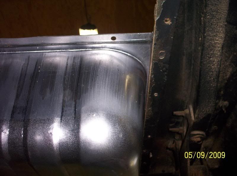

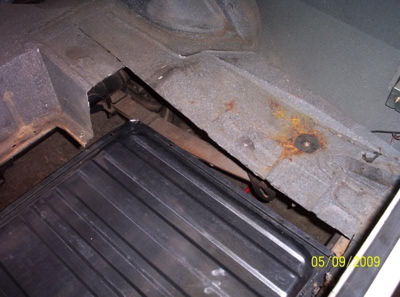

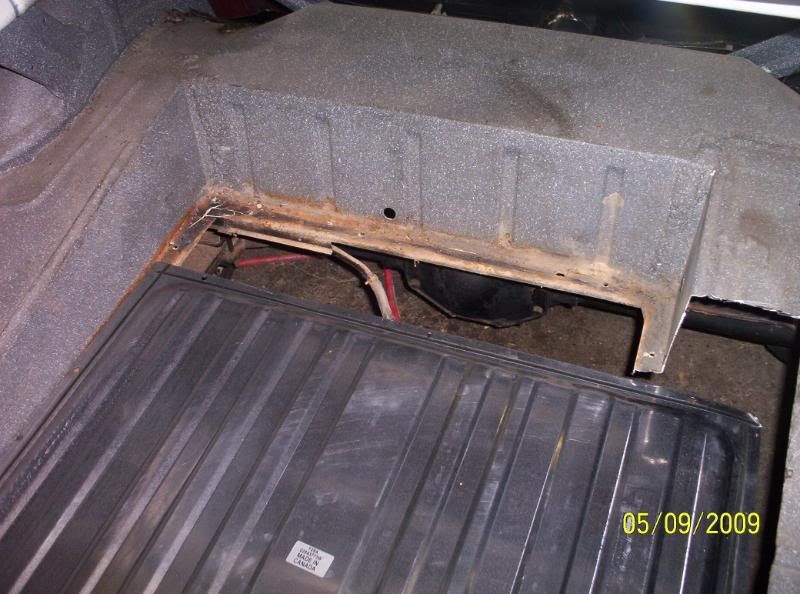

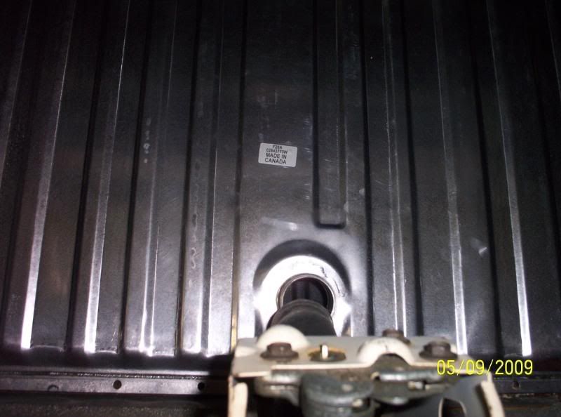

    After cutting out panel , I just placed the tank in to check the alignment of the filler tube / leaving the stock location on the left side is close enough IMO ......so I just cut out the right side to move it over

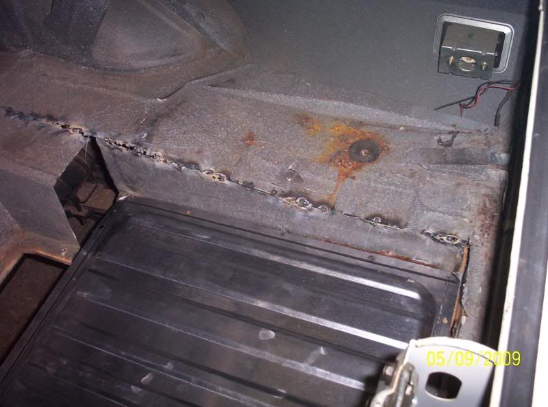

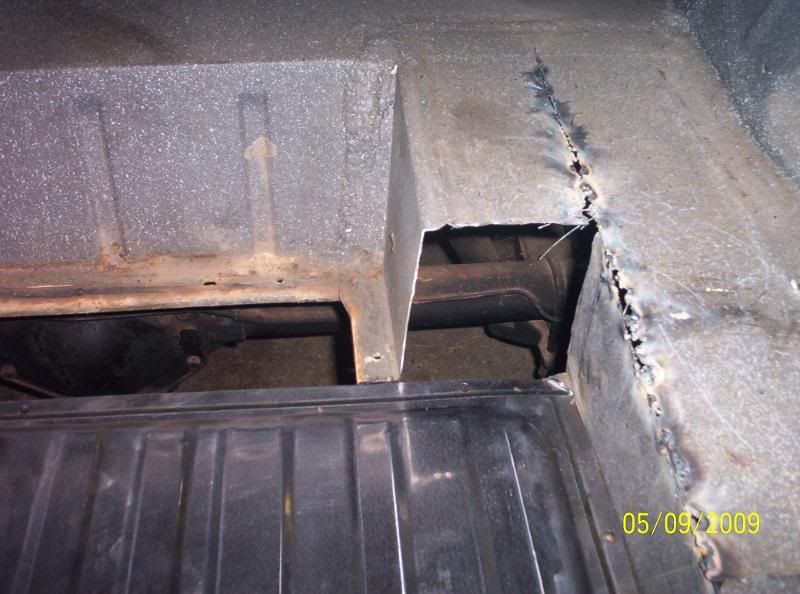

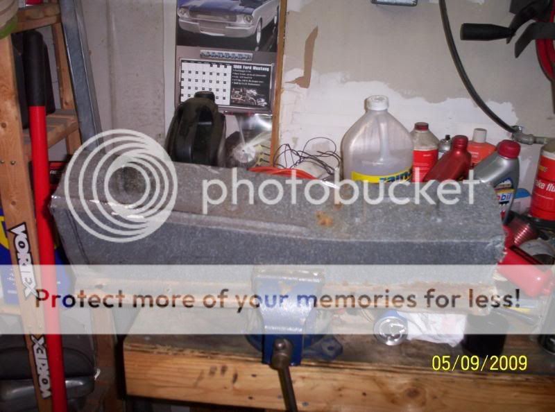

    this is the cut out piece from the right side / put it in the vice to cut off the muffler hanger and the top part of trunk material needed to be removed
    this leaves a gap at the front on the left , and a small box to fill in on the right side which I will make a lip on the bottom side so that the tank is supported all around just as the factory one was
    Just gotta go to tractor supply to get some sheet metal
    I know the welds are crap but they are only tacked right now till I can get a welder with a lower heat range so I can keep from blowing holes thru the sheet metal

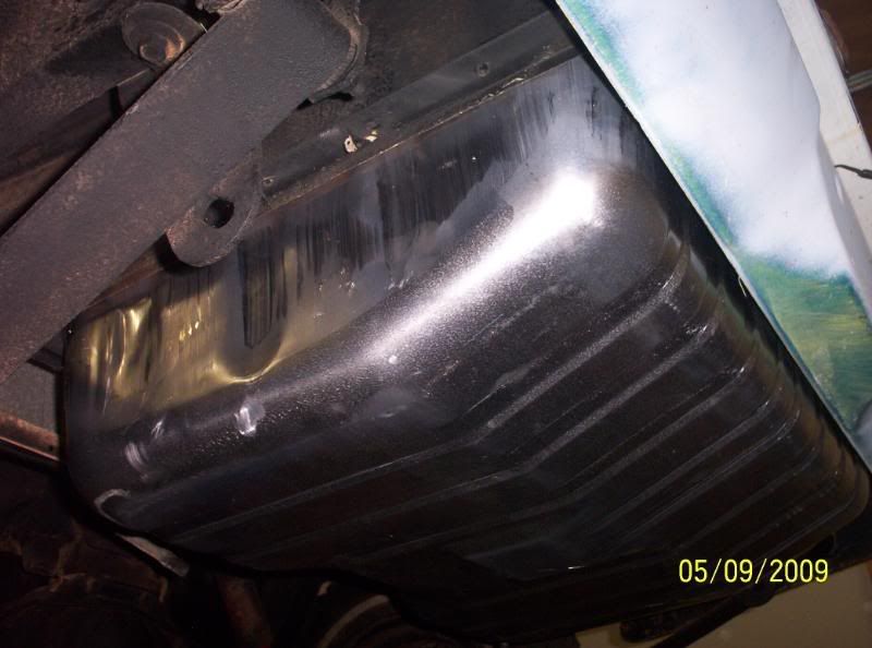

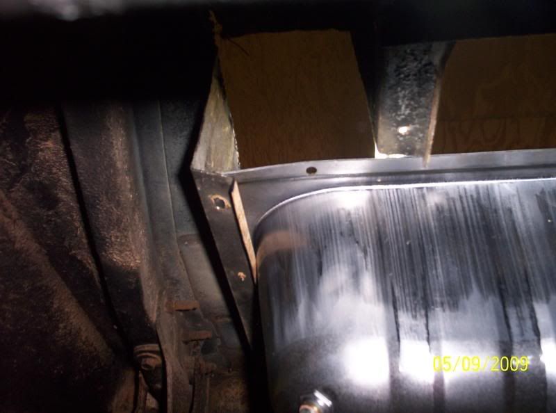

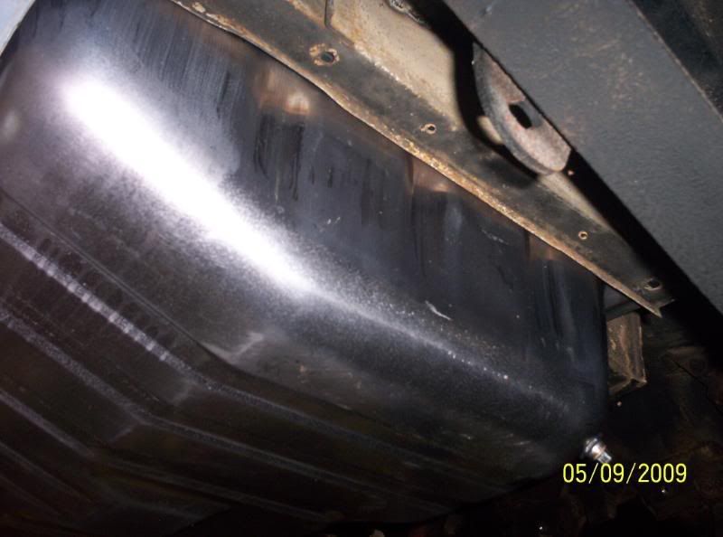

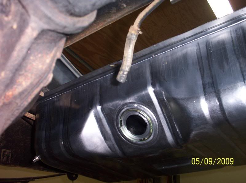

    pics from underneath
    fuel line will need to be longer
