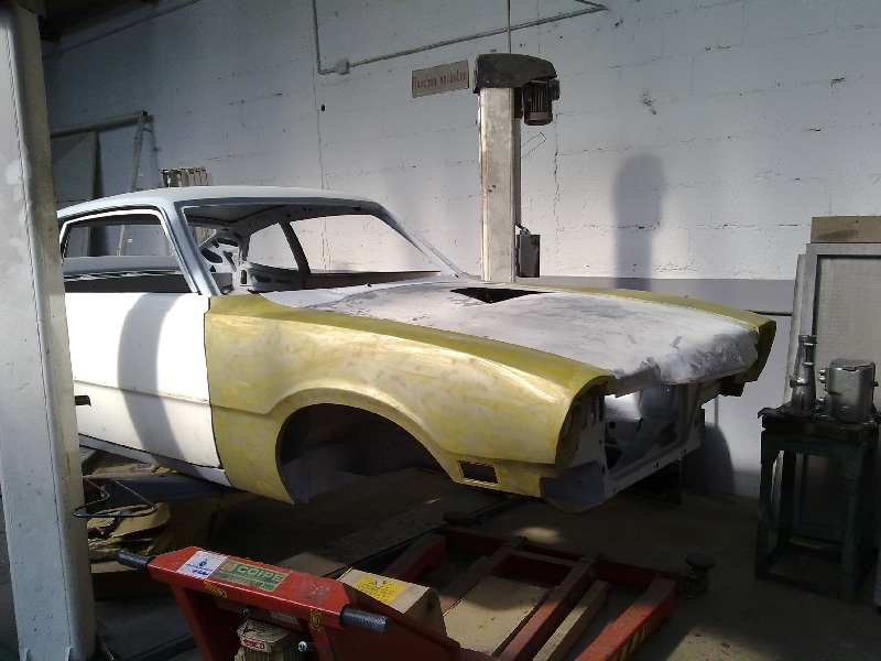

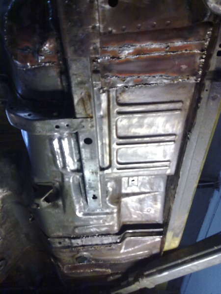

well, apparently they were able to get the frame rail back together. but the floor needed more patching than expected...

Fixing to start on the body or did I miss that?

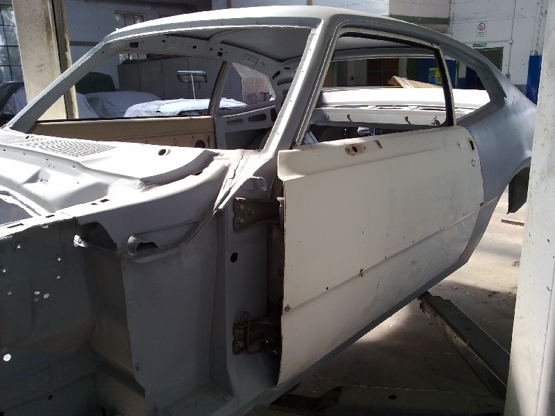

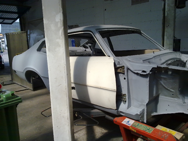

gene, where were you? bodywork is nearly finished

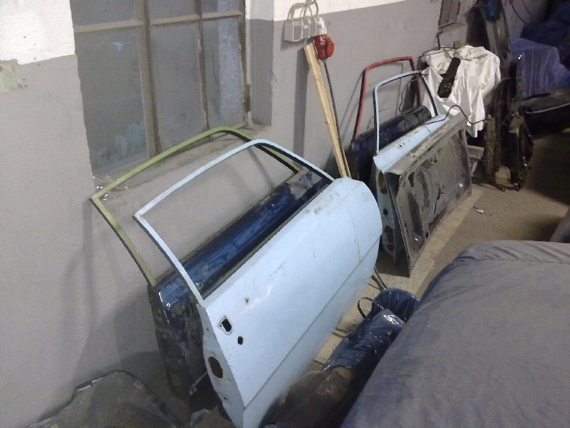

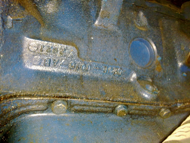

in the meantime i was able to take some more stuff apart - all four doors i have now, the mach1 seats and the wiring harness which looks really bad in some places...
oh, and i found out that i actually have a torino engine, casting D2OE-6015-AB. Casting date is 2G21 which i assume is 21st of July 1972, right? does this mean i still have a decent compression ratio and not the block with the odd 8.229 deck height? i'm asking because the partial vin stamped in the block indicates a 73 atlanta car...

Yup...short deck...8.206"

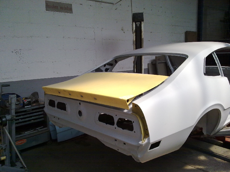

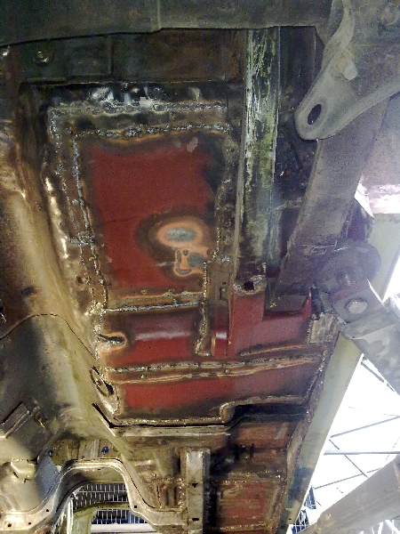

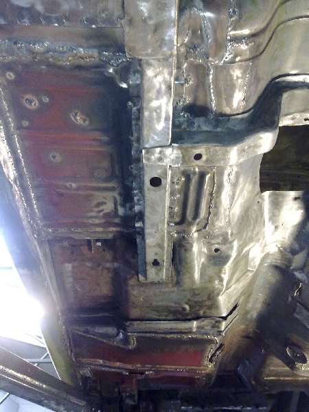

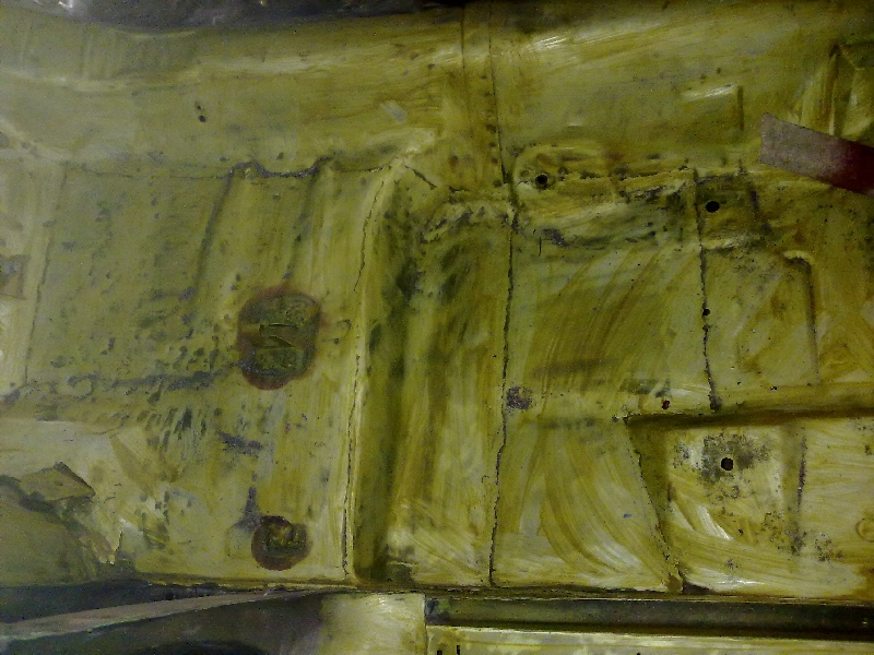

ok, before everyone thinks i didn't do any work on my car i'll post the last pictures for this year.
i started cleaning up the underside of the car so it can be painted properly. quite a lot of work, unfortunately:
you can also see how much of the floors had to be replaced. and how well the torque box that mean_maverick sent me fits!
more pictures next year

Gotta be some of the most extensive work to floors I seen yet. So then it gets cleaned and painted then undercoated?

thanks, gene.
i'll grind down the welds before painting, the car still looks very rough.
then it will indeed be painted - but not undercoated after painting. i have a hard time scraping all the black mess off the car which the previous owner advertised as "rust protection". it was just a cheap way of hiding all the rust
i have talked to the guy who will be doing the paintwork. according to him, the best way will be a layer of primer, a thin layer of a special undercoating and then a final layer of paint. thus, the paint will stay flexible and will not crack off when hit by stones.
