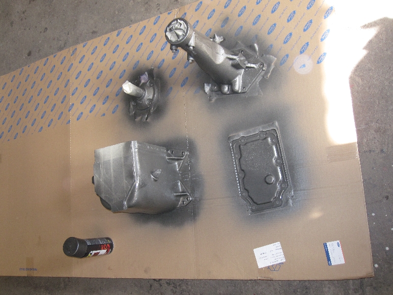

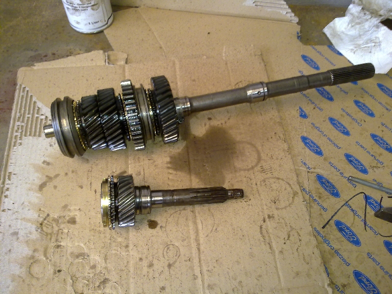

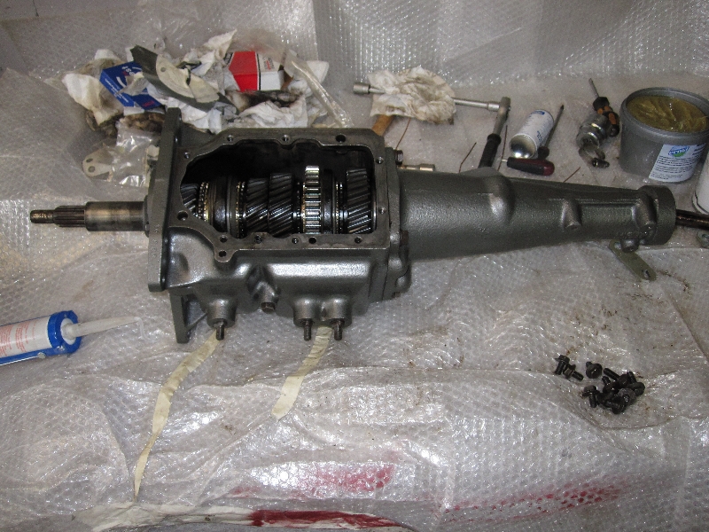

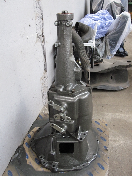

the toploader is now completely rebuilt.

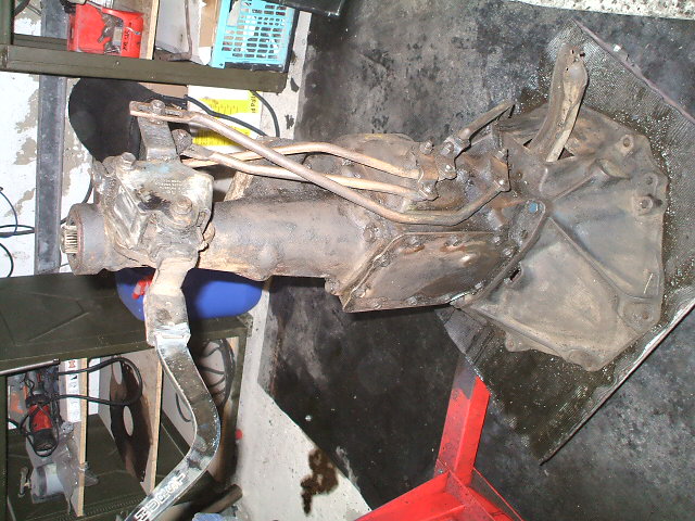

this is how it arrived:

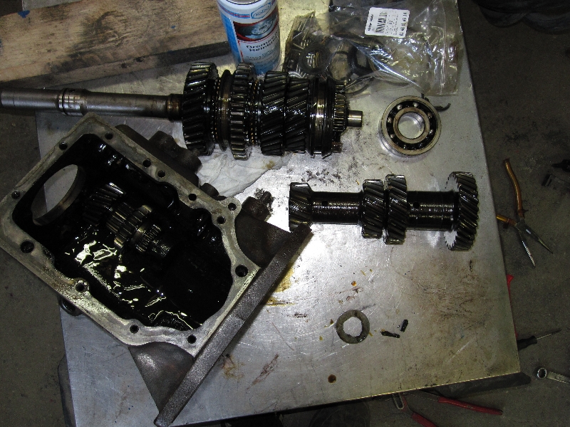

tore it down completely:
cleaned and painted the case:
both shafts rebuilt with new synchro rings:

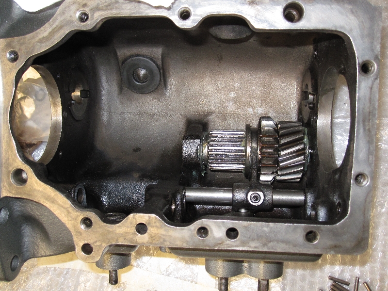

reverse shaft installed:
partially assembled:

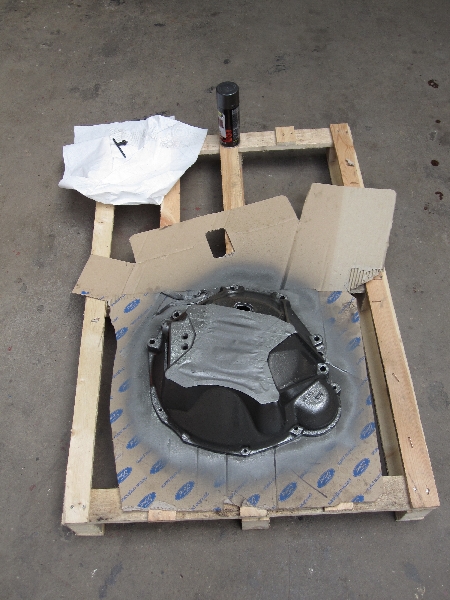

bellhousing cleaned and painted:
bellhousing and tranny back together:

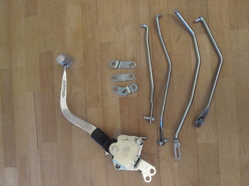

hurst waiting to be installed:
i didn't put the shifter handle back on as i messed up the tailshaft output bearing. i will have to install a new one, this time properly with a bearing press...

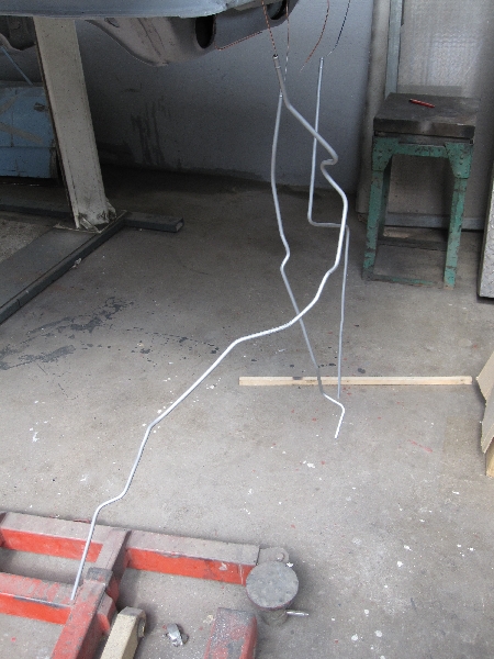

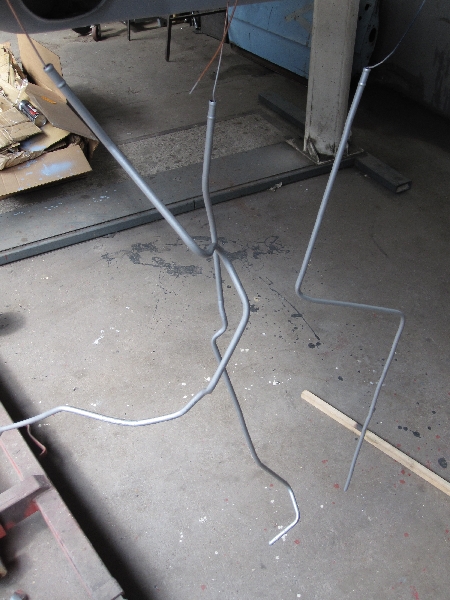

apart from that, i re-bent, cleaned and painted the fuel lines. the rear line unfortunately had been cut, so i have three pieces in total:

the detail work is impressive. you have a good eye for that stuff. Are you gonna run the stock fuel tank with stock pickup?

Great stuff being done.
Any reason why you didn't get new fuel lines? Just wondering, I blew compressed sand through mine till I have to have new ones.

Looking great, but aren't those shift levers on the transmission suppose to point down? - Matt

the whole fuel system didn't look too bad - absolutely no rust in the tank, the pickup was really clean. the lines were ok, so i thought i might reuse the whole system. are there actually new fuel lines available?
the shift levers are correct - the hurst competition plus is mounted that way.
i'll go with a z-bar setup for the clutch. the bar i bought with the pedal set looks like a modified early mustang one to me - i'll find out how good or bad it fits.
