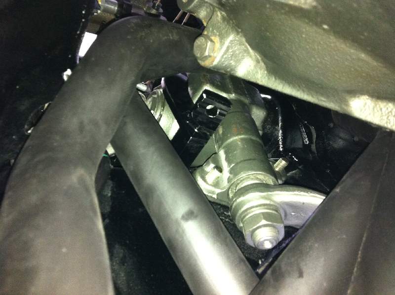

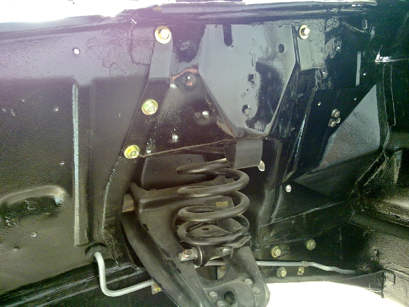

front springs are in now:

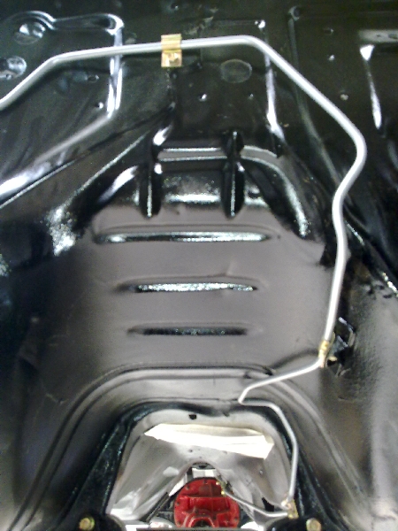

cleaned up the tank vent line - looks pretty good with all the zinc plated parts:

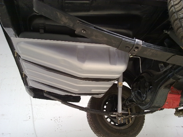

gas tank is also in place:

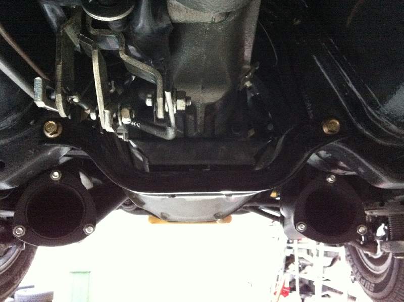

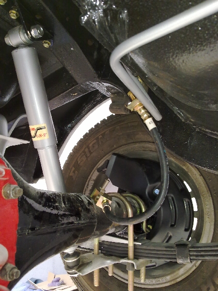

rear brake hose and more parts from the versailles brake, the dust shields are in:

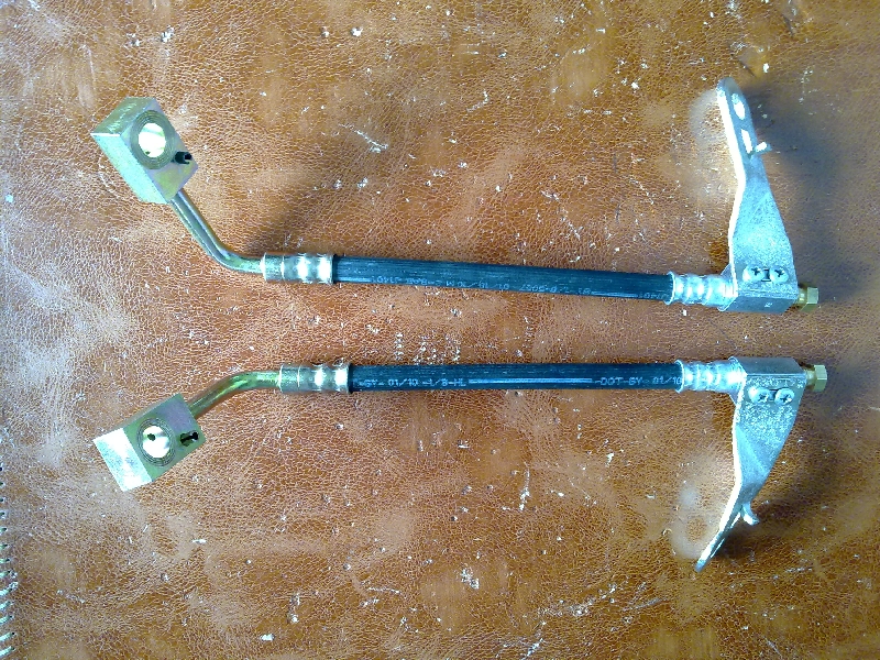

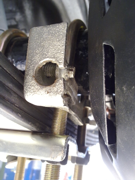

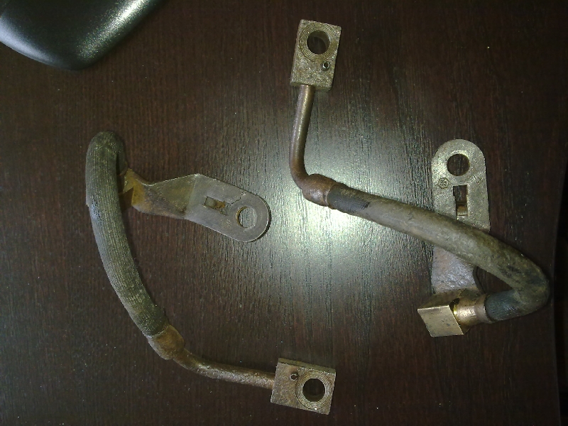

talking of the versailles rear brake - the hoses are out of production, and i was stuck with this:

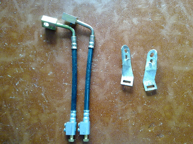

luckily i found a seller on ebay - brake hoses unlimited - who will build you any brake hose you want. but beware - the rear brake hose bracket is unique and you will need to reuse it. so i cut it off, opened up the mounting hole a little and had them zinc plated. here they are together with the new hoses:
the fittings are not pressed but screwed in - looks fantastic!

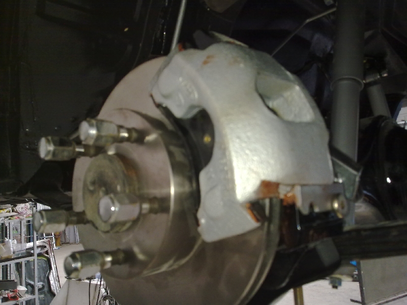

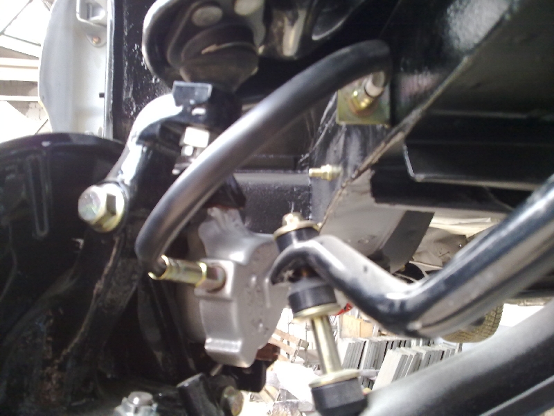

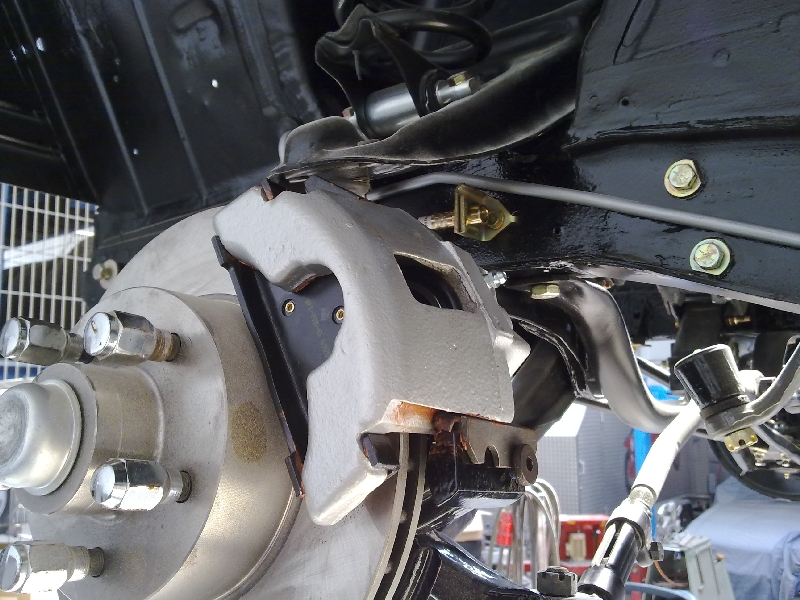

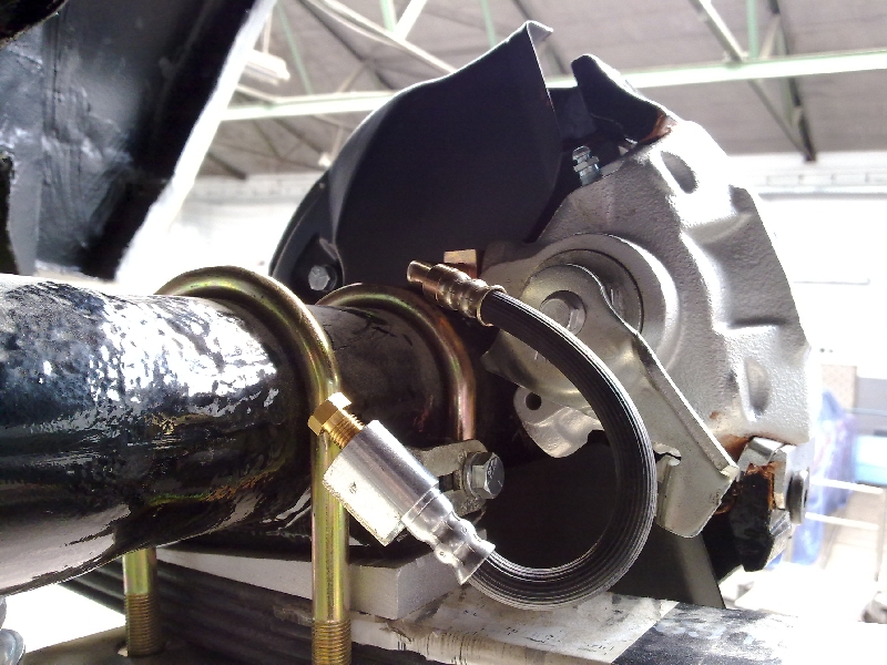

spent a couple of hours on the brakes today. calipers are mounted:

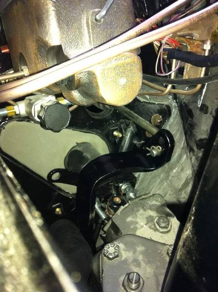

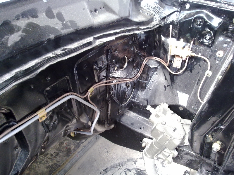

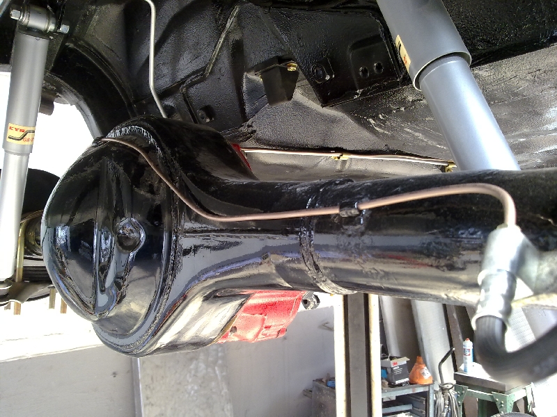

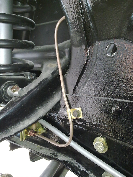

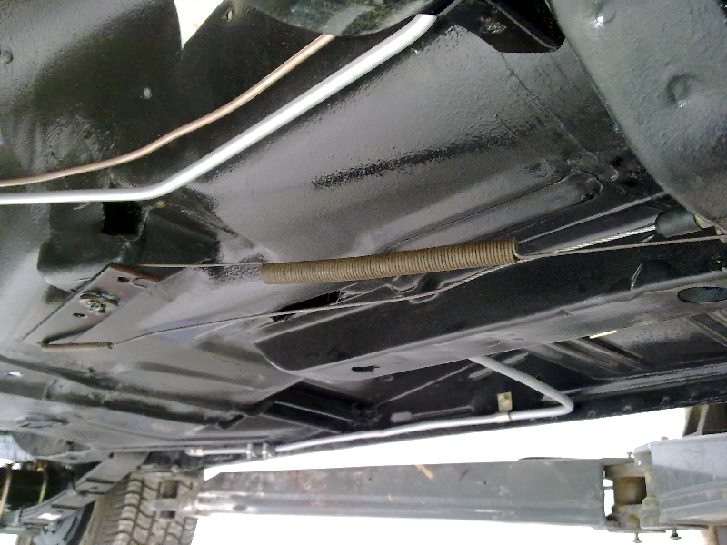

and today i was able to bend and flare the brake lines. i used a really good flaring tool which made the job pretty easy. this is what i used for the brake lines, pretty good stuff and easy to bend: http://www.cunifer.com/
i'm not completely done yet. i need to fab a bracket for an adjustable prop valve and also i need some more fittings...
but i installed the versailles parking brake brackets, which i got from mean_maverick:
more to come next weekend!

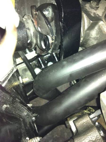

the brakes are still keeping me busy...

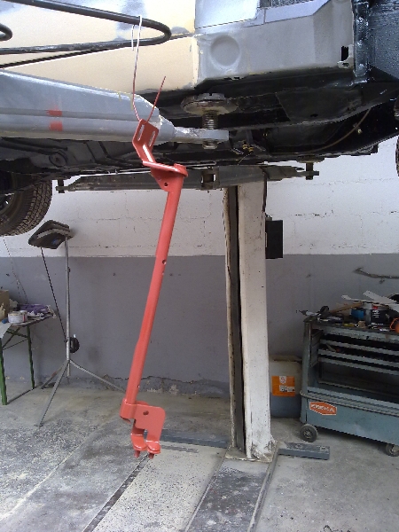

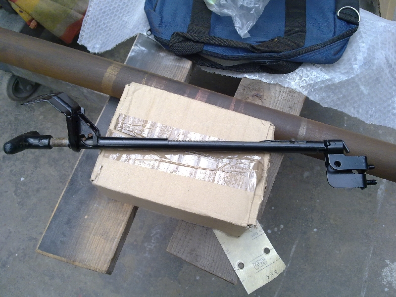

put the front parking brake cable back in:
i also cleaned and repainted the handle:

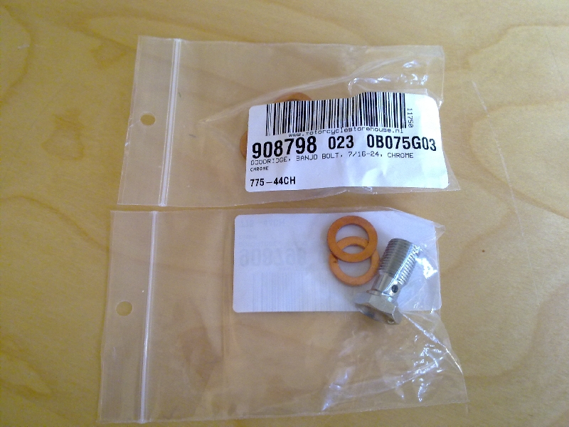

the previous owner screwed up the versailles brakes big time. he used the wrong sized banjo bolts on the calipers. i have new calipers, but still had to find new banjo bolts. they have an odd sized thread, 7/16-24, opposed to the 7/16-20 UNF. but i got lucky at a harley shop:

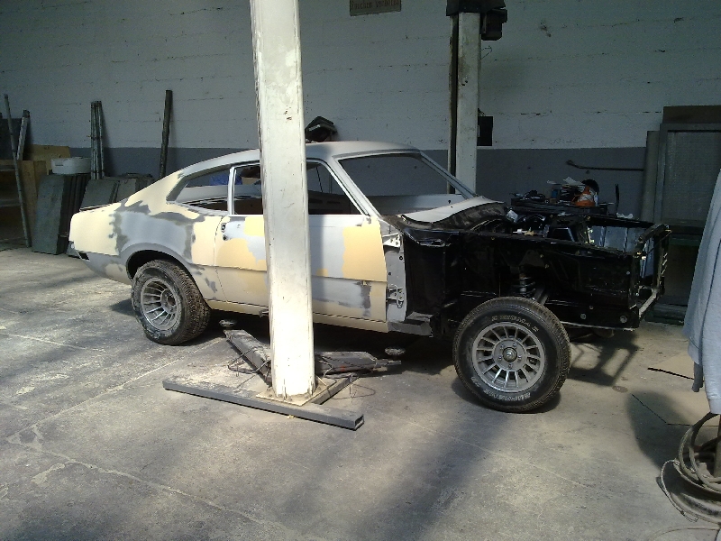

oh, and i have a rolling chassis now

Hey Tody, Do you know this Maverick? this guy (German) worked in Brazil for 2 years bought this car, loved it and shipped it to Germany His name is Florian and he lives in Ingolstadt is that near you?
