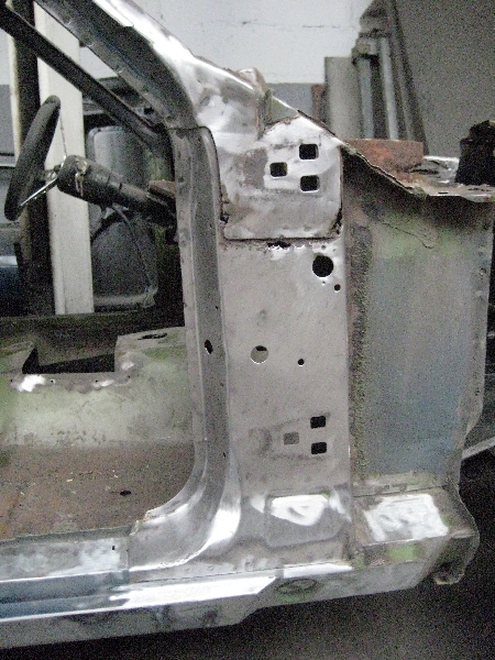

yesterday's work included stripping the engine bay (still not finished, way too many small corners) and the a-pillars where the doors are mounted. i also cleaned up the radiator support. found lots of corners which need fixing...
http://www.72comet.de/gt/index.php?id=31

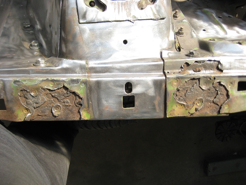

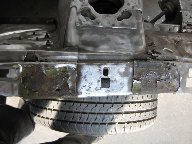

i found quite a few threads with lots of helpful pictures. what i don't understand is why the fenders are intact even though the apron below is completely rusted...

yeah a pretty common rust spot. my theory is the spot welding caused a change in the metal that encourages electrical current to flow in paths allowing\encouraging faster oxidation. i have seen this on other types of vehicle in other locations as well... just a nutty theory though....

I just wonder whether or not this would have been avoided if there would have been seam sealer applied to top and bottom of these seams from the factory. The area looks like it would wick in water pretty easy from top and bottom. - Matt
