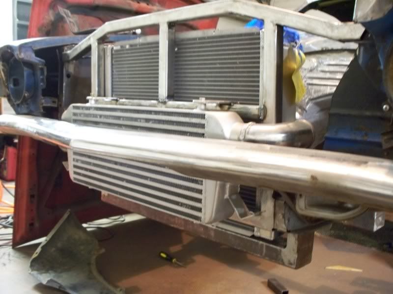

Progress has been slow with house renovations going on before the baby gets here. Got the inner fender panels made. Just got a new sheet of steel to make the recessed firewall. Im fabbing up the engine and tranny mounts this week. Will be taking the PCM next week to the performance shop to get the anti-theft taken off as well as the EGR, and rear 02's. Progress just slow progress. Just a pic for those who havent seen it.
