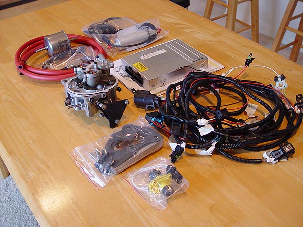

Also the Chevy TBI really does not care what distributor you use, all it is for the most part is just an electronic carburetor.
This is the howell TBI kit for an AMC V8 it shows everything that you would need to make a TBI unit run some of it you would not need if you were leaving it in the truck. Those motors also used a duraspark distributor. So unless you have a EFI distributor you should be fine to run the current one you have.
http://www.howellefi.com/customer/pr...cat=280&page=1
