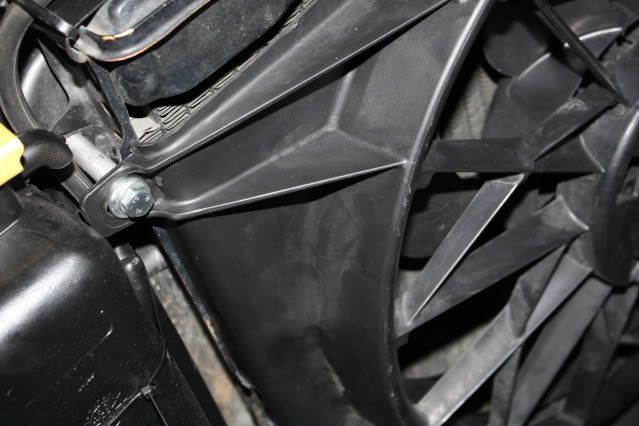

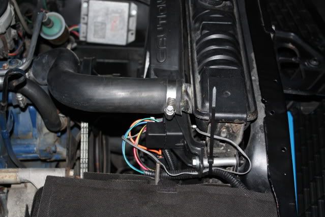

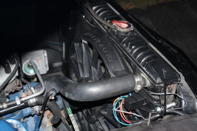

    Well the boss called in sick today and we are open 8am-9pm so I came home before dinner and picked up the Mav. Took her back to work with the electric fan and hardware in the trunk. Worked on it from 6-8:30 and shes all done and running. It fit and works better than I expected.
    Fan is out of a 06 Jeep Liberty. Perfect width and height for the stock rad. Took some trimming with the cut off wheel that I did a while back as a rough fit. Finished a bit of trimming and made the mounts. Just had to open up the factory holes on the fan to line up with the factory rad. Used some AC aluminum line for the mounts. It lined up great with the rad. Just added 4 speed clips to the factory rad holes and used the bits off AC tube as spacers. The controller is from Carquest. Fully adjustable with a fin sensor. The adjustment is very accurate. I have it set to come on at 198 and at idle it drops down to 187 and turns off in about 45 seconds.
    Current draw is about 21 amps with a very quick on spike up to about 41 on start up. The start up spike is about half a second if that, so it doesnt bother the 30 amp in line fuse. The alternator seems to keep up with the draw fairly well. With the headlights and blower on the voltage drops to around 12.6 at idle when the fan comes on. Not bad but it will get the alternator upgrade eventually when I stumble upon one. Also want to install the serp. belt and pulleys at the same time.
    I may turn up the on temp a few degrees. I have an LED to install in line so I know when the fan comes on while driving. I think it will help me tune the fan a bit.

    Heres a few quick pics. Still have to clean it up a bit but i can do that here at home. Going to paint that shiny hardware black and tidy the wiring at the controller a bit with loom.

    Pics added.
