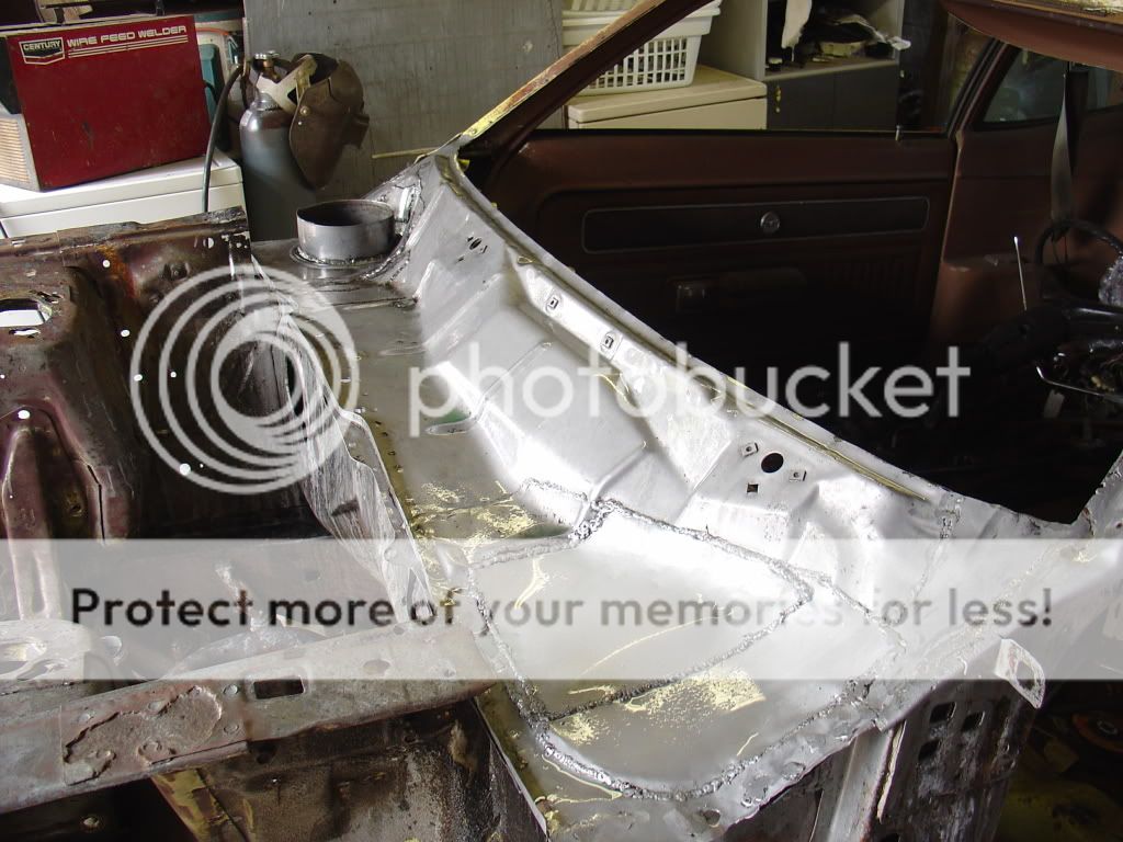

  7. 71gold
    2,935
    or...cut the top
    repair the cowl
    seal it back up
    ...Frank...

  8. mojo
    5,274
    833
    Hey Frank! Im curious looking at the pix. I can't quite figure out the 2&3 pix's. In the 1st. it looks like u did'nt remove the entire cowl - just cut out a major part of it. In the last pic it's hard to tell w/ the flat blk fininsh - It looks like the entire cowl maybe gone. Just interested for heads-up on my possible repair. How did u seal the vent tubes not being able to get to the outside edges?
    Just looked agn -Figured it out.
    1.) How are they closing the hole? Welding in orig slotted panel or sealing it completely?
    2.) Welding it in or using some kind of adhesive?
  9. mojo
    5,274
    833
    Did u seal the cowl up or weld orig pieces back?
  10. 71gold
    2,935
    maybe these will help...
    they are glued in with this...panel adhesive.
    ...and Effie making it look like it didn't happen...:yup:
    [​IMG] 100_0044.JPG (28.0 KB)
  11. mojo
    5,274
    833
    Thanks! I see it better now. I like the way they/u did it, leaving a strip in the center. I appears u just sealed all air intake openings, A/C and cowl. I assume u will be using the AC w/ inside air only - other than opening a window? NICE.
    I see the adhesive is the only way I'd like to do mine. I don't like welding things
    I can't put some kind of paint on outer surfaces; whether a weld thru primer is used or not.
    THANKS FOR INFO.

    Welded the original pieces back in.

    Yeah, I lucked out and didn't really need to repair any holes. The cowl's water exit hole was partially clogged allowing water to overflow the chimney during a hard rain. Just had surface rust that I wire brushed and POR-15ed. Attached a paint stir stick to a brush handle and was able to POR-15 almost to the opposite side.
