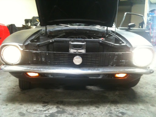

    heres the drives side changed to the silver star bulb with stock wireing.

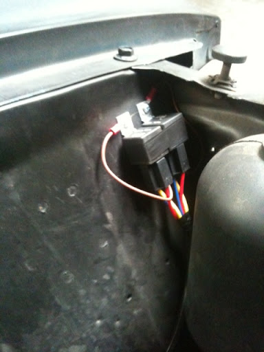

    next i installed the relays.

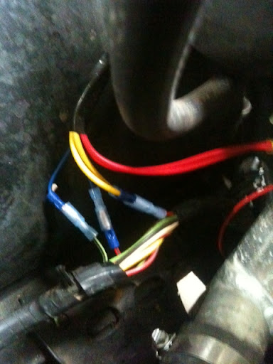

    i cut off the tape that went around the wireing loom right before it goes through the radiator support and found the two wires that power the head lights. one is red with a black tracer the other is green with a black tracer.

    heres the relays installed on the inner fender.
    heres the relay wires tapped into the harness.

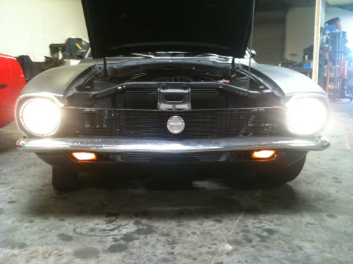

    and here are the lights with the relay power. its still old bulb on passenger side and a silver star on the drivers.
    you can see with the relay upgrade that the silver star bulb really is alot brighter. i havent driven it at night yet. when i do ill up date the thread on the improvement.

    big difference...they looked yellow in the first pic...:thumbs2:
