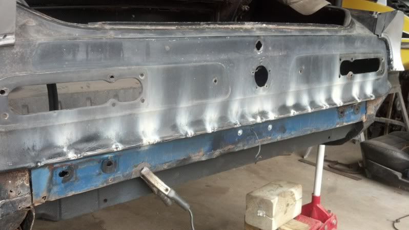

There are 2 places to patch on the donor floor before its put in....its the same on the other side...
my little patch........
the patch welded in and sprayed with anti rust coating....I must practice welding sheetmetal...lots of welding left........

Quote:
Originally Posted by Blown76Mav View Post
Did ya cut the rust out or just patch over it?
cut out the rusty stuff.....I left enough metal to do a lap joint.....placed and welded in a piece from behind(not shown)...........ended up with two layers again......its strong........still learning about metal patching.....
