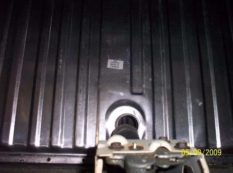

The first pic here shows the approx. difference in the size of a Mustang tank in a 1970 Maverick (71 up trunk floor is different). The Mustang tank is wider and not as long. The second pic shows the cut I plan to make. Once removed, I'll trim several inches off, move it over and reweld it in. I'm gonna overlap the sheet metal and spot weld it with a mig sort of like how body panels are welded together from the factory. THen seal it and shoot it with splatter paint.
Then I'll have to make 2 smaller filler panels on my metal break to fill the gaps. One last panel will have to be made to fill the gap between the tank and floor towards the back seat. I don't have a bead roller so I'm trying to find someone ro roll a few areas in that panel. When it's done I'm gonna make a vinyl cover to go over the tank area so hopefully it will have a stock appearance.
The downside to this mod is that widening the trunk floor on the passenger side will eliminate room for a rear mounted muffler so you'll have to use an under floor muffler.

Another thing to keep in mind is the location of the filler pipe. You may not be able to shift the Mustang tank to the right like that and may need to take some out of each side.

Actually if you offset it to the right, the inlet is nearly aligned with the filler neck.

Those aren't pics of my car, they're another members car. Mine's nicer! lol
But I've already got a new Mustang tank and I never want to face the whoas of hard to find 70 gas tanks again.
