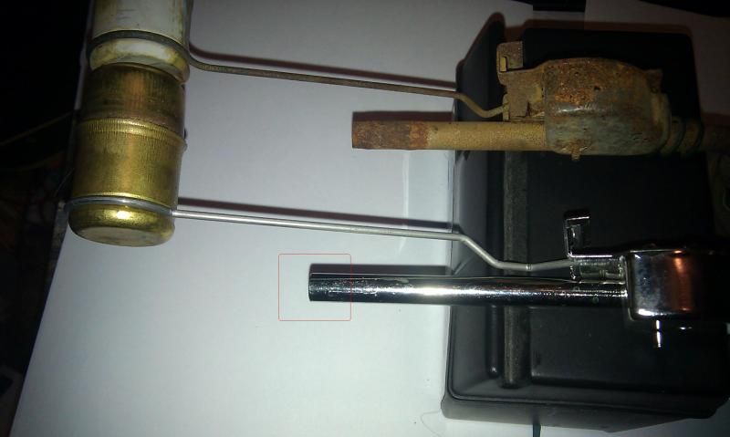

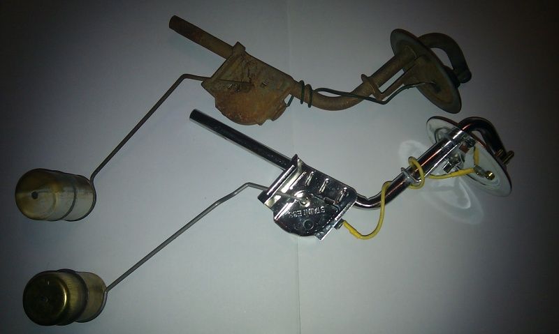

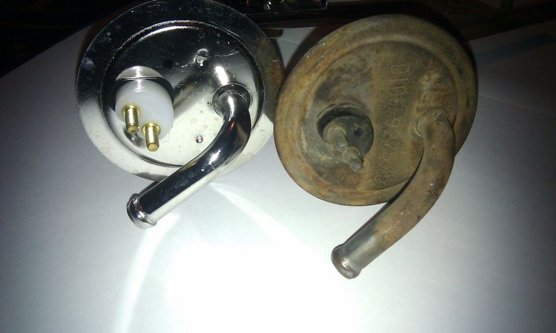

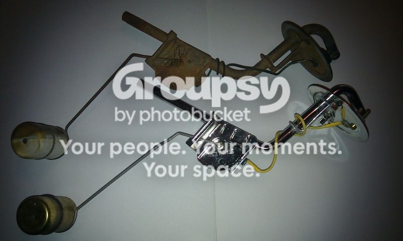

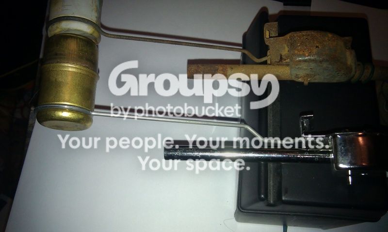

    picket up a repo 71-73 mustang fuel sending unit at the spring columbus swap meet in hopes it would be close to the original maverick unit.
    float travel is the same
    wire connecter is the same
    mustang unit is about 3/8 inch longer
    i will test fit today to check for interference with the bottom of the tank. if need be i will cut it to the correct length.

    The 70 Maverick unit is nearly identical to the 65-68 Mustang unit with the exception of the pickup tube length as well. I recently picked up a Ron Morris reproduction with the EFI return line provision and will modify it for my application.

    had to trim 3/8" off then it fit like the old one.

    When you compare them side to side, is the Mustang arm longer? If it is, that'll screw up the reading for sure.

    I just bought a 71-73 mustang sending unit there a few differences float arm is about A inch and a half long and the over all the pickup tube is longer.

    the sock runs parallel to the bottom of the tank, the 3/8" should not have been a problem...wasn't for mine.

    it was hitting the bottom of the tank.

    My mustang unit fit just fine but I have a later 16 gal tank. I just had to bend the float arm a little so it wasn't hitting the tank at empty or full.

    yes it fit but i had to trim 3/8 inch off the end of mine.
    been working fine for about 6 months now
