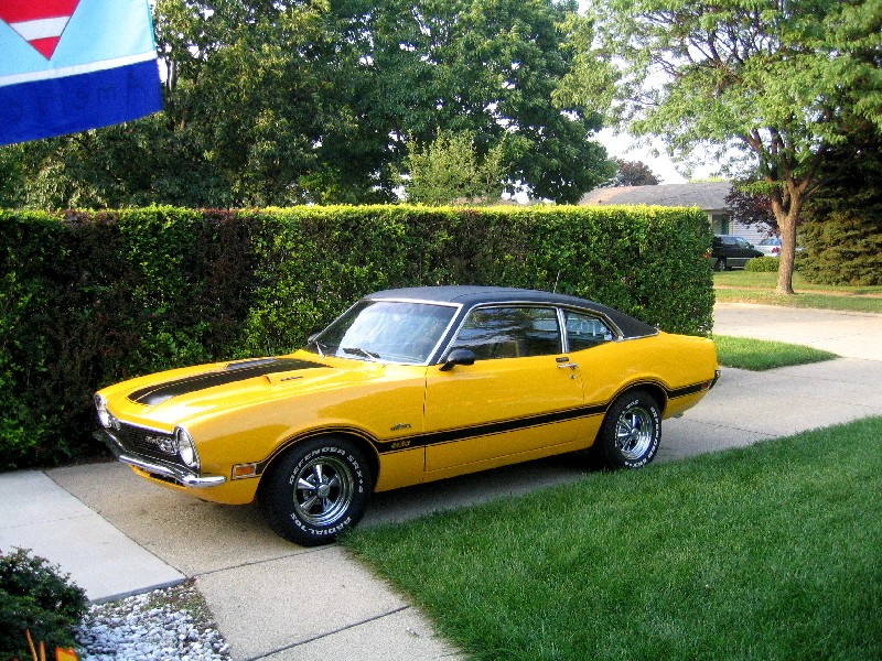

    Although my mirrors are not factory (from an early 80's Mazda), I had them mounted further forward so they would actually be useful when sitting in a normal position in the driver's seat. It's been almost 9 years so I don't remember all the details of how they are mounted insided the door, and it probably wouldn't help you anyway. :)
    I only have one picture handy, but it might help you get sort of an idea of what factory sport mirrors will look like moved forward:
  7. wardf
    wardf Ward Frahler
    1,964
    Elizabethtown, Ky.
    70 maverick
    OK Mark, I like those mirrors and the position, what are they off of? Model, and year?
  8. MavMark
    MavMark Mega Modifier
    779
    Detroit Area, Michigan
    I believe these particular mirrors are from a 1982 Mazda RX-7, and that this style was used from 82-84, although I could be off by a year or two...I don't really know much about Mazdas. :)
    They originally had bases on them that didn't quite work. Dale Doll figured out that removing 'em would make the mounting possible when I had Jean and Dale do the body work and paint for me back around 2003 or so.

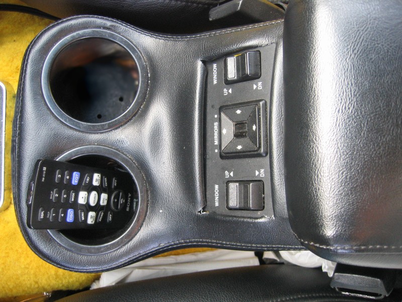

    I liked these mirrors because they looked so much like the factory sport mirrors, they are both electric and the control pad is exactly like one used on many Lincolns, so I could use mirror and power window controls I found in the junkyard (mounted in an aftermarket armrest):
