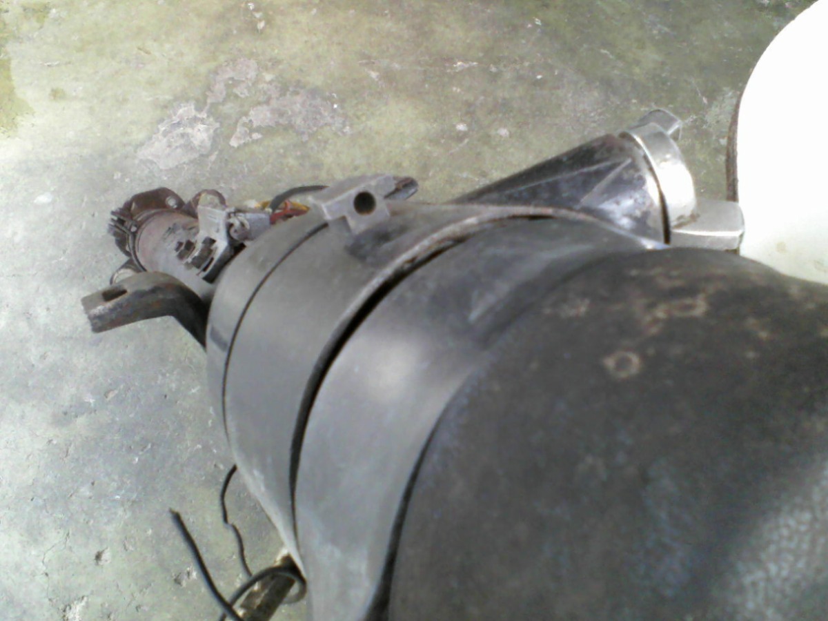

    Also, my steering column obviously doesn't have the mouting provisions for the tach. I'll have to fab something myself.

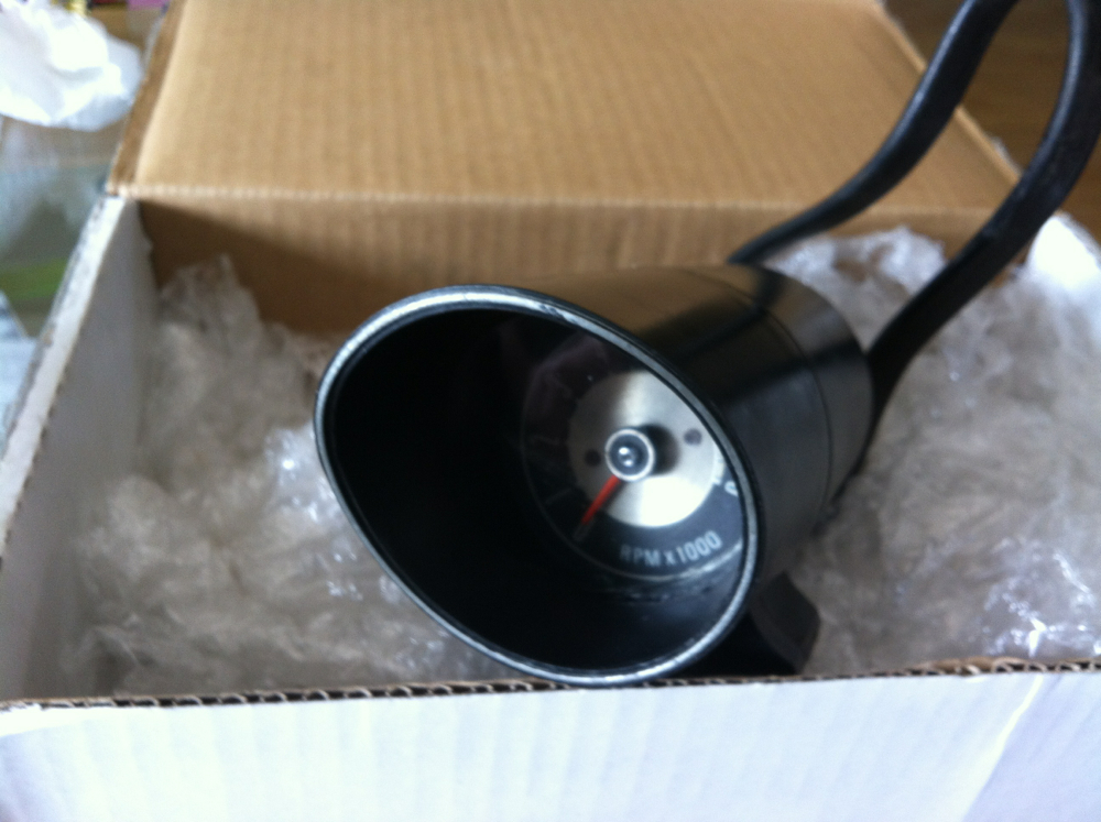

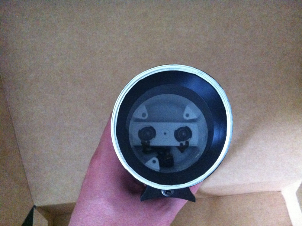

    Here's how the unit arrived:

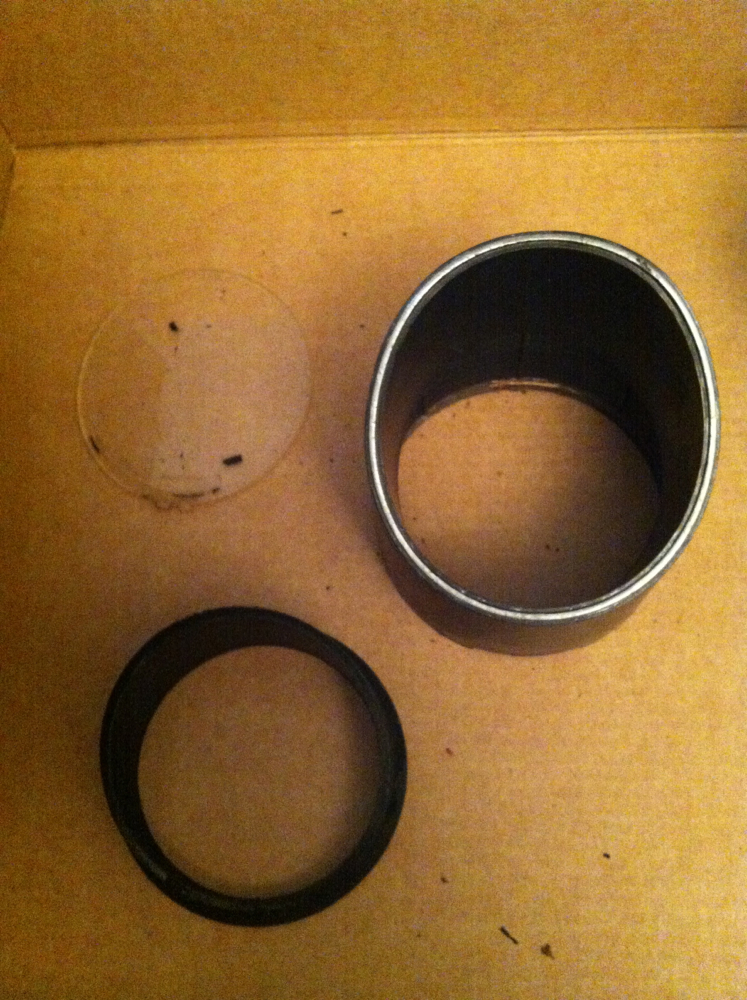

    Top part with the glass comes off easily:
    It can be taken apart further, now the glass is out:

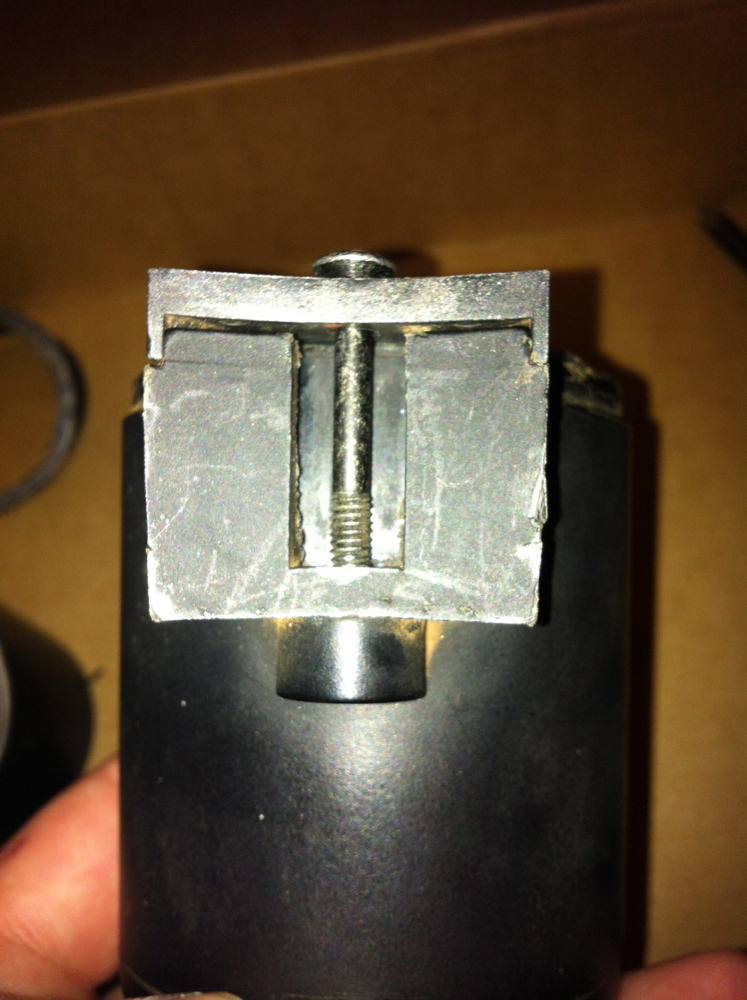

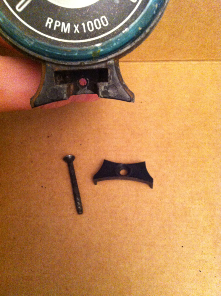

    Two pictures of how it mounts to the column:

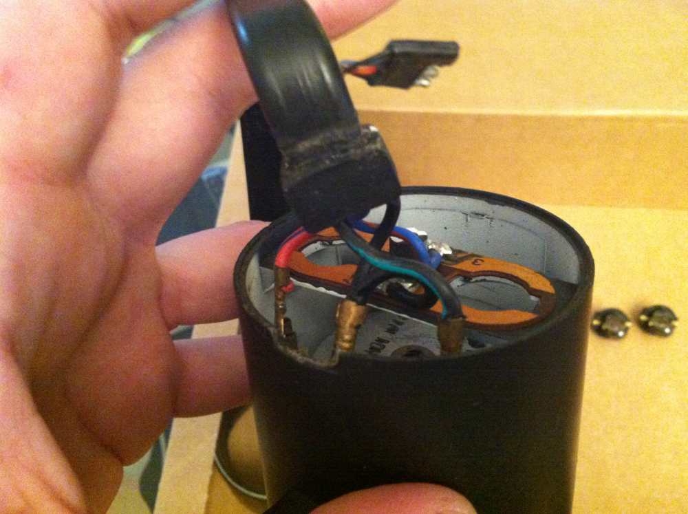

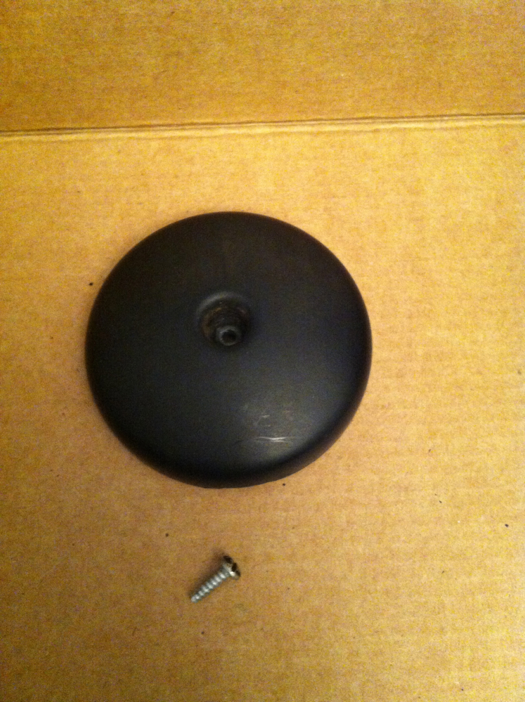

    Back plate can be unscrewed:

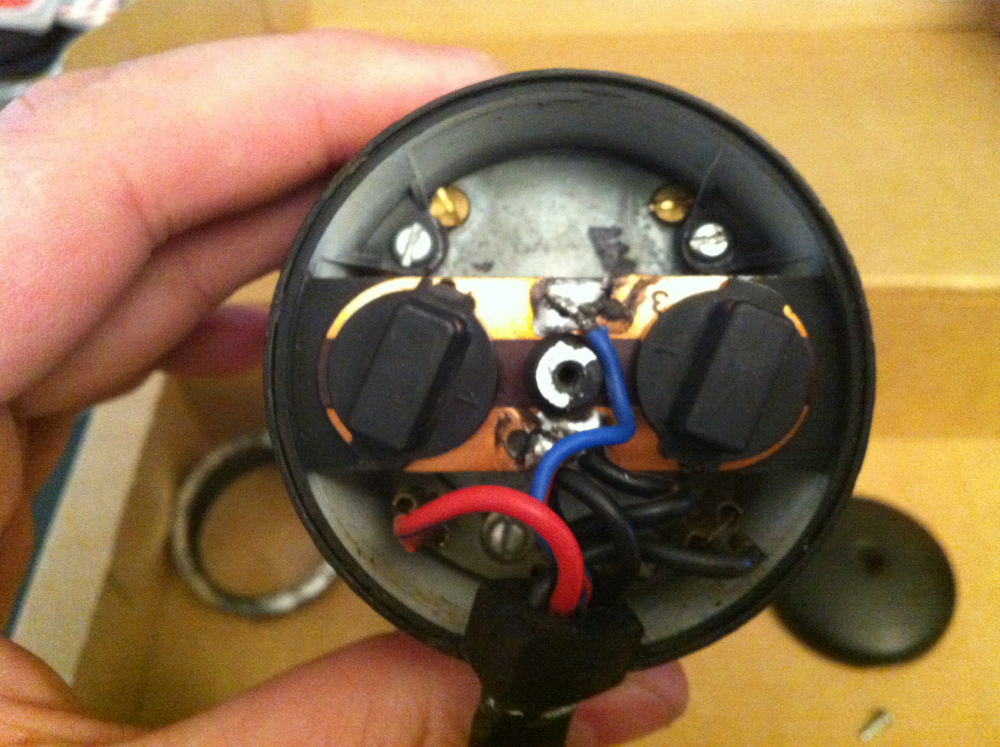

    Back view without cover:

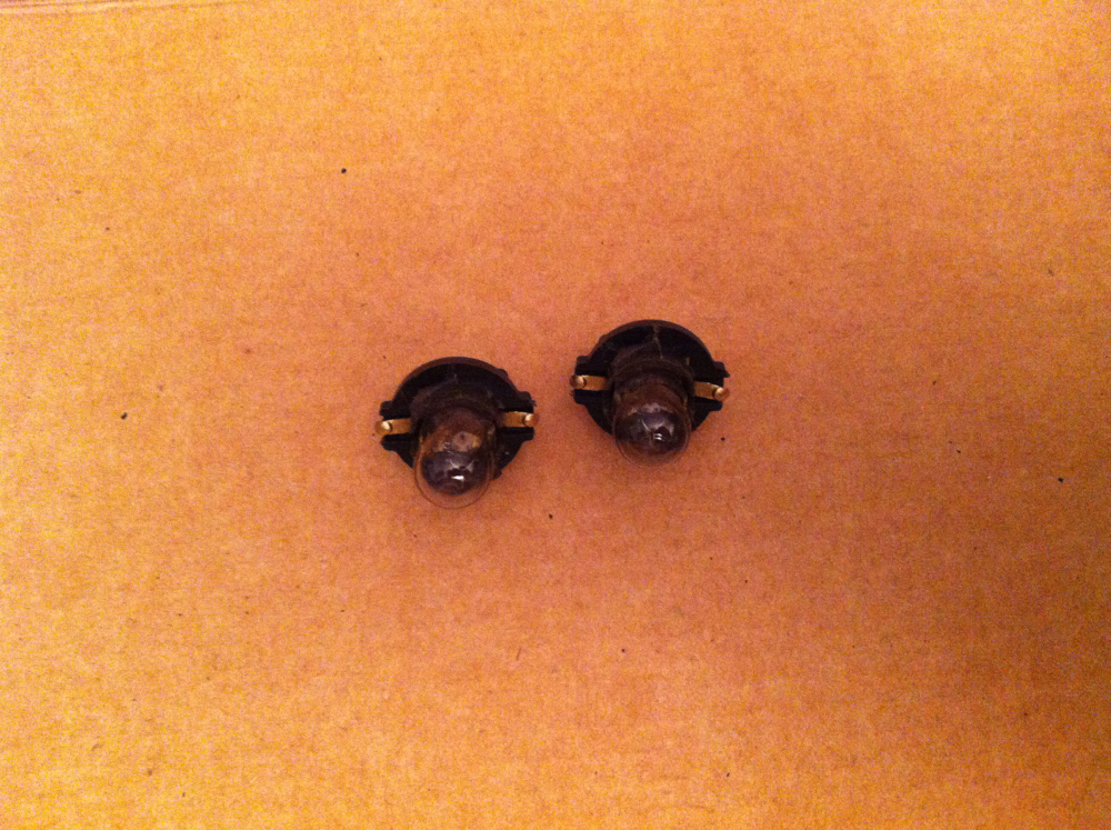

    Two w5w bulbs:
    4 Wires, I believe 12v, ground, light and signal:

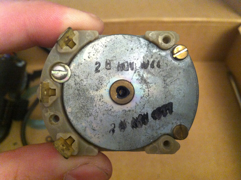

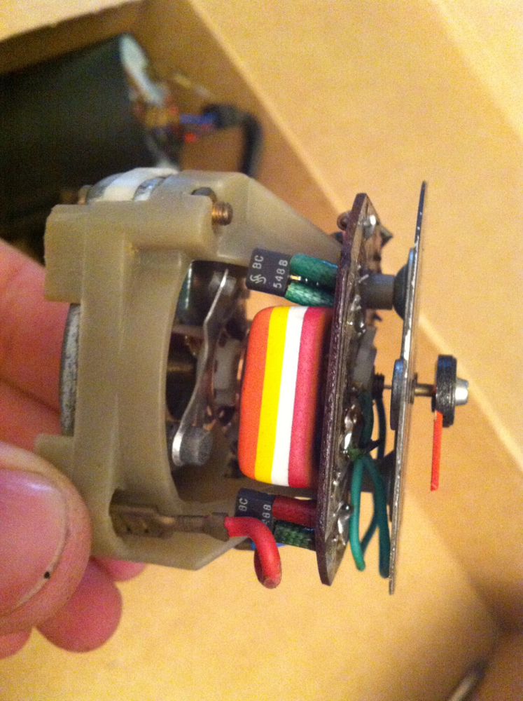

    Unit itself is screwed in with small gaskets in between:
    Back view of the unit, as well as all 4 sides:

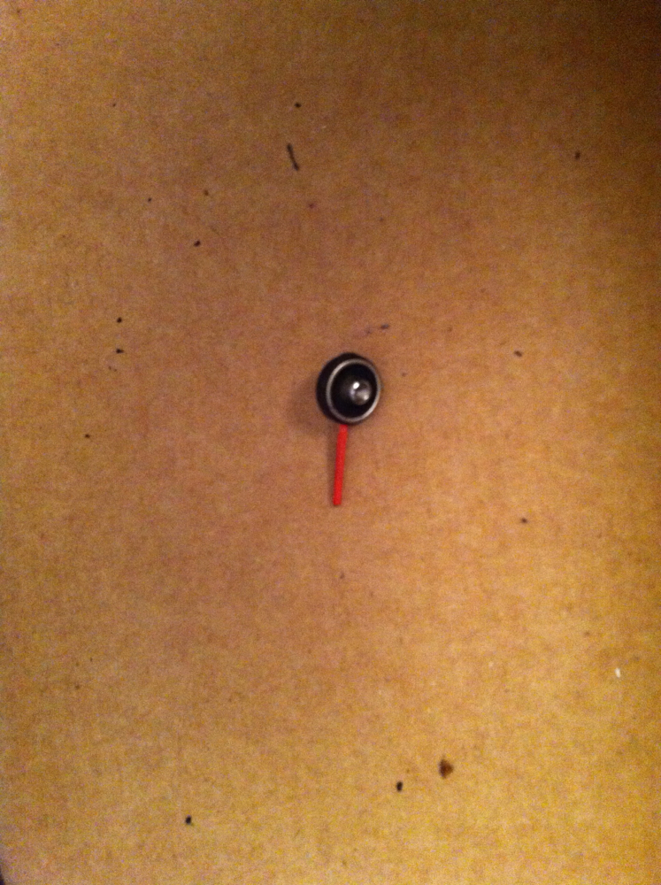

    Pointer pried off:

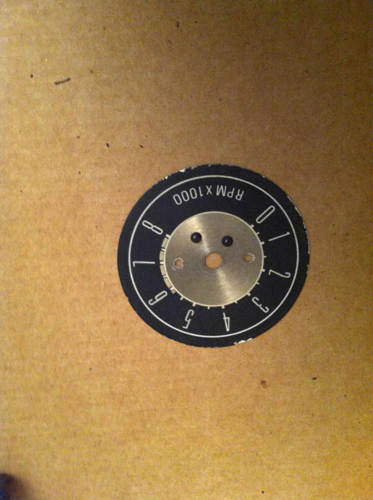

    Face plate mounted with two tiny screws:
    Unit without faceplate:

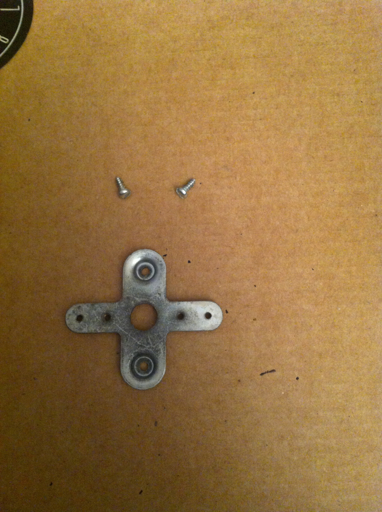

    Mounting cross removed:

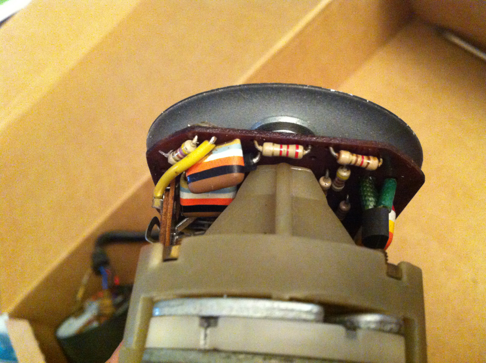

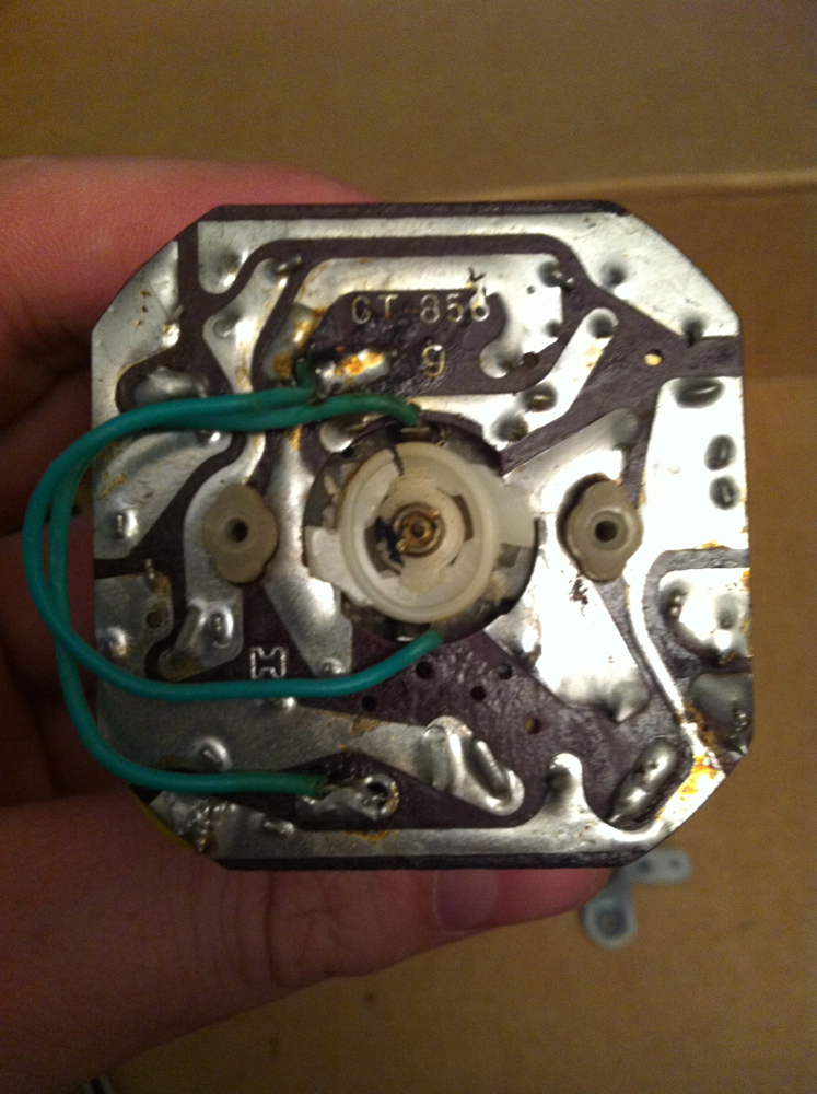

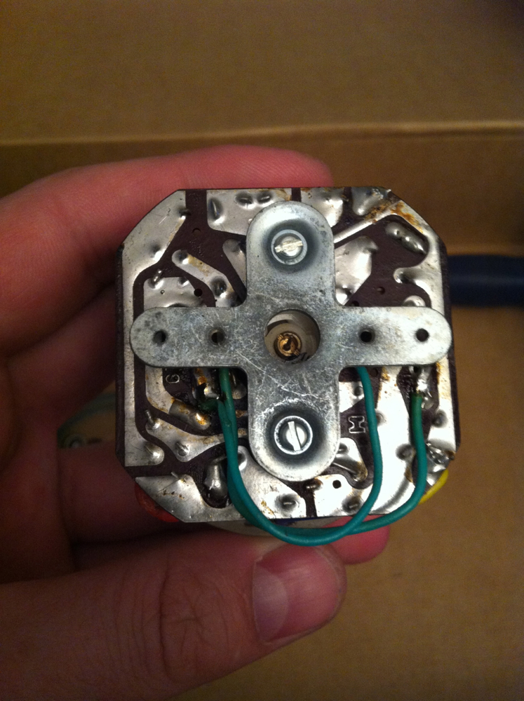

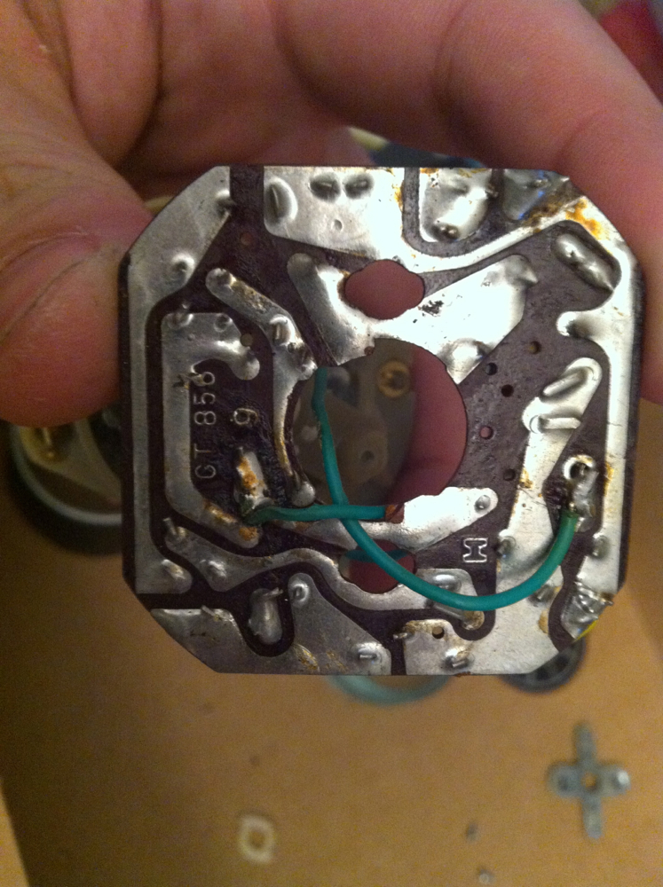

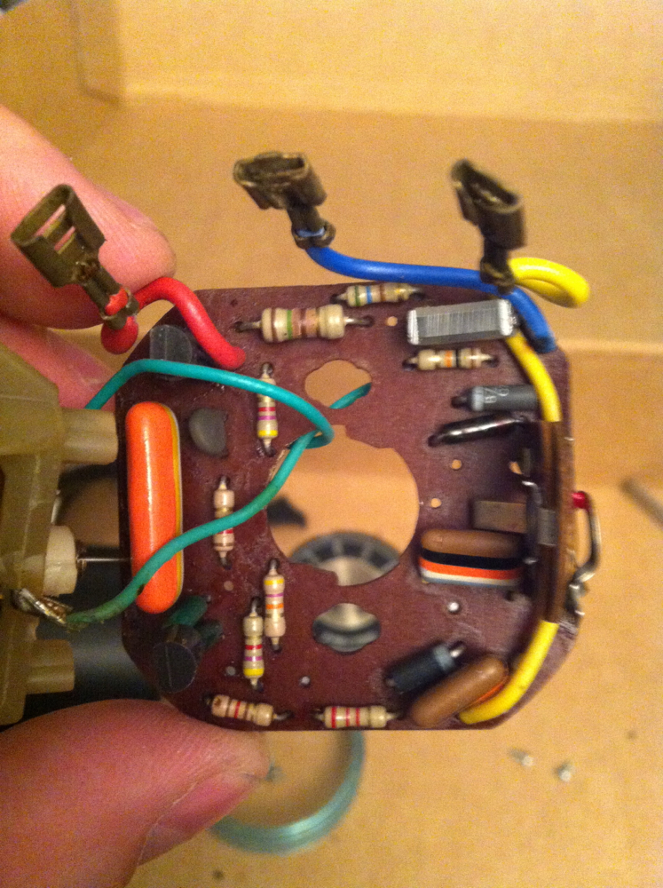

    Circuit board held on with a plastic retainer:

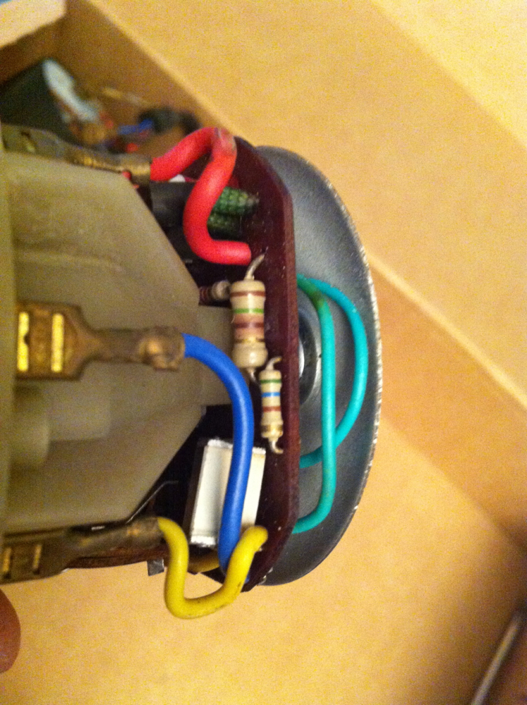

    Circuit board from both sides:
    So let's see what there is to do.

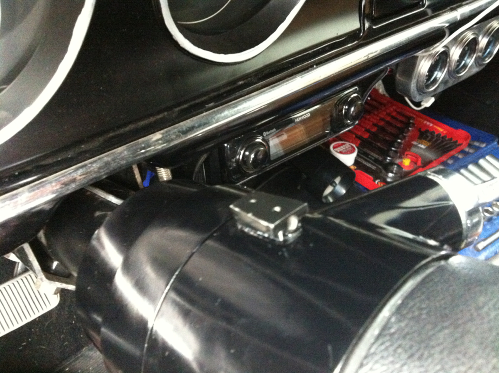

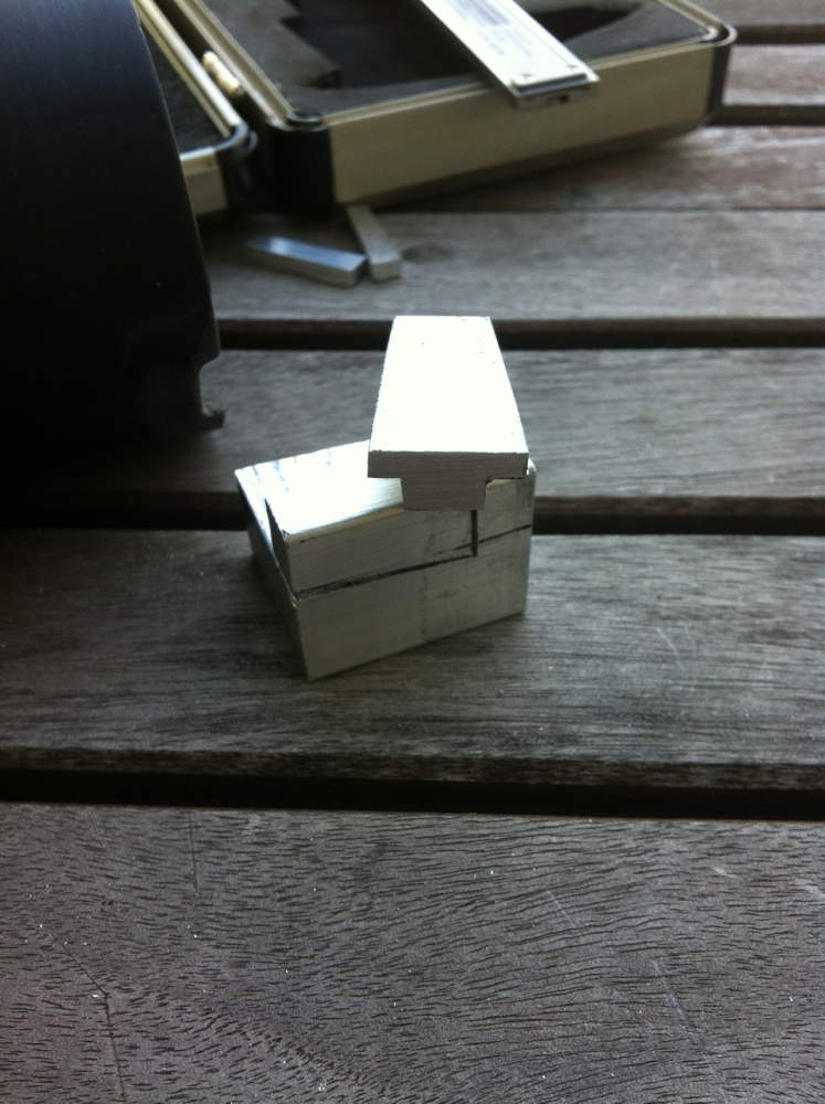

    I'll have to fab a mount which will make the top of the column look like this, likely i'll cut it out of aluminum:

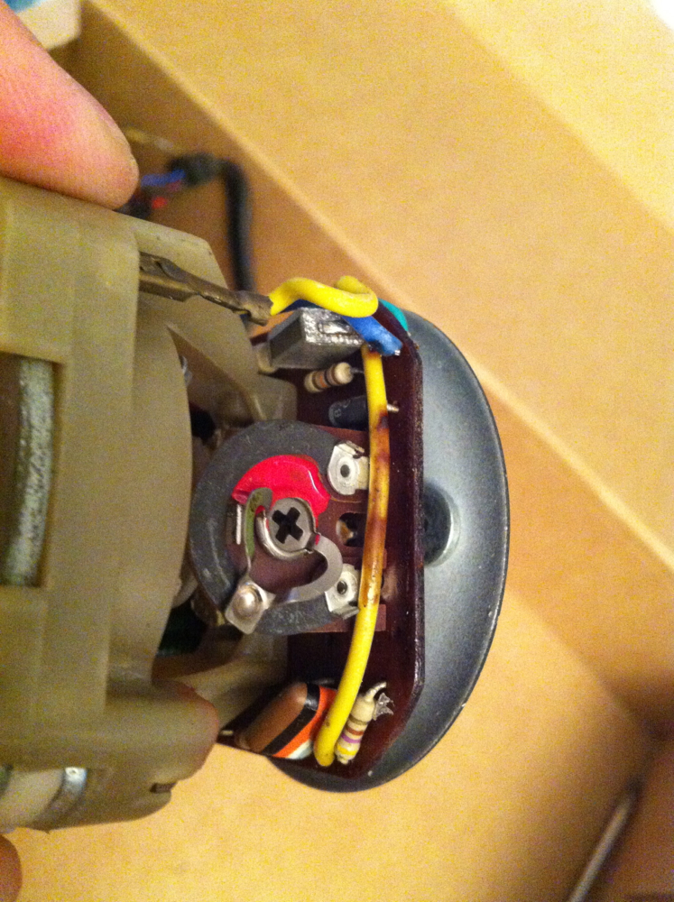

    And now for the delicate problem of calibrating the tach. In the pictures above you can see some sort of poti with the screw secured in place by some enamel. would ford have gone through the trouble of designing two units? Or is it adjustable? That would a giant leap forward.
    Otherwise, I'd have to call some friends for help who can actually read these circuit boards. Maybe they can rewire it or change some resistors to amke it work.

    The potentiometer is there for calibrating the tach. Slap it all back together hook it up without the housing, hook up a secondary tach, turn the pot until the two tachs match up.
    It should be that simple, but I'd need a cleaner shot of the circuit to be certain.

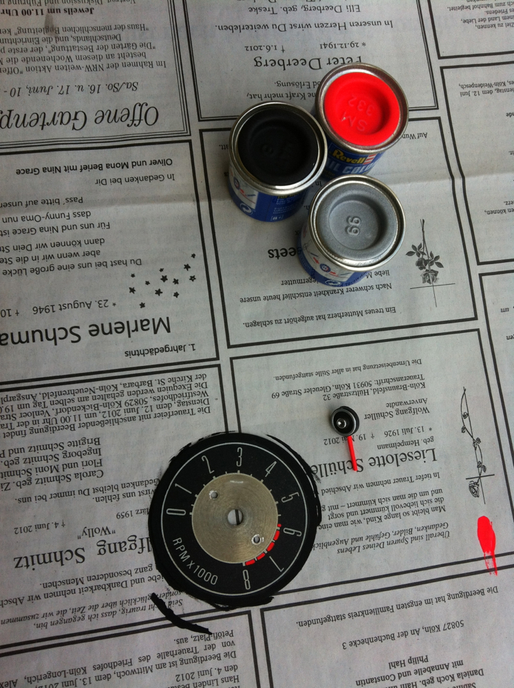

    started by polishing the two plastic pieces:

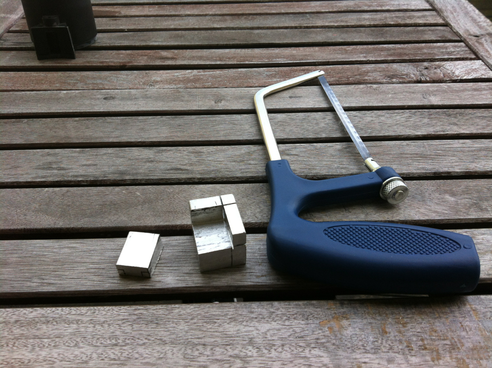

    i started on fixing the tach today.

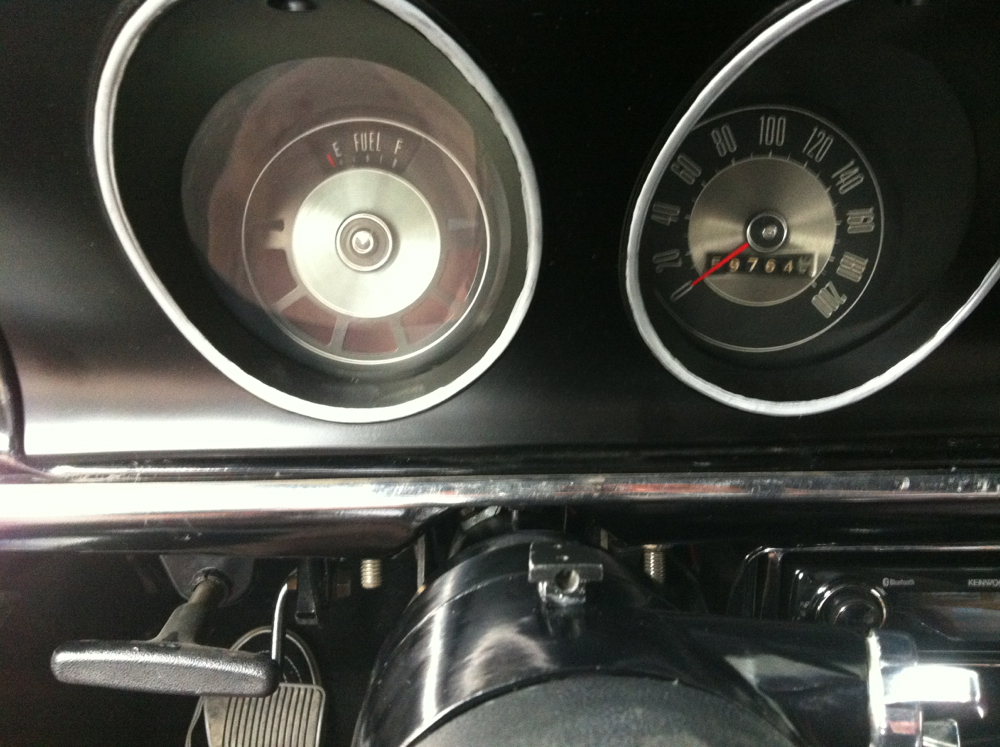

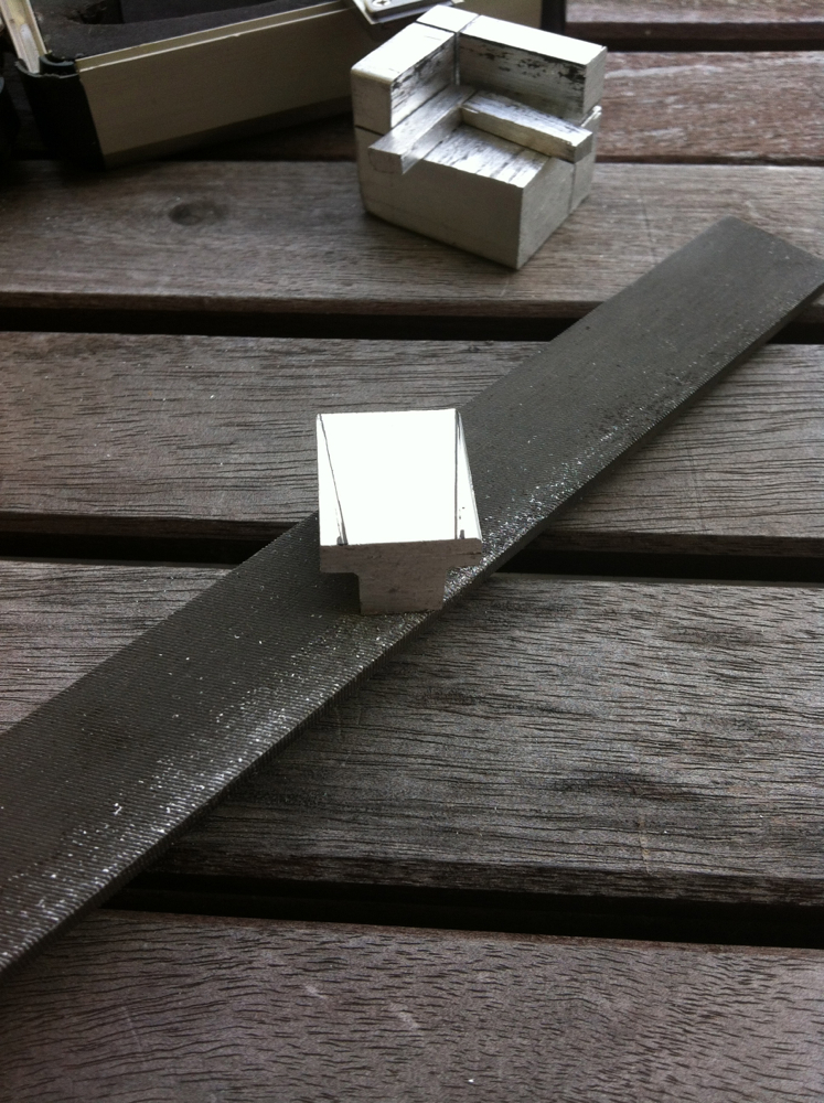

    as the steering column is missing the bracket to mount the tach, i fabbed something out of aluminum:
    i guess i'll either use glue or two tiny screws to mount the bracket.
    after that, i touched up the face plate and the dial a little:
    the housing is next, it's already sanded. i guess i'll take apart my dash cluster again to match colours.

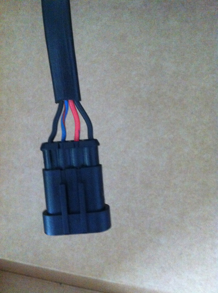

    cologne, germany

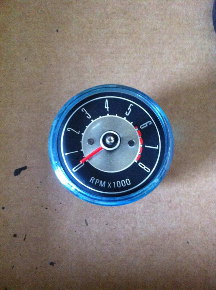

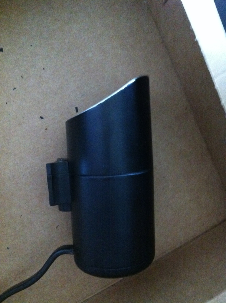

    here's what the tach unit looks with the faceplate and lens:
    the empty housing painted and with a new plug:

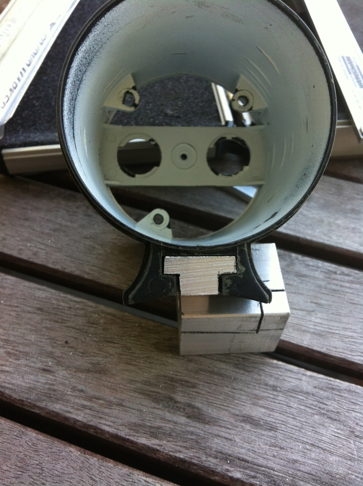

    cologne, germany
    the mounting bracket glued in place:

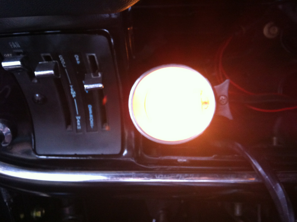

    cologne, germany
    quick electrical check - illumination works. let's hope i figure out 12v switched and signal:
