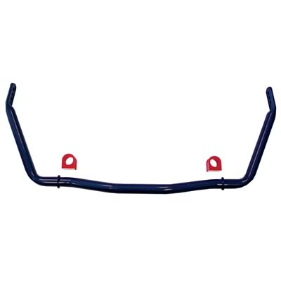

What do you mean by "make a custom one"? I believe they are simply taking the bend pattern they have for the 7/8 and putting a 1-1/8 bar in the machine instead. Not sure how they plan to accomplish the adjustment holes as I believe these to be solid bars. I have asked before about truely bending a custom shape. They said they could do it if I sent them a pattern. I've since worked out my issues and can make the stock pattern work again.

I have to admit that I am not sure if this is something I need. I'm concerned that Addco's own website states that going too big can cause a problem. To keep everything in sync, it seems that if the front is upgraded the back needs to be also. You have a non-stock rear. Has Addco indicated that there is no problem to run the thicker front bar with their standard rear on our stock rear suspension? Just dont want to see the rear step out because of an imbalance.

I don't know how that would be able to reach the lower arms without the necessary bend to get the links mated up.
And the bending of the bars isn't the bigger challange.. it's the proper tempering and stiffening of the steel without becoming brittle afterwards to really make it worthy for long term use in such a torsionally stressed environment.

That would be my concern as well. Not so much the how as I would assume they will heat and smash the end flat as is typical.
Adding holes to shorten or lengthen the end link connection points on the bar to reduce/increase leverage for the sake of reducing/increasing rated stiffness would stress the bolts/end links when off center from the suspensions normal plane of travel, right?
In which case we may as well just use the early Mustang bars since they are too long on the ends as well from what pic's I've seen. I've also thought of just modding one of those 65/66 bars since it would be fairly easy to chop a bit of length and just have them flattened once more for a place to drill the new hole which the end link can mate up to.
Which would likely make them even stiffer as they leverage was reduced. Would ruin the temper at the ends.. but they probably wouldn't break in that location anyways? Wouldn't want to test that theory at higher speeds on a big sweeping corner though. lol
