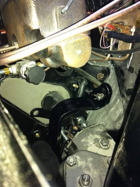

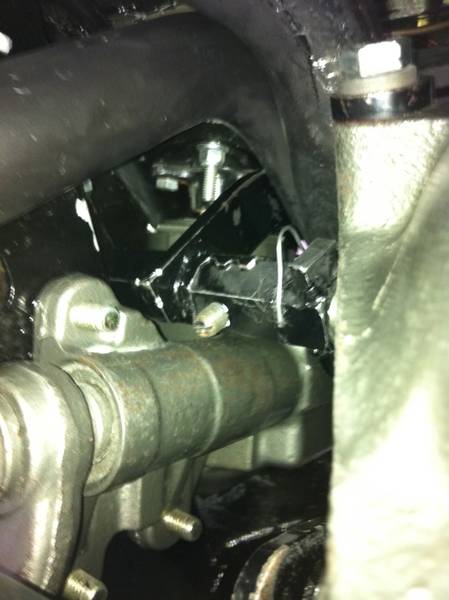

  10. tody
    tody Member
    Apr 12, 2008
    1,837
    218
    cologne, germany
    these are the best pictures i have:
    the lower rod isn't mounted in these pictures, but it's adjustable. i used the 69/70 mustang rod - fits perfect.
