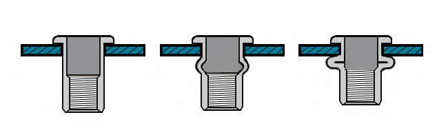

  5. predfan2001
    If you install nutserts, you will need a tool however you can improvise.
    This is the way they work.
    This is the correct tool.
    If you don't have the tool, you can use a bolt and a spacer to draw it up.
    Some of the Mustang parts places sell rubber nutserts that just swell out when tightened. I've never tried those but they seem like they might not hold that good.

  7. CaptainComet
    5,011
    452
    I seem to remember seeing individual tools sold at Ace Hardware for a reasonable price (under $10). These are set up specifically for the thread size and count and are turned by a wrench (perhaps two) to set the nutsert.
    You ought to be able to get the nutserts there too. Size one according to the screw you will use in the mirror. I suggest stainless steel screws. ;)
