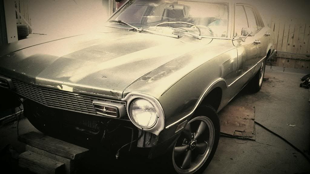

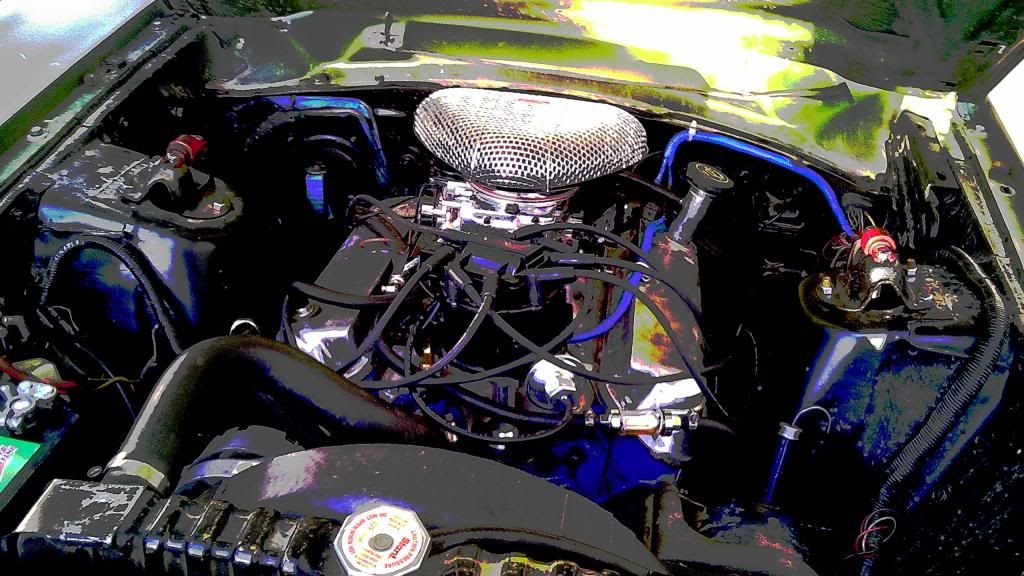

    Hello, my Names Francois Bougeant and this is my 74 maverick,
    ive owned it since I was 14, and built the engine, transmission, and rear axle.
    Its got a long ways to go, so ill be posting updates as it transforms. here are some random photos of it.
    The Engine:
    306CI V8
    ported polished 74 302 heads with 3 angle valve job milled .010
    hypereutectic pistons (.030 over stock)
    summitracing cam 280, 289 .449/.473
    Edelbrock performer rpm intake (ported)
    Summit racing 600CFM carb
    Flowtech full length headers
    edelbrock pro-flow air cleaner
    procomp pro HEI distributor.
    The engine bay as of today
    the newest part bought( marine gas filler, imported from Nova Scotia

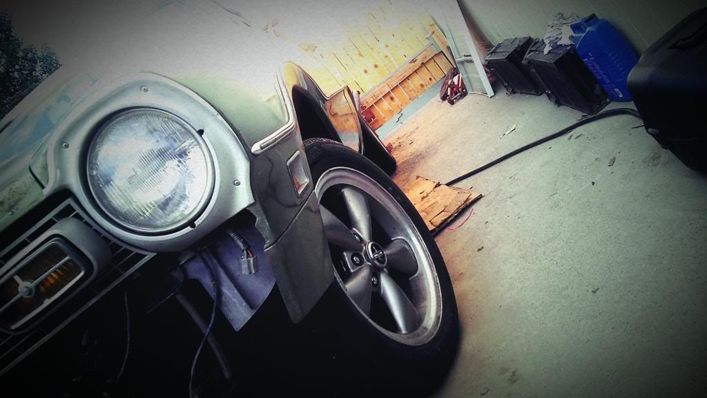

    the cars wearing 06 Mustang bullitt wheels, and 1.5' spacers to compensate
    :thumbs2:
    Upgrades to come:
    dynomax vt mufflers and full stainless x pipe
    Shelby drop kit install :drive:
    6 cylinder front springs( or lowering springs)
    fiberglass pre-73 bumpers
    fiberglass hood, and fenders
    paintjob!!! :clap:
    carburetor air plenum build.
    interior :( (the most dreaded part of this entire build)
    feel free to tell me whatcha think of this build,
    Thanks!
  2. 71gold
    nice build...:thumbs2:...but the pics. came out in some wired colors...:hmmm:

  4. newby
    newby Member
    Jul 4, 2008
    Bloomfield NM
    1974 ford maverick 4dr with 302
    The gas filler is vintage Chris craft fuel filler, can be found on eBay, its fits our filler easy, but requires fuel fill tube modifications.
    And yeah the photos are kinda fun colors sorry, I was messing with my camera ;)

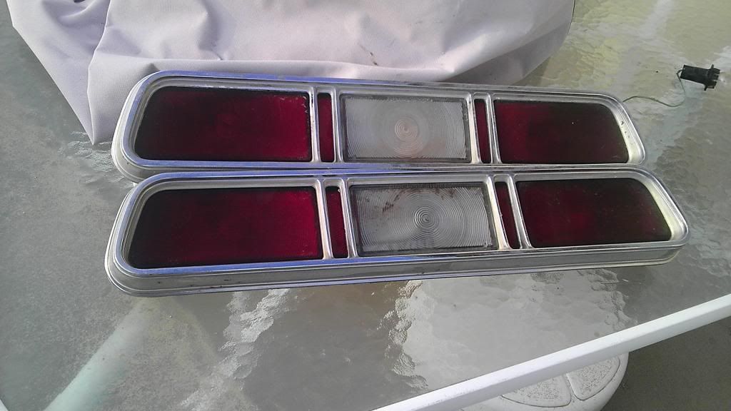

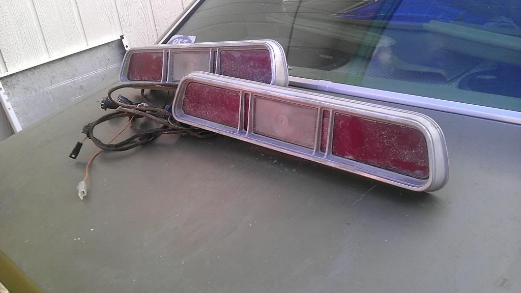

    second Update! look what i found in the back of a caprice in a hidden junkyard, behind a racetrack, beside a city. [​IMG]
    and after a little cleaning :)
    I'm not sure if i'm going to clean them then sell them, or put them on the car...thoughts?
    I for sure plan to take them apart all the way and clean them and buff them.
    still planning on the exhaust soon, then ill post a lil video of it driving and revving.....you know....guy stuff :p
  6. mav1970
    Nice build so far (y)
    I'm using those same 67 tails but with the all red Caprice lenses :)

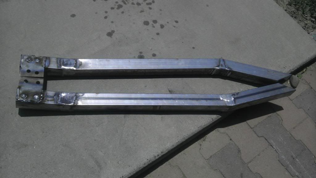

    thanks man! here is another teaser
    2x2x.62.5 sub-frame connectors, custom built by me for my 4door, where each tube was cut to bend, i plate welded it back together for double strength.
    next fabrication project is either the gas cap, or the custom v8 brace( making way for the rack and pinion. )

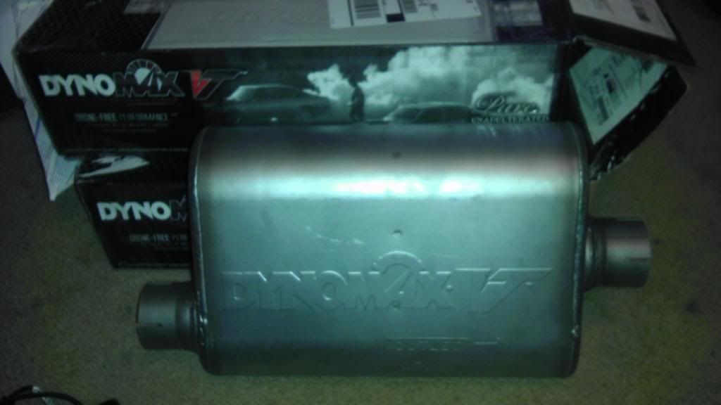

    Finally found some time to order some exhaust components in starting off with two DynoMax VT mufflers! these things are the bomb! and i ordered in and should be receiving this week my summit racing x pipe kit. if all goes well exhaust should be in placed and welded up by next Sunday.

    some photos of said mufflers! [​IMG]
