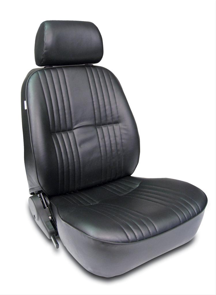

  10. scooper77515
    I was thinking of buying new seats by procar or someone aftermarket like that.
    I would like to mount them a bit further back, to give me another 2-4" of legroom.
    Is that possible without reinventing the wheel?
    How hard is it to bolt these up to my seat brackets?

  12. scooper77515
    If I have to go rigging it up with steel stock and brackets, I would rather just leave the seats at stock location.

    You can attach the new steel anywhere along the seat track that you need to to mate up with the original holes in the floor.
