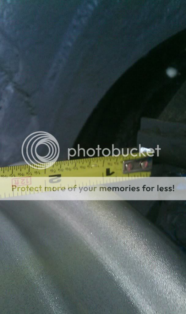

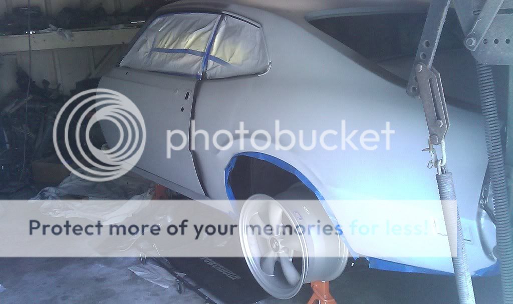

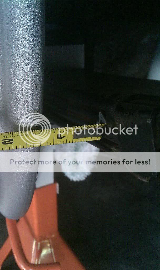

    Picture of 94-04 mustang bullitt 17x9 rims. The offset will require rolling the fender. From lip to lip measures 10"s so I'm good width 10" tread with tire.
    Overall
    1" to top axle bump stop on top
    1.25" distance from rim left to leaf spring
    linear line from outer lip to fender top

  2. maverick75
    9,014
    Now you just need some tires :D I'm also panning on using an explorer rear. I wanna run Cobra R wheels which have the same offset as the bullits.
    Seems like a no brainer, it cost $150 for a pair of spacers...But i can get a complete 8.8, 31 spline, track lok, disc brakes for $150 also :)
