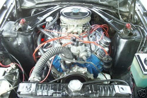

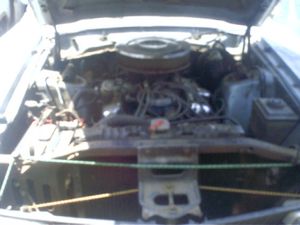

    what are these hoses for?:huh:
    on my engine their blocked off:hmmm:

    Are you referring to the hoses that come out of the firewall? If so, they are your heater hoses. If they are blocked off, you have a heater core that's leaking. You need to replace the heater core & the hoses...

    yeah they are the ones that are coming out of the FW. but the lines are blocked off
    idk why but the hoses are not even there?

    I bet, if you look close, the hose goes from the water pump to the intake manifold. This is what people do, so they can drive the car. You just won't have heat in the car...

    Like Merccruizers said, You need to get a new heater core and hoses. The heater core probably started leaking and someone just pulled it and the hoses.

    yep one goes to the I.M. and the other one is cut off
