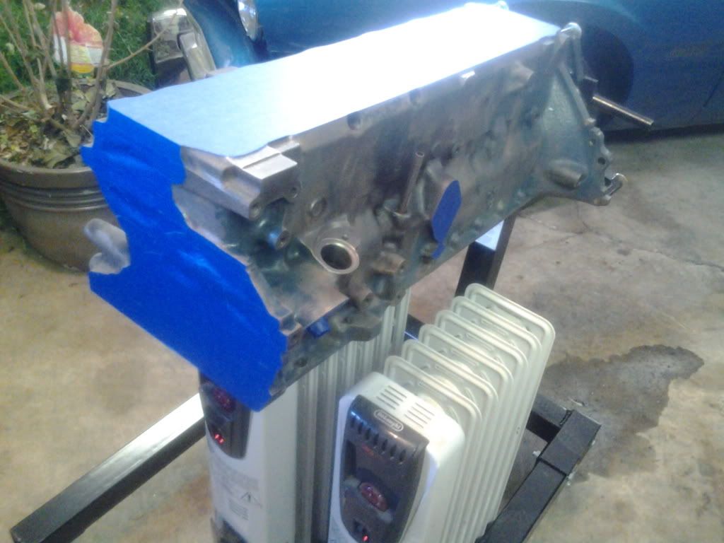

    The little 200 in my Maverick is done, its old, its tired, it has over 300,000 miles on it and several overhauls. I pulled a decent 250 out of a parts car I bought last year. The car is a 72 but seems to have had its engine placed at some point with a 75 Granada motor. I am building it back as if it were a 72. All the machine work has been done and I have most of the parts for reassembly. I am still a novice at this, but with the expert advice from a friend, I think it will go well and last me many trouble free years.
    Here are a couple pics to start. First pic is the master rebuild kit, second is the block hanging on the stand.

    Nice block heaters..... Good luck with the rebuild, should treat you much better once it running.....

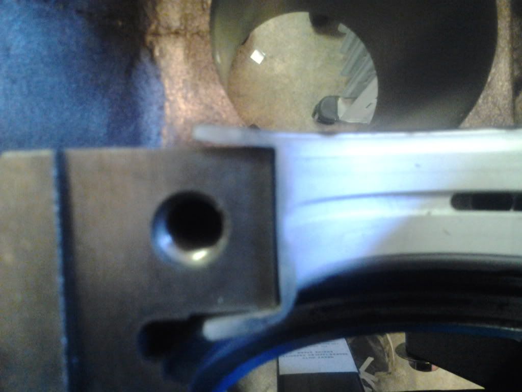

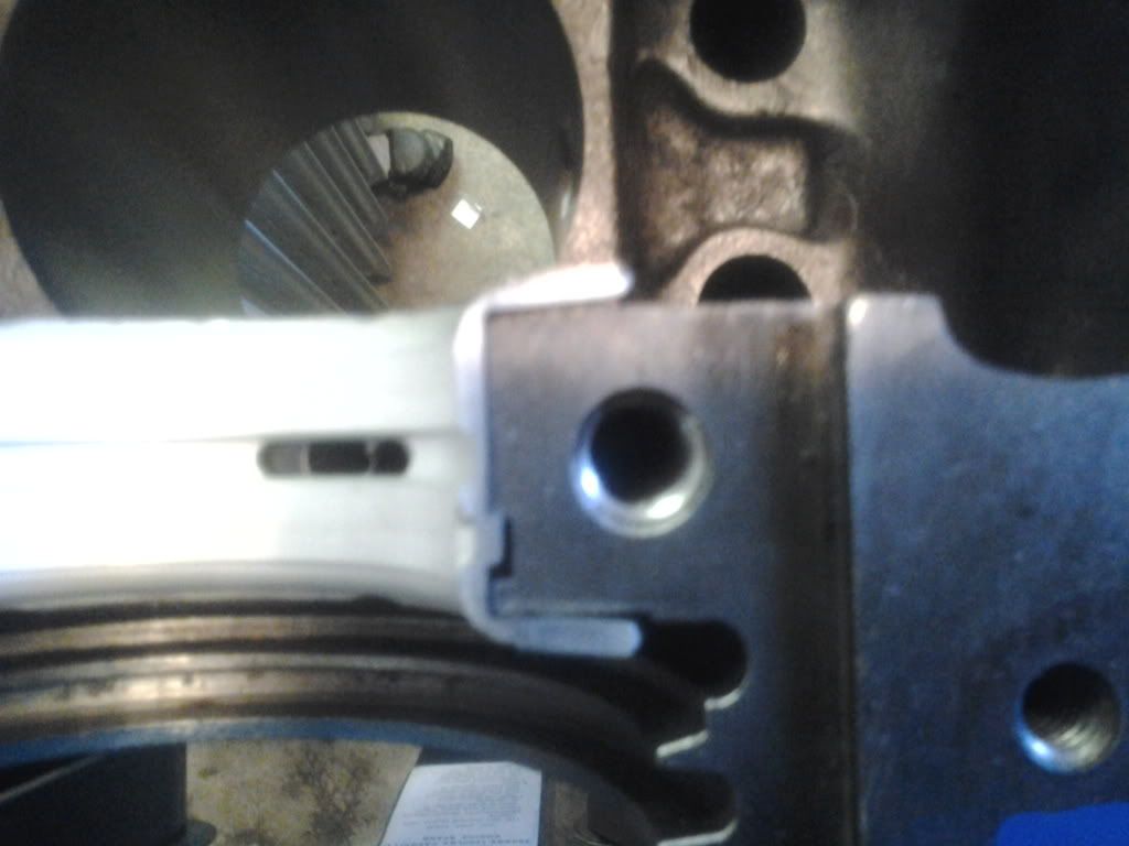

    I had a problem already dangit! The rear thrust bearing doest fit, its too narrow to straddle that part of the block. when tapped down into place it flared out on the sides. Also wouldnt seat all the way down. Im going to order another set of bearings.
    When I tried to rotate the crank, it got hung on that bearing by this little piece left over from production.

    I had the thrust bearing on the wrong journal. This is gonna be a long build!:slap:

    I was going to ask what the heaters were for until I realized what your temperature was! Looks like its coming along nicely.

    The bearings are labled upper and lower, all mine are the same except one, its made with an intergrated thrust bearing.
