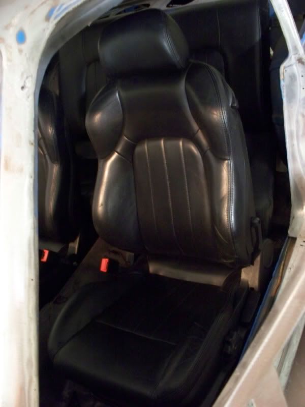

    ok guys finally going to start a real build page. As many of you know the project has been off and on for the last several years. Over the past couple months it's been reving up. I've been getting parts together for about a month now, and purchased a complete wrecked but running 96 Cobra for parts as well. I basically have almost everything to get it running minus a radiator and hoses.
    Changes:
    It will now have the Cobra's 8.8 w/4.10 gears disc brakes, and Cobra front brakes with 13" rotors. Wiring is going to be all Cobra none of the factory Maverick stuff will remain. Reason for that is I will be using the Cobra cluster, pedal setup, steering column, sound system, fuel system, and going to try a fit the entire a/c system in the Maverick as well that way as far as the wiring goes it will all be plug and play.
    Earlier this week I purchased the front and rear seats. I was not crazy about the Cobra tan leather seats and really wanted something non-power. After looking aftermarket I starting looking OEM and what I ended up with was Hyundia Tiburon 03+ seats. These are black leather, manual adjustments, fit great, and are very comfortable. I got the whole seat front and rear for $200. Im very happy with them and now you have another option for your Mavericks.
    I will keep posting pics here is what I have for now.

    cool seats, what is the cobra cluster?

    ive got the same seats in cloth in my maverick

    Those seats are awesome i want some!!

    I loved the seats!

    Just wondering how the back seat from that Hyundia Tiburon are going to fit. Will it take much modification to get them into the back of the Mav?

    Since mine is mini tubbed, I'm going to have to take about 2+ inches out of the center of the bottom portion of the rear seat and about an inch from both sides of the back. These would probably fit in a stock Mav?

    Check before cutting! We mini-tubbed my '72 (2" per side) and the bottom seat fit perfectly with no narrowing. Just hoping to save you some grief...
