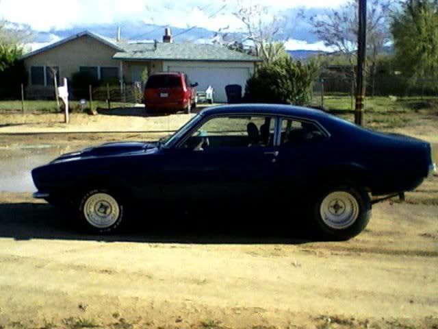

    I'd just gotten some money, enough for whatever car (to a certain extent) I wanted. First Mav I bought: a 70 I6 200. Body was perfect, it looked mean, and I couldn't pass on the price.
    But it wasn't what I wanted. Sure it looks great, had no visible rust, and sounded mean, but it was an I6. A six. I wanted a V8. :16suspect

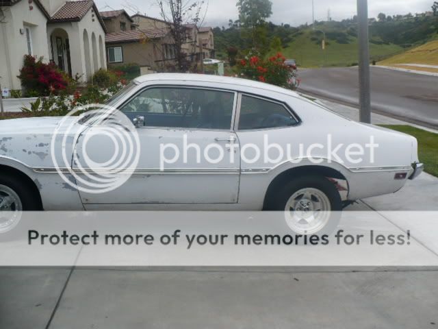

    So, the search continued. Silly me, wanting it now now now[/i], I jumped at the next opportunity: a car that looked good in pictures.
    Well.....sorta.
    Stargazing from inside the car. Wonderful. :16suspect

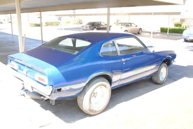

    I rented a car and drove down to San Diego with the Dude to pick it up. So excited was I to get a Maverick, even a 73, that I went ahead and paid what the kid and his family were asking for it: I can't even think of the number because it makes me cringe.
    We didn't even get it down the street before it died on us. Things, of course, only got better from there. :dancing:

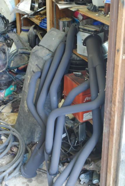

    The car came with a set of Hooker headers which had been put on badly and leaked exhaust, plus hadn't been covered with any wrap or header paint. (We've since fixed that, they're now sprayed a pretty black)

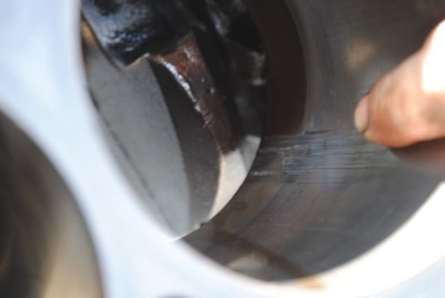

    That done, we turned our attention to the block. We haggled a bit about whether we needed to open them up; I wanted to see it all, he thought the top end would be enough. Guess who won that argument (to his credit he didn't try too hard, I think he wanted to check too). :D Boy oh boy, am I glad we checked.
    :49: :cry:

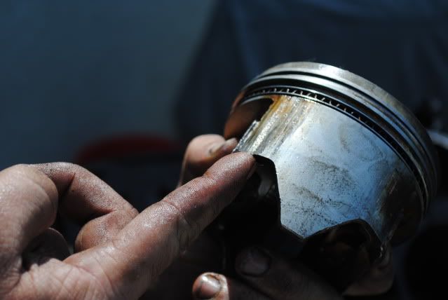

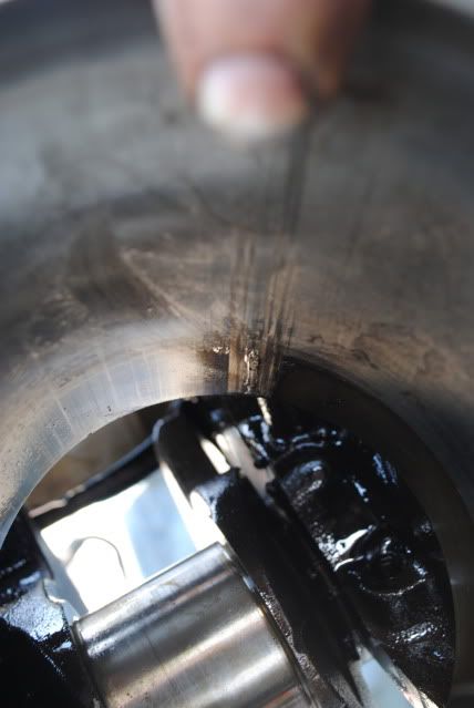

    Two pistons/cylinders were shot; we'd figured something was wrong with those two based on the lack of soot and grime on the valves and portions of the pistons, but it was still disappointing to see actual GAUGES in the metal.
    This brings us current to day and just coming back from the machine shop. Apparently, this motor has already been bored .040 over. The change wasn't recent (so the kid didn't get to screw this up) but nothing else had been changed; the engine still had the stock intake, cam and carburetor (minus all smog stuff which of course made a vacuum nightmare; between the fuel sending unit in the cell pumping the gas and the 2bbl nature of the stock carb, the car was running a tad rich).
    So: I will now (hopefully) only be boring the engine out to .060 over and totally redoing the bottom end too. Yeah, don't I sound like I'm rich doing all this at once?

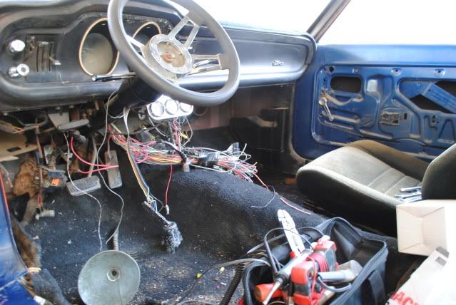

    Right now we're doing a lot of cleaning and painting. My initial pace was pretty speedy: I needed a car (preferably reliable) so I wouldn't put more miles on my leased car. Now, with having to wait for parts and a backed up machine shop my pace is forcibly slowed so we're going to do it all. I have new bushings for the swaybar, an AC/heater core to install, engine bay to clean and paint etc (not necessarily in that order of course). I still need this car up and running yesterday but, hey, what can you do right?

    I would have to think twice on boring out to .060. Anything happens, that block gets tossed or you will sleeve it. May want to look into the newer roller short-blocks. Not sure, I remember the deal an return on heads, but a Jasper reman short-block just (or complete engine) may be what you want.
    Looking at your above list, cam an timing set should be the only things you wont use on a reman block. Not bad an maybe returnable! There is some empty floor space for more parts,,,, er my bad, I usually fill the floor! hee hee
    At the least, I would find another block and start with a .030 bore at max.
    All the above is my thinking and just sharing my dumbness! You have to pay for your habit and take all the praise or aw dung for your great stories! Good Luck and keep sharing!

    I think one of the biggest mysteries with this car is why on earth someone would bore out the engine complete with new pistons, then put back on the stock heads, intake, and carbs with no modifications. Really has me scratching my head in wtfery.
    I'm not really keen on boring over the cylinders to .060 either; the machine shop is too busy at the moment to mic my block so I'm taking a bit of initiative and heading down to a local junkyard to see how much another 302 block would be. This place is a mecca for car parts and they're usually willing to work with you; if I can get a roller block for under $100 then I'm going that route. We'll see though.

    ,,,,I think one of the biggest mysteries with this car is why on earth someone would bore out the engine complete with new pistons, then put back on the stock heads, intake, and carbs with no modifications. Really has me scratching my head ,,,,,,,,(quote)
    Boring in many of our engines is done to "clean-up , square-up" wear or mass machining. Kits are sorta mass produced, well er marketed,,, with .030 pistons, knowing that most engines will clean at that dressing. Always good to deal with company that offers whatever size piston you need.
    Core shifting, bad Mondays, and who knows what else gets a cylinder outa whack with the crank shaft. Good machine shops will not only clean up the bore but square it with all the rest.
    I'm getting too long winded here. Power performance is rarely the reason for boring,,, very little gain in the .030-060 punch,,, Your engine most likely had problems back then and owner needed it bored to .040 to clean up!
