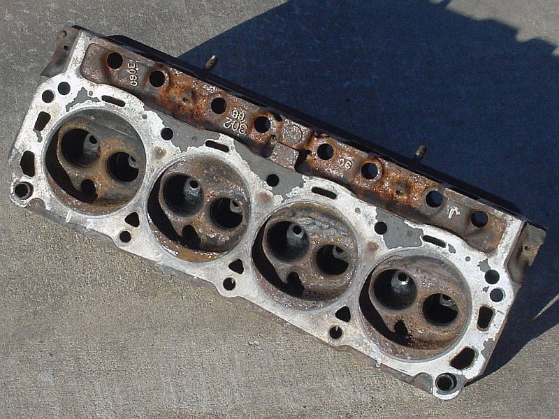

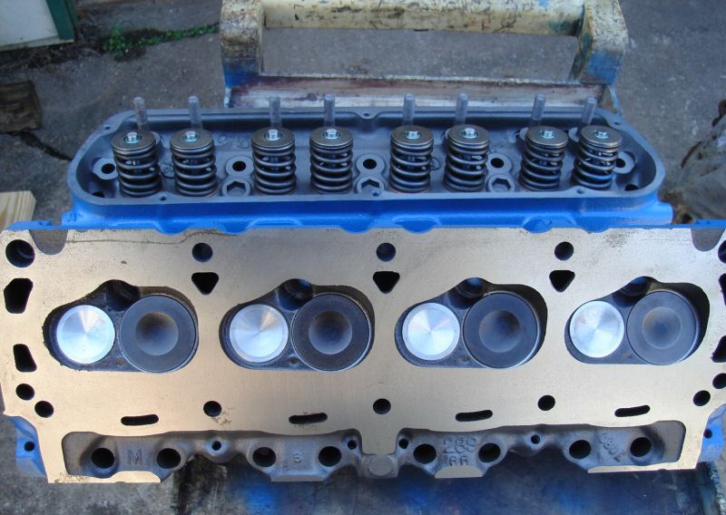

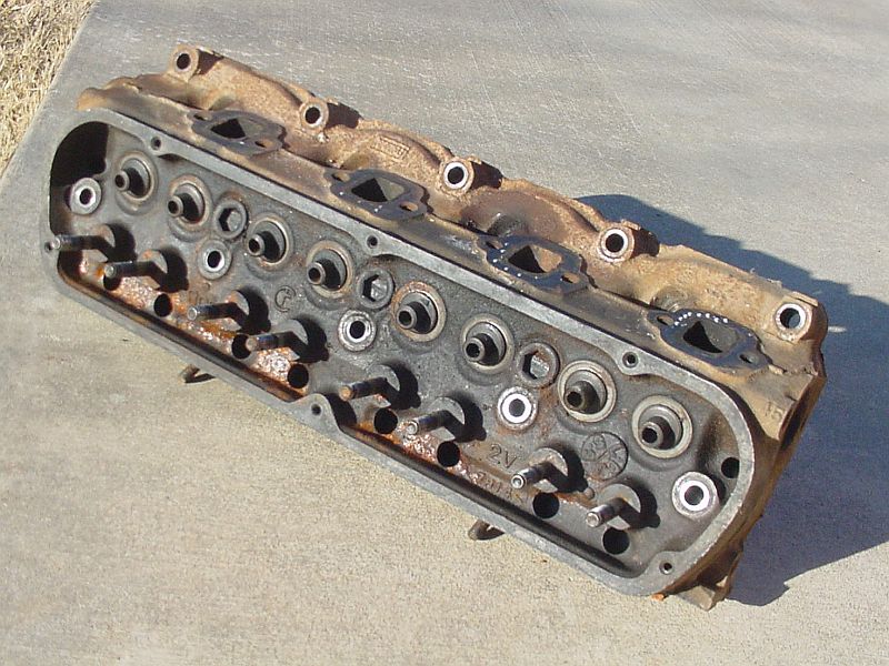

    yes
    I have always heard that those were 289 head castings, with the larger 1.78 intake valve of the 302. They had a '2V' casting on the 302 head with larger combustion chambers.
    J-code with likely non-stock valves.
    Note '2V' cast in the head
    Big difference in the chambers-C8 head also. I don't know what the piston differences were. But the '68 J-code 4V was marked at only 250HP, maybe underrated?
