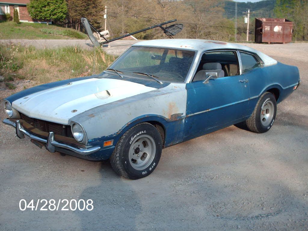

    Well, as of yesterday I got my '71 up and running. I took it for it's first run around town today while a local festival was going on, you know, to show it off a little :). After almost a week's work of work here's what i got accomplished: :yahoo:
    -old engine removed
    -transmission removed
    -"old" engine parts swapped to "new" engine ('91 5.0 HO)
    -reinstalled engine
    -reinstalled transmission
    -hooked up nic nacs
    -etc. etc....
    The end result is a carb'd '91 model 302/5.0 roller engine, 4V Weiand intake, Edelbrock 600cfm carb, 3G 130amp alernator conversion, MSD 6AL ignition installed, dual 2" exhaust w/ flowmaster mufflers and a few other odd and end items. :drive:
    While taking it for it's first run today I noticed the tranny having trouble shifting into 3rd gear so in light of this discovery I'm thinking of putting an AOD trans in the car. I have the matching AOD from the 5.0 roller motor so shouldnt be a big deal. and for those interested, here's some pictures :bananaman

  11. mean_maverick
    in the next 2 weeks to come im going to put an AOD trans in it and maybe go ahead and paint it.... we'll have to see what happens :D Thanks for the support guys!
