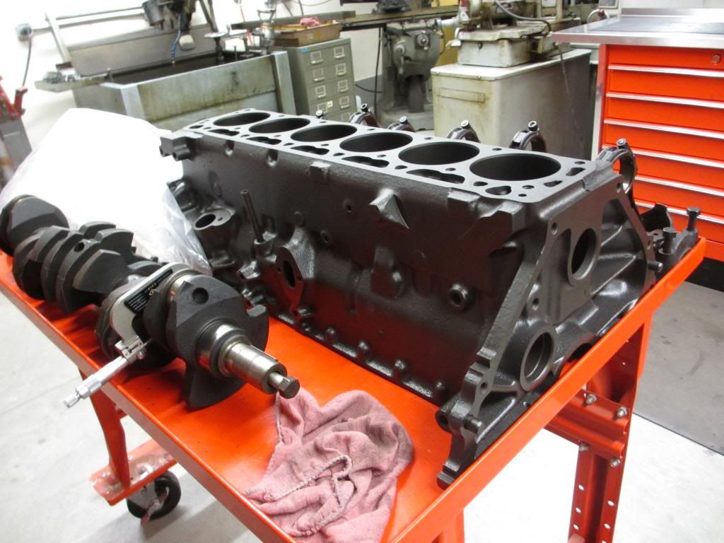

    Hey everyone ..I am doing a complete rebuild on my 250..I measured my cylinders and they were pretty much within specs except couple cylinders that had like .002 amount of taper..I measured my pistons and the measurements were all over the place..my engine lacked on oil changes so the pistons were worn down the middle..so my teacher told me i could get away with honing but he said it would be best to bore it out since i want to put new pistons and everything else new...i am going to bore it out .030 over...as far as my crankshaft here are my measurements i took 4 measurements on each main bearing and each connecting rod journal...
    Crankshaft Main Bearing Journal Size
    1A)2.3985 B)2.3983 C)2.3985 D)2.3985 2A)2.3985 B)2.3985C)2.3982 D)2.3983 3A)2.3984 B)2.3984 C)2.3984 D)2.39824A)2.3982 B)2.3982 C)2.3980 D)2.3983 5A)2.3984 B)2.3983 C)2.3982 D)2.3983 6A)2.3984 B)2.3983 C)2.3982 D)2.3983 7A)2.3983 B)2.3984 C)2.3982 D)2.3984
    My Main Bearin Journal Diameter Spec is 2.3983-2.3990
    For my Connecting Rod Bearing Journal I took 4 measurements as well and they are as follow :
    1A)2.1231 B)2.1230 C)2.1232 D)2.1231 2A)2.1231 B)2.1231 C)2.1231 D)2.1232 3A)2.1231 B)2.1232 C)2.1231 D)2.12314A)2.1231 B)2.1231 C)2.1231 D)2.1231 5A)2.1230 B)2.1231 C)2.1231 D)2.1232 6A)2.1232 B)2.1233 C)2.1234 D)2.1233
    My Connecting Rod Journal Spec is 2.1232-2.1240
    So my teacher told me that the crankshaft was within specs the only thing off was probably the surface finish ...he told me i could reuse the crank like that without grounding it down..but I wanted to ask you guys what was my best option to go with...I have the money to spend so if grinding down the crank helps me out in the long run then ill do it. I just want your input.

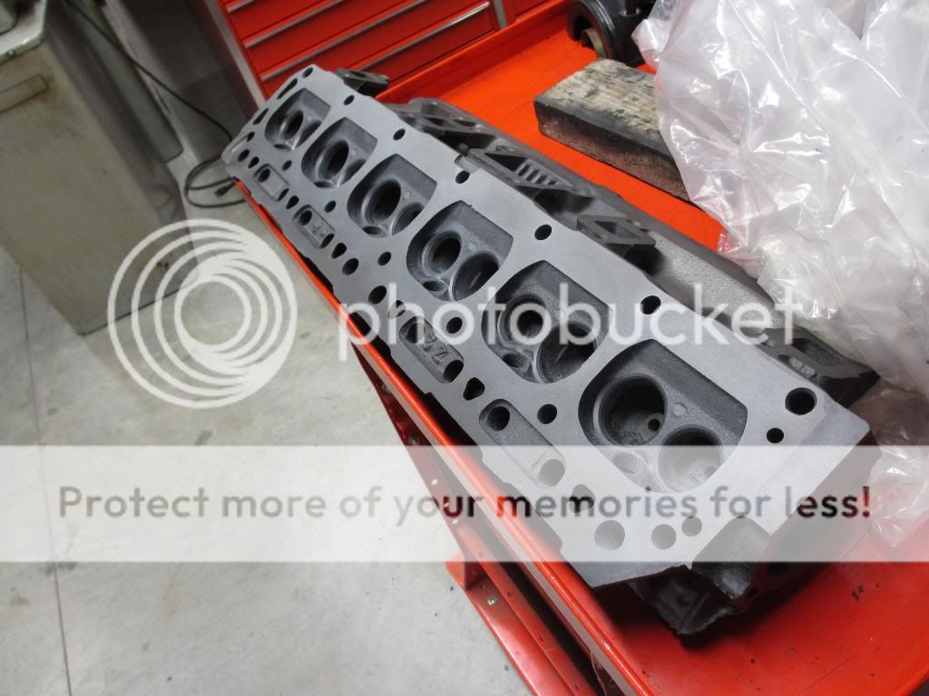

    As far as the cylinder head i just got it shot blasted and cleaned up so i started cleaning the valves so I could measure them..i ended up checking the head warpage with the straight edge and feel gauge...a .003 feeler gauge wouldn't go in on the outer cylinders but towards the center it would go in...so I tried the .004 feeler gauge and that one didn't go in...my teacher said therefore I have .003 head warpage which he said its fine and i can get away with without resurfacing the head...i would like to know if he is correct about me having .003 head warpage..I did read on the Chiltons manual that .003 is the wear limit on the head warpage..As far as the valve seats I am definately replacing the exhaust seats but I was wondering if i should replace the intake ones as well or just grind them down..
    I am trying to get as much input and opinions on this..this is my first rebuild and I am doing it all by myself at school..we have all the tools needed and I feel I am headed in the right direction...so any tips and hints on this would be very appreciated..this motor will be going in on a daily driver ..I want to keep it up pretty much stock but im willing to do little modifications (if it doesnt require much work)so I can get more power...nothing to crazy though...thanks alot and I hope to hear from you guys!
    Your fellow Pal,
    Valente :thumbs2:

    being you have all the tools and equiptment, I would do it all...:thumbs2:
    bore to the next size piston...turn the crank to the next size bearing..replace valve guides, seats and grind valves.(check spring tention).deck the block and mill (surface grind) the head.
    be sure and check to see what size pistons, rings and bearings you can get before...boring/turning...:Handshake
    sometimes a...crank kit is the best way to go...new radiator.
    enjoy...:Handshake

    Try NAPA for the kit, I've gotten two from them that turned out great.
    For the 6 cylinder the original shim head gaskets are not available anymore, only the newer thicker composite style which are about twice as thick.
    So I would advice having the head milled to get the compression ratio back to stock.
    And also it'll take care of the warpage. So it's like killing two birds with one stone!

    Check the block with a straightedge like you did with the head. If its still good theres no use in spending more money.
    Be sure to get a quality rebuild kit, try asking the guys on fordsix.com/forum or PM Gene Fiore on here. He has a wicked 6 cylinder.

    Ok so check the block with a straightedge the same way..im guessing the maximum warpage allowed on the block would be .003 as well as the head or am I wrong..and you still recommend milling my head even if my block warpage is right?
    I see that you live in Riverside by the way..I live in Vista..not too far from you (y)
  10. maverick75
    9,014
    I would, I think the stock gasket is around .020 and the modern ones are around .045 Which is more than double.
    If you don't mill it your compression ratio is going to drop, which you don't want. Especially since the 6 cylinders already have low compression to begin with. Just milling it down so that the compression ratio remains the same as stock would be best.
    We have pretty crappy fuel out here in Cali not to mention expensive, so the stock compression should be able to run 87 just fine.
    As for the block it should not exceed 0.030, if it does you can mill the block instead of the head to compensate for the gasket. Although I would check to make sure the pistons have enough room.
    I'm not that savy on the 6 cylinders so I don't know off the top of my head if you can deck it without any problems.
