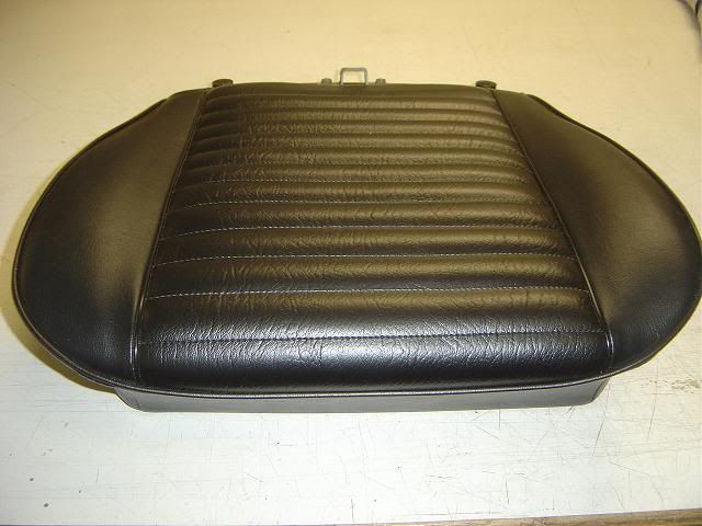

    I will be covinging 2 front high-back buckets 71' seats, in the Black corinth vinyl, with (new old stock) of the factory Black "Diamond" pattern Comfortweave Inserts.
    The back seats will look the same, except the shape of the seat pattern will be for a 1972 back seat, that has the sides that allow for the "side panel seat belt retractor bulge".
    Fred also supplies rechromed seat emblems, that will go in the front bucket backs.

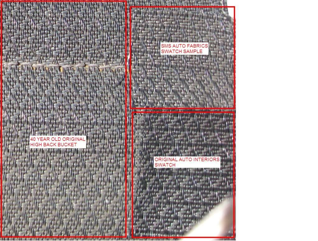

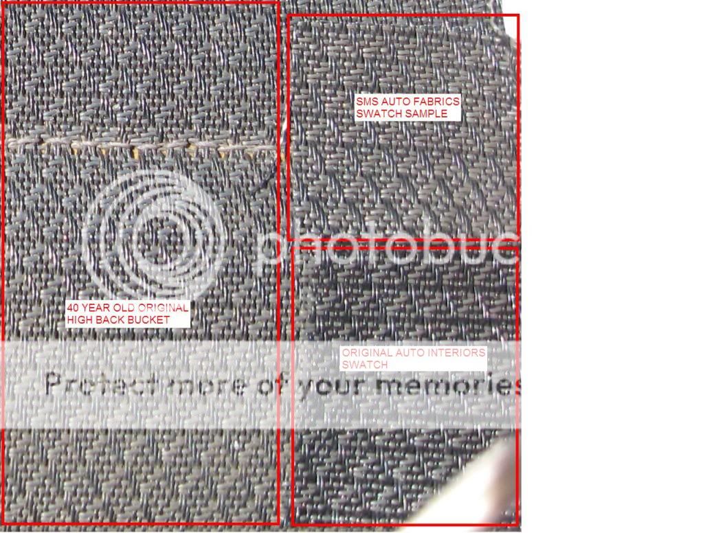

    I want to say that I had sample swatches sent to me from BOTH SMS Auto Fabrics, and Original Auto Interiors, and BOTH companies were
    very polite, and nice to deal with. I am endorsing these two companies equally, as I am thrilled that we have yet another company
    supplying us with this dwindling, and rare material. I only did this search because I was afraid the last of the material would die out before I had a chance to do my restoration, and I wanted to give myself, and others a safety net, for doing factory style restorations for our Fords.

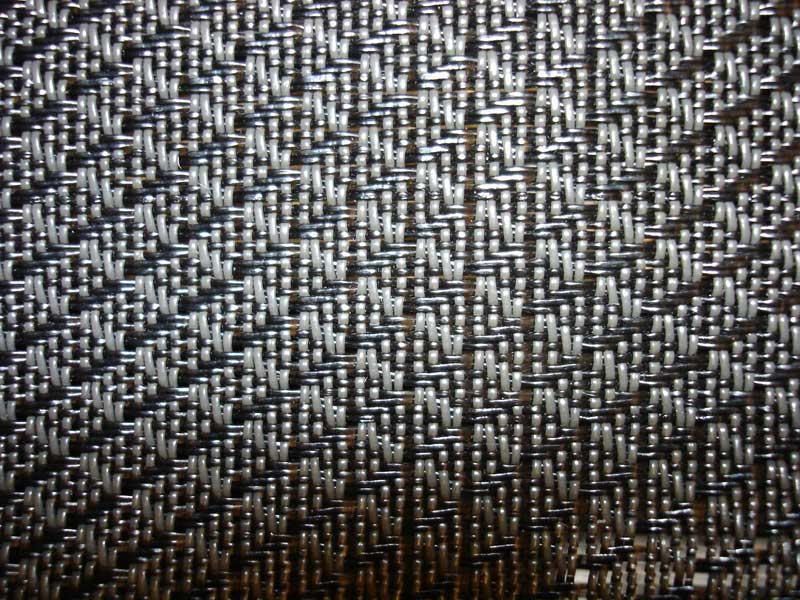

    I took a photo of 3 of the same type of black comfortweaves, laid together for comparison. These three include my original 71 Grabber seat, the SMS swatch sample, and the Original Auto Interior swatch sample. This is what I noticed:
    1. They are basically the exact same material.
    2. They are made of individual woven strands of grey and black.
    3. If you strip, any of the 3 samples, with a wire cutter, you will find tiny white nylon strands inside of each individual
    comfortweave strand. This told me the two NOS samples were factory correct, even on the inside.
    4. The Original Auto Interior sample has a more vibrant color of black under normal light, and under a camera flash, as you can see if
    you look closely at the pictures. This is most likely due to variations in original runs, or possibly the way they were stored. No UV protectant or teflon spray has been applied to any of these materials. All of these materials are over 30 years old plus.
    5. For any of those that have never seen black comfortweave in person, it looks black from a distance, and as you zoom in it looks like Dan's photo. It also takes on a grayish look with a flash camera picture.

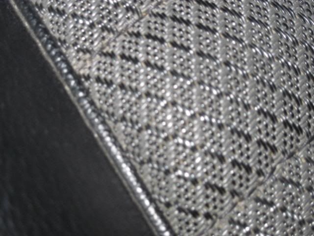

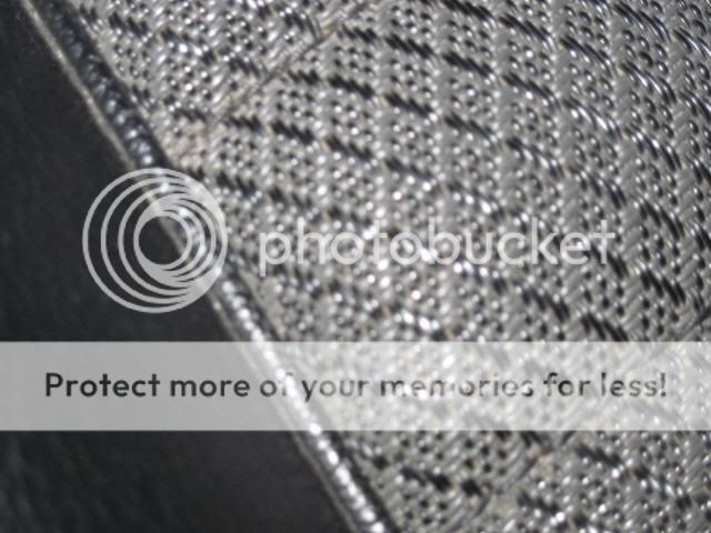

    I want to thank Dan Hines for posting the first really really zoomed in picture of the black comfortweave material. This is what made
    me more curious about it:

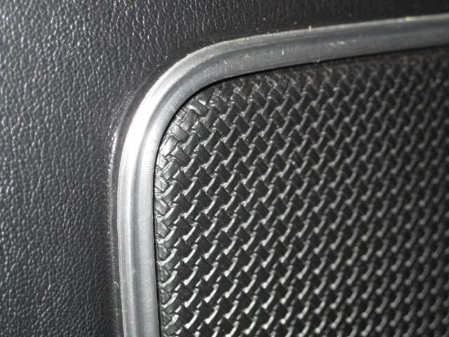

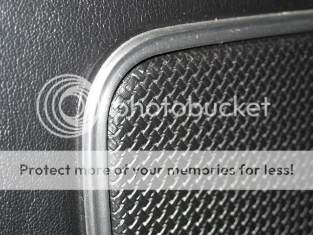

    I want to thank Craig Selvey for answering numerous questions about the material, and for the extra pictures he took for me. Craig's
    pictures show that, as most of you already know, that the deluxe comfortweave on the seats, and the deluxe pattern on the door panels
    are not the same thing. The deluxe weave door panels are a "basketweave" design that is embossed into the vinyl.

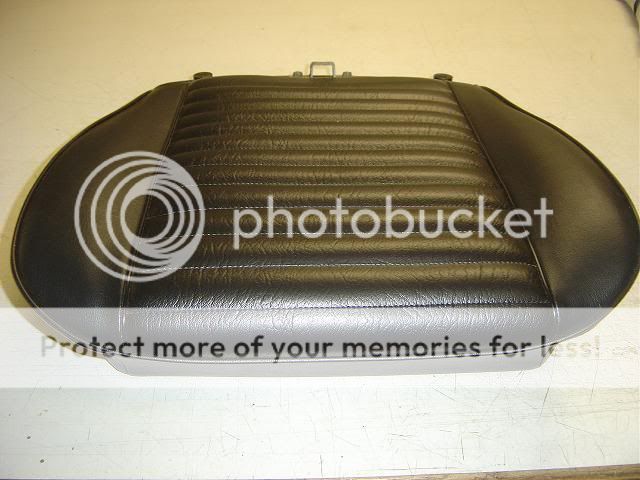

    I want to thank Fred Carello for all of his emails and help about re-upholstering my seats with this material. Fred is the one who is making the seat covers for my car. His work looks amazing! (see below)
    Here is a great example of another member's seat covers by Fred Carello:
