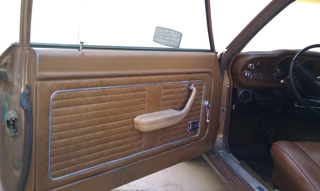

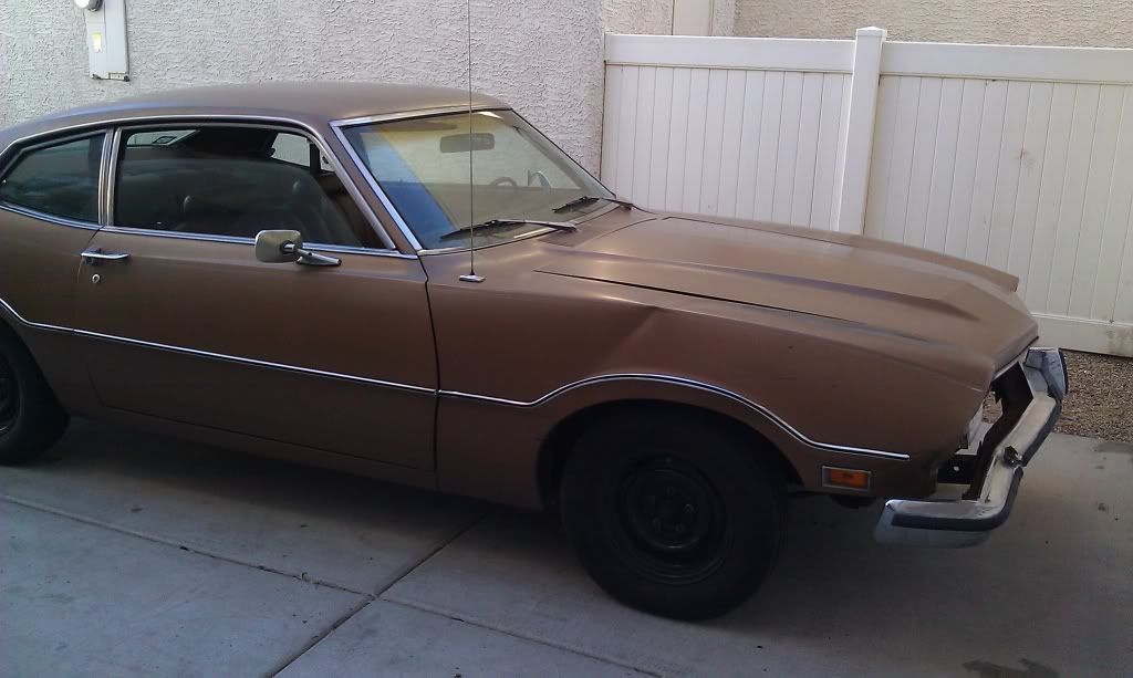

    hey guys, is there any certain way for me to know which 1973 maverick do i have?
    labels? paint? features? style?
    anything i can identify would be awesome.
    i bought it on 9/20/11 with 90k miles on it. it runs and everything works.

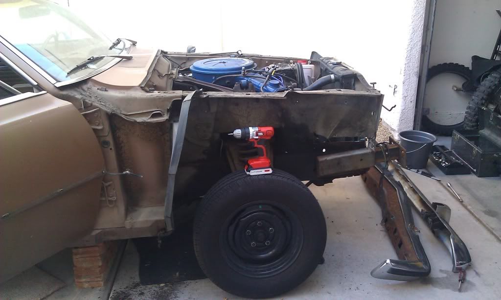

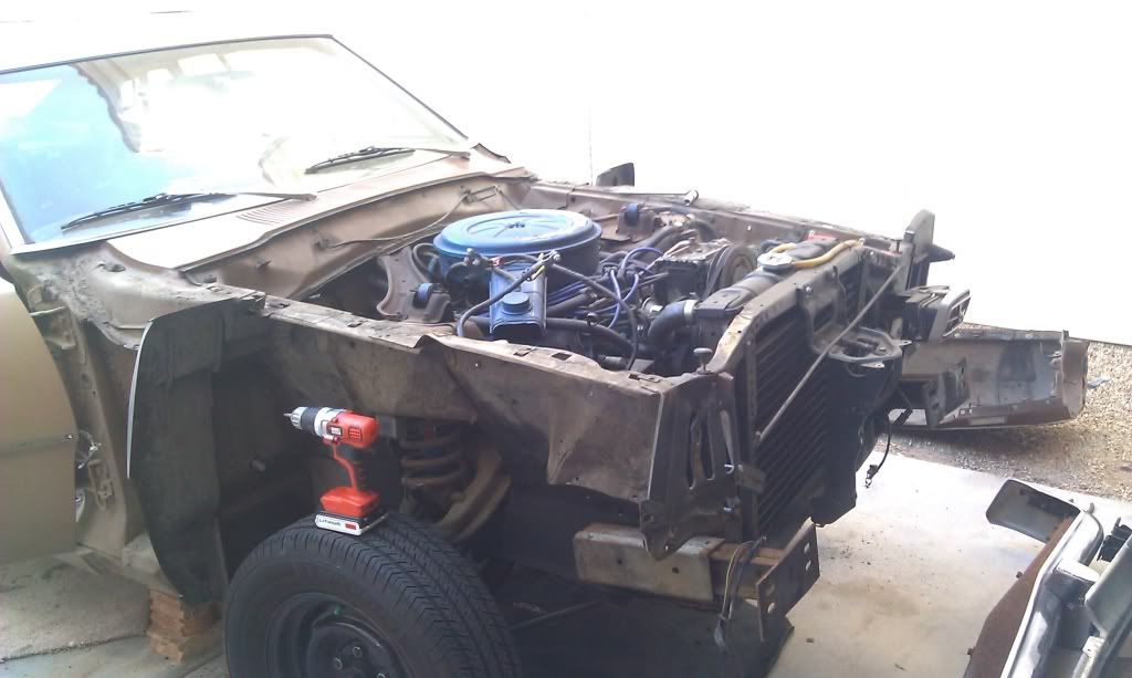

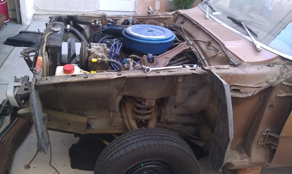

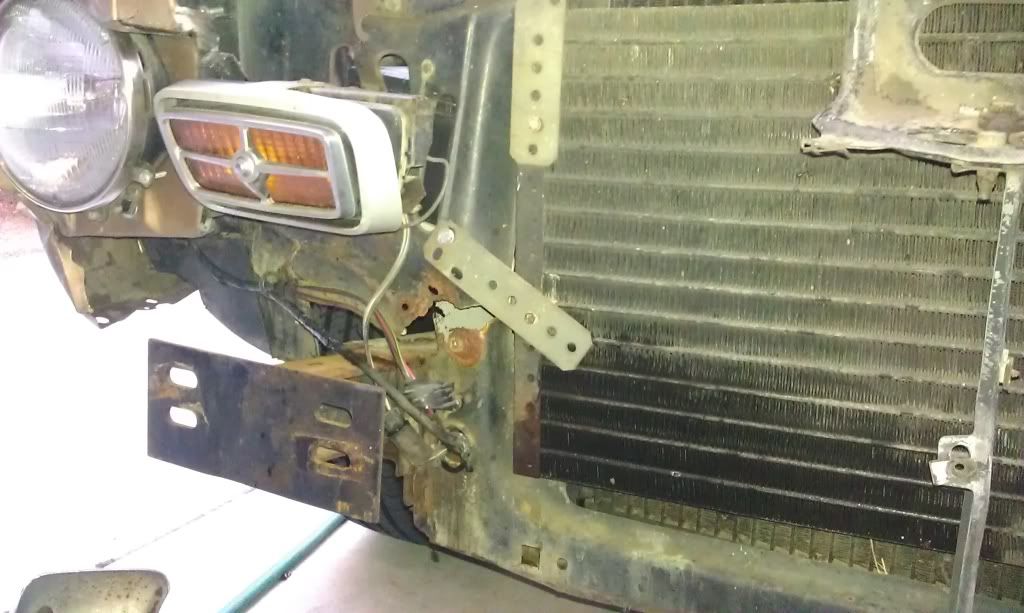

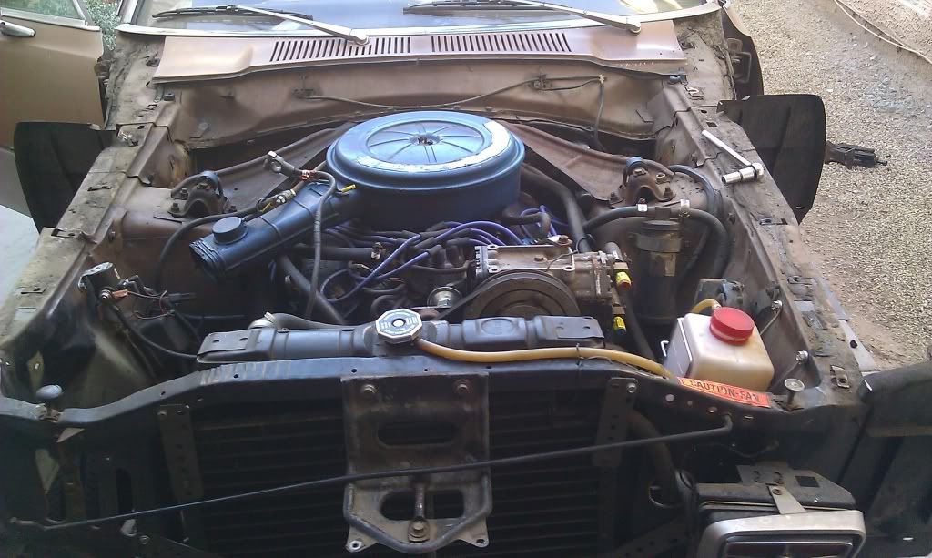

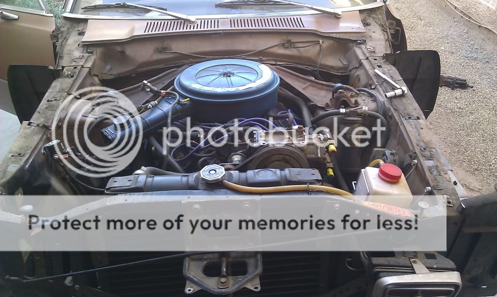

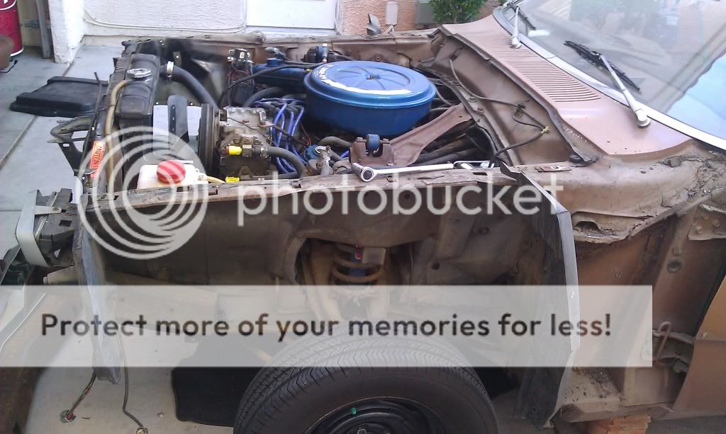

    so far i have torn the interior apart and taken everything out. i will be changing the interior color from brown to black/brown, i think it'll look good. also today i took apart the fenders and hook as well as the radiator and condenser. i found out that there is few radiator body support damage as it seems like it has been in an accident.

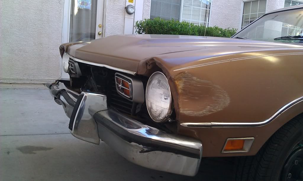

    I think you better find a body shop, and put that car on a frame machine...before you do too much. It's been hit pretty hard on the right side.

    i don't think it has frame damage as i inspect it and see no bents or damage to the body frame. the only damage is that from the radiator support till battery holder is bent up. i'll have someone else take a look at it too to be sure.

    It takes a good hit to bend it up like this:
    Since these are uni-body cars, it doesn't take much.

    The bumper mount in this picture is severely bent UP. Have this car checked out by a professional.

    Also....you really need to check and see if the frame is bent before you go any further with this car.

    Can I visually inspect the frame bent? I'd like to inspect it myself before taking to body shop
  12. Craig Selvey
    18,337
    1,389
    You might be able to. But...do you know what you are looking for? The instant I saw your pictures...my first thought was "bent frame". It would be worth paying a shop $30 to $50 for a visual inspection. If you were closer....I would do it for you.

    looking at bumper mount on drivers side. pushed up, and in towards the center of the car. passengerside just bent up. but more looking at how mangled the apron is.
    look right above passenger side tire. how its kinked up like that. I don't know how older cars like these take hits because 99% of the cars i have worked on are like 1990 + newer and most of anything that old with any kind of frame damage aside from being pulled is going to totalled, at least that we get in.
    looking at this picture looks like the welds are broken going towards the end of the frame rail at the bottom.
    like i said i mainly work on newer vehicles which have all different designs for frame set ups now. but before you invest alot of money into this car i'd let a body shop take some measurements for you. do you want to put thousands of dollars into something that might never drive right?
  14. Bryant
    even if the front frame rails are bent, the car is not scrap. you have options. you could put a custom front suspension on. you could do a mustang 2 suspension swap and build some custom frame rails to goto the front of the car. you could even get more creative than that.

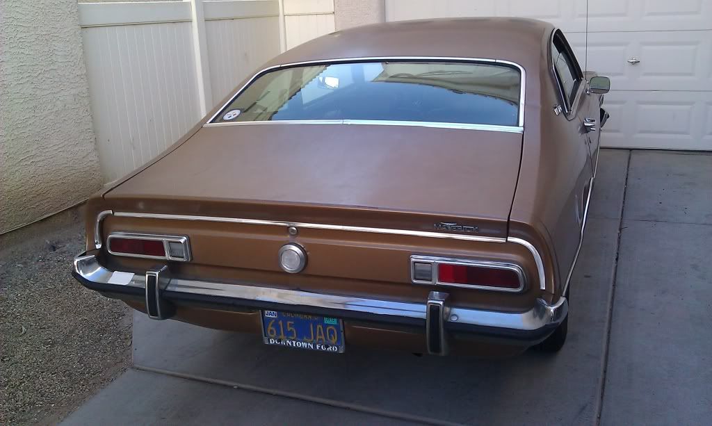

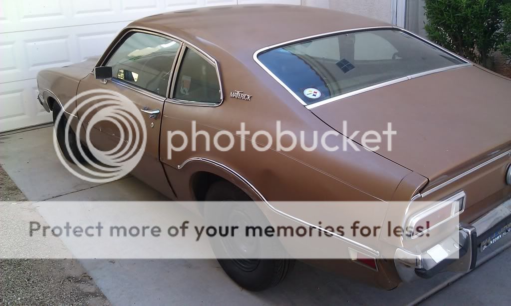

    strokermaverick Member

    Both of the quarter panels are slightly buckled, behind the wheel wells. It will take the same kind of pressure, but in reverse, to correct that. It will have to be done in a body shop, also. It doesn't take much of a rear ender to create those buckles, when the bumper is fastened directly to the tail panel of the car. Your car looks to be solid enough, but just not treated the best in the world by the previous owner.
