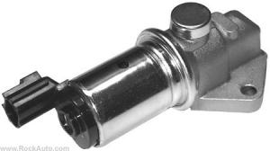

    If your sure there is no vacume leaks then i would check or replace the Idle air control (IAC).Very common Ford EFI problem.My 5.0 F150 use to surge and stall,replaced the IAC runs perfect.
    Also pull the air silencer out from behind the air box its in the wheelwell good for a few extra HP.
    IAC..
