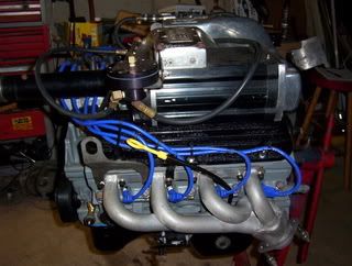

    Up to that year, the motors had flat top pistons with 'no' valve reliefs making a higher lift cam install a problem for better performance.
    The heads were E6, the power rating at 200 hp.
    From 88 on to 93, the pistons are forged and have valve reliefs. These motors are actually Mustang motors running on Speed Density controlled fuel injecton and have the same 225 hp rating with E7 heads.
    The later motors would be a bit better overall and are roller lifter motors.
    If you want to go 302 and a good overall performing engine, consider a 2001 Explorer motor and out fit it with 86-93 parts on the ouside.
    This way you get 40p heads and a good hard pulling cam all from the factory.
    Only issue is getting headers fit to the application in a Mav.
    The 40p heads has a more straight out spark plug direction and need headers with more room to get at them.
    The photo shows how much header room is needed to get at the plugs.
    The eguipment on the top is the supercharger.
