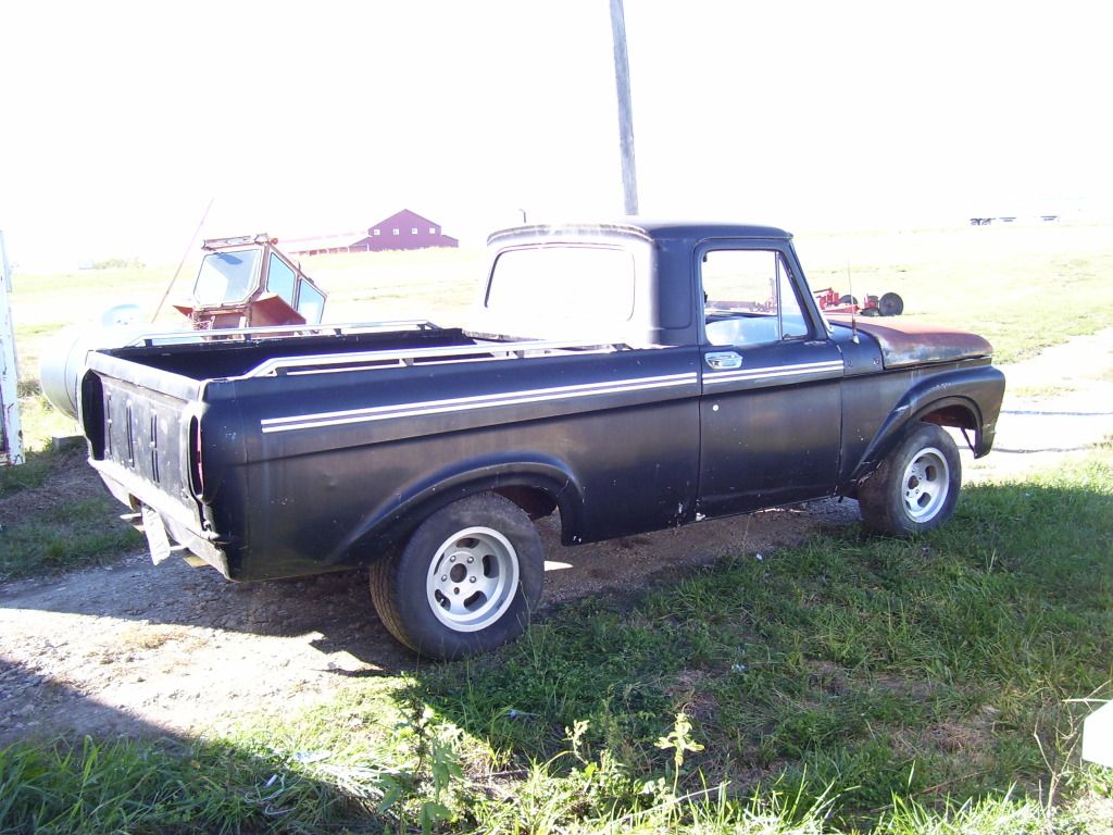

    If your heart is in the FE family, maybe you'll like one of my pickups.

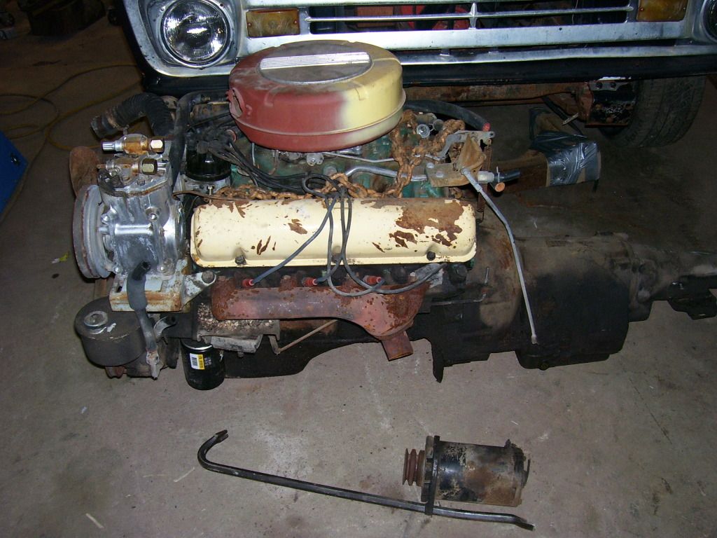

    Original 80,000 mile 352, Mustang T-5, my parts chaser (when the weather is nice).
    Considering putting this on the '66 F100, but it gets 18MPG at 2000 RPM going down the interstate with the T-5. I don't want to loose that, but this would look cool on it.
    If that doesn't do it, how about a unibody that's geting a 430 Lincoln/auto, Ididit tilt/shift column, CON2R custom steering wheel, low back buckets, big back window conversion, traingulated 4 bar, Dakota/Industrial Chassis front suspension?

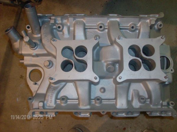

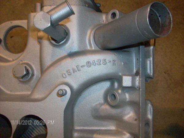

    Is that a Ford C3AE-J dual 4 intake...................if so it's the best street dual four for a mild big block............and with progressive linkage I'd think that not putting you foot into it should give you pretty good gas mileage.

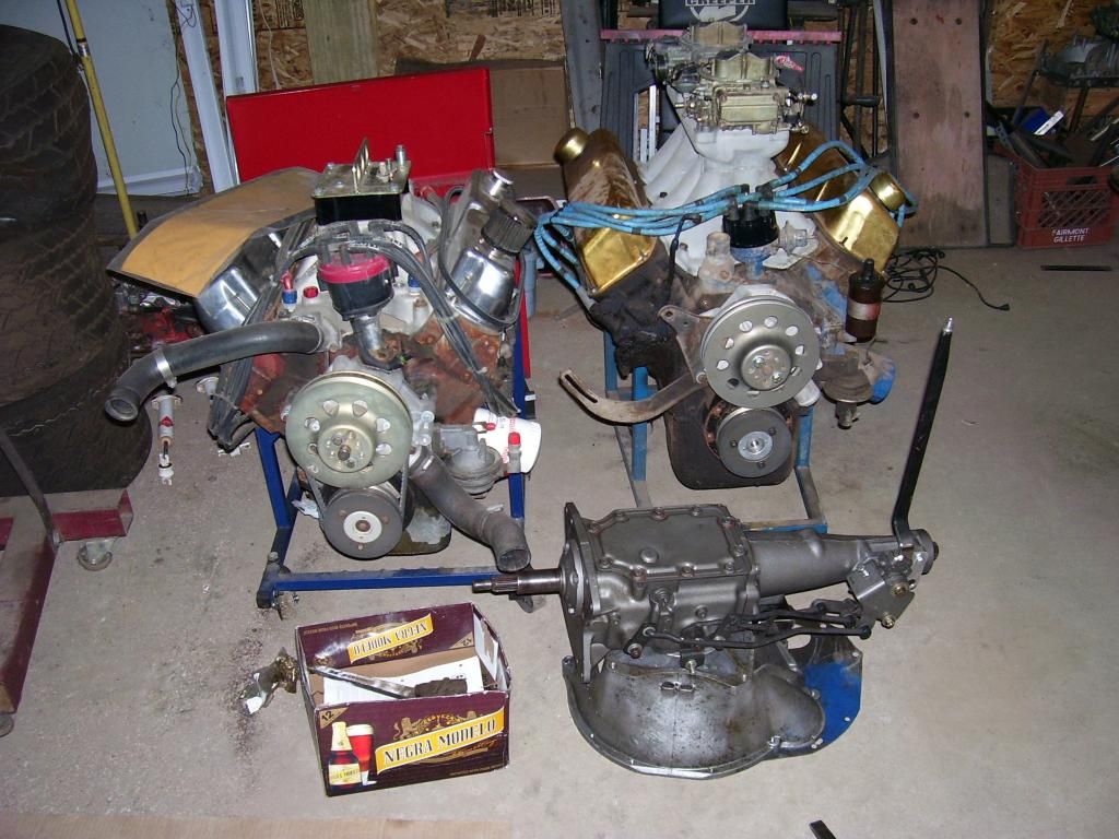

    Picked up the top loader yesterday. Was also supposed to get a Lakewood scatter shield from another guy but it turned out it only fit a Tremec and not the top loader. Shifter is a write-off. Looking for a V-Gate/RamRod type shifter if anyone has one they keep tripping over.

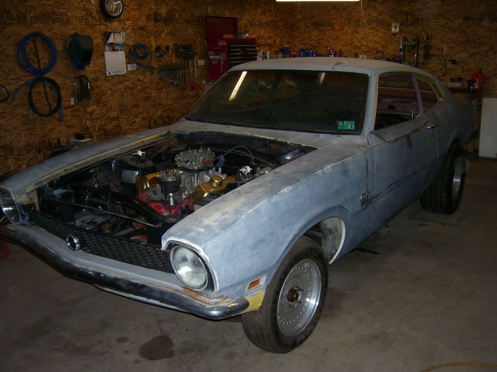

    Got the front tires mounted on some skinny wheels to work with fitment/shock tower move. These wheels will eventually give way to a set that matches the rear to keep things period correct.

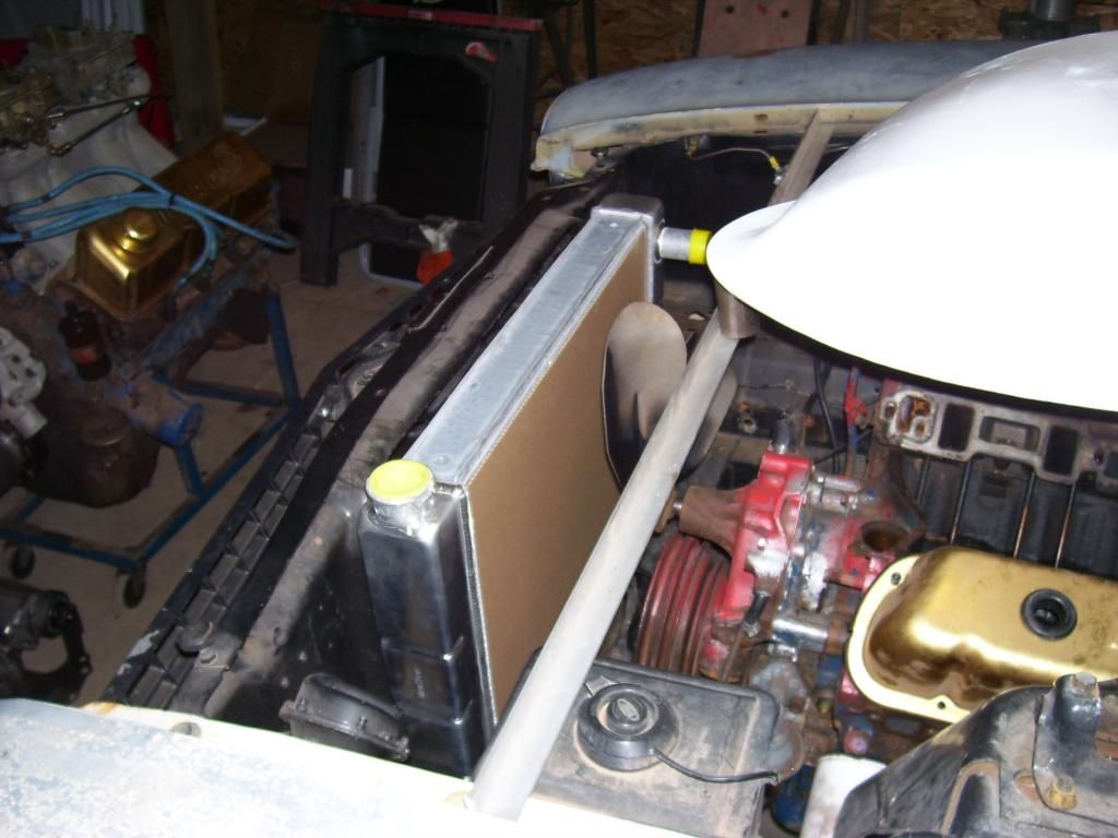

    Got the radiator mocked in (19x26 aluminum) but haven't made the top mount yet. Bottom is sitting on the stock Mav mount. Did have to trim a half inch strip from the outside corners of the front crossmember to get enough room. Will have to weld/plate that area to regain what I cut away since it is the strut mount.

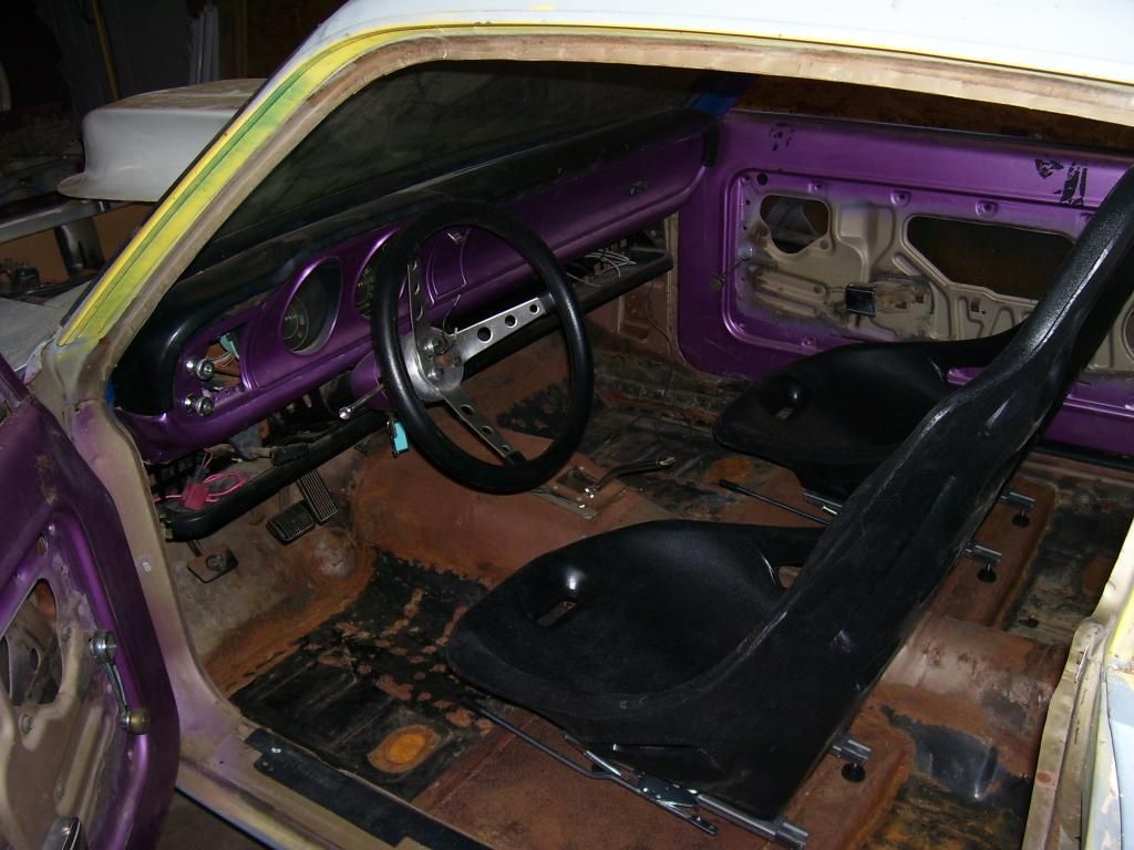

    Mocked up some seats. Need to remove some risers the previous owner put in there. Also need to get rid of the purple. Getting ready to bend my roll bar and get it in place.
    Shopping for subframe conectors. May build my own from 2x2x1/8" to keep them close to the floor pan.
    Tomorrow going to try to get the Windsor out of there. Then tower work can get started!
