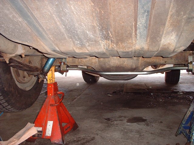

    Does someone here have a picture of the Addco rear sway-bar? I'd like to know what the difference in shape is between it and the stock 3/4" front bar...

    I have an Addco rear bar. I have to dig it out of the shed to take a picture.

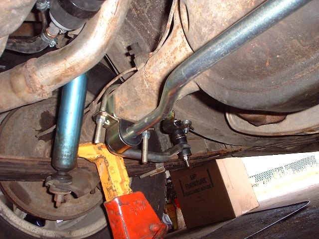

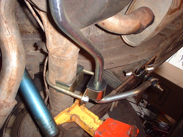

    I dunno. I upgraded to a 3/4" front bar and added a smaller rear bar to my Mav and I like the handling. I hated the excessive body roll I used to get when making hard turns...it takes corners much flatter now. Then again, I have been told that power steering and power brakes are a waste of time in a Mav too and I love mine. I am weird I guess ;)
    Anyway, here's pics:

    1 Addco rear bar for a Mav, 3/4" diameter.

    DOH! That's right...upgraded the front to 7/8" and the rear is 3/4"....

    Thanks a lot for the pics...(y)

    Mark, in that photo, your fuel line looks dangerously close to the tailpipe. I would wrap it with insulated tape.

    Mark, thanks for the very nice, clear, detailed photos! It's cool that the aftermarket auto parts suppliers are still making stuff for these cars!
