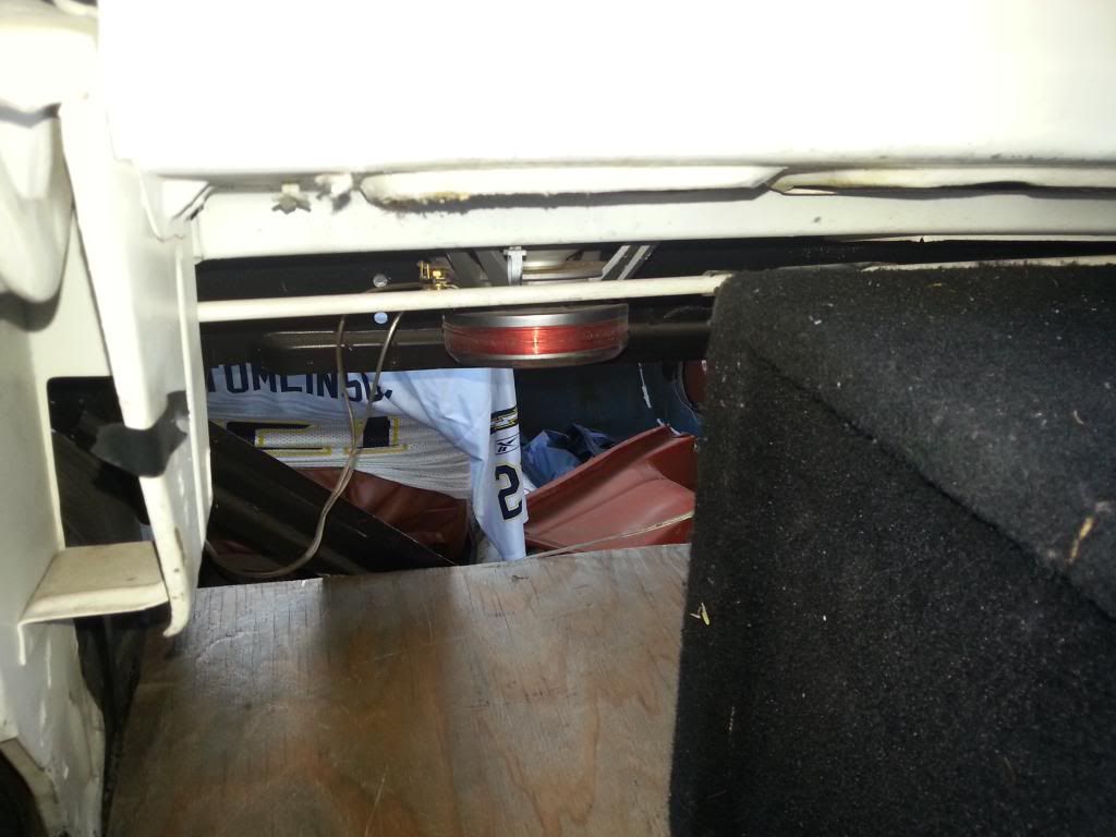

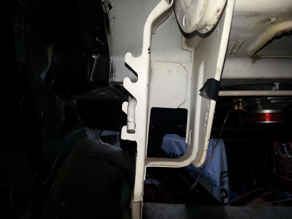

    How can I adjust the torsion bar in the trunk to it's highest point?

    where it is right now, try going up 1 notch and see how it works. If you go too high it wants to put torque on the lid and it doesn't sit square to the quarter panels. It wants to be higher on one side then the other.
    Just put a short piece of conduit sized pipe on it for leverage and move it up 1 notch.

    I use a deep well socket on a long extension. If you have a Grabber Spoiler then you need the Grabber 3/8" torsion spring because the 5/16" spring won't hold the weight

    A pair of vice grips works well also, clamp it very tight to the end of the spring and lift upwards.

    As it sits right now one the right side of the trunk doesn't line up with the quarters but the left side does maybe this will fix it.

    I seen that my other maverick and couple other mavericks have it at the highest point. I also wanted to move it all the way to the top to see if I get more clearance for my subwoofer. I want my speaker to slide right under the torsion bar but it gets in the way right now preventing me from pushing the subwoofer forward.
