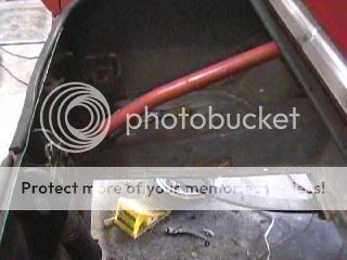

    A little background: I had a 347 c.i.d. 'trick' E.F.I. engine that needed a home. I came across and brought home a 1970 Maverick rolling chassis and began sand-blasting the engine bay and modifying shock-towers to stuff the engine (w/ 1-3/4" primary tubed headers) into the small space where once a 200 c.i. rested quietly. There began the long and winding road. Many an hour of enjoyment, frustration, and busted knuckles lay ahead.
    I'll be the first to say I'm no mechanic by any stretch, but with the kindness of you guys helping me along the way (with technical issues as well as encouragement), I've gained a ton of experience and respect for the fabricators and gear-heads throughout the globe.
    The 'latest' main issue was my determination to keep the 347 an E.F.I. engine. I believe I could've had the engine running a lot sooner if I would've gone carb.
    Anyway, after not having any success at a few different (and costly) shops, a couple of friends who know the 5.0 Wiring Harness of a '90 Mustang (my donor car) came over and troubleshot the crank/die problems. After undoing the wiring that 3-4 other 'specialists' had attempted, then re-wiring the EEC correctly, only then did it crank right up.

    (trunk before)
    (trunk afterwards)

    Mark, Yes, I have MASS AIR. I'm somewhat familiar with the TWEECER. I have a buddy who tunes them on the side. However, I see him and others always "tweaking" with the TWEECER. Ha! The main reason I chose to go E.F.I. route was to keep from having to tinker with the car at the track. Seems all my carbed buddies are constantly chasing jets and my TWEECER and F.A.S.T. friends are always spending a lot of time getting a few more h.p.s on the next run. They're under more stress than a prostitute on the front pew.
    My plan is to take it to the dyno, burn a chip with a 'motor' tune and a Nitrous tune using a "A/B" switch.
    My intention is to show up at the track, make a few Test and Tunes, dial it in, race the race, put it back on the trailer and wait 'til the next race.
    I'm sure the suspension adjustments for the track (on that particular day) will keep me busy enough. I'm hoping to just make a few adjustments on the QA1 shocks and maybe a 1/2 pound of air or so to optimize the launch.
    I'm not trying to make it the fastest car at the track - I'm mainly concentrating on consistancy and having the freedom to rome about the pits between runs.
    All this talk about drag racing makes me wish the other parts were here (new shifter, shocks, cool fire-jacket, dark glasses, etc). I'm headed back tonight to shore up a few other things too (clean up the wiring for starters).
