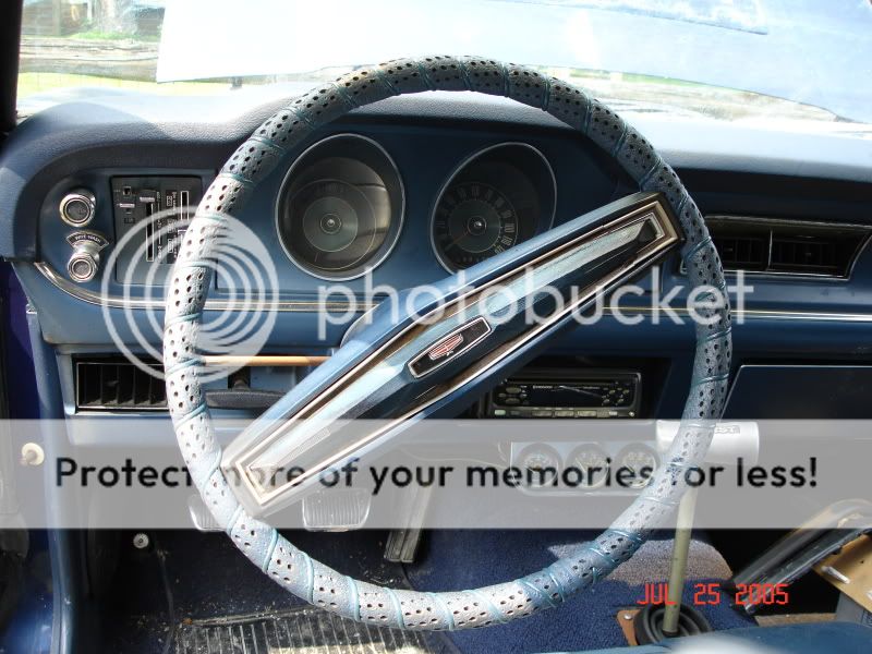

    Actually, if you cut/grind out the factory radio plate close to that surrounding rectangle line, it makes the correct size for a standard aftermarket radio (single DIN I think?) Someone will have to help with the actual size name.
    Here is how my old CD player was installed (sorry, not very close):

    thanks man very very useful

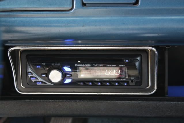

    HEres mine. Piece of cake. Used my cut off tool/die grinder. Just marked out the bracket for the single DIN. I also used some dense foam in between the radio bottom and the dash bracket for added support. Maybe spent 10 minutes on it.
