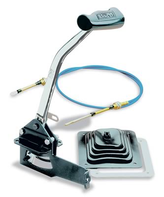

    B & M actually has a pretty informative website. You can view the installation instructions on the shifter your interested in. I got the Hammer shifter and it looks damn good with the black carpet.It came with with the reverse switch and neutral safety switches.
    Here is a link to B&M http://www.bmracing.com/index.php?id=products&sid=4&cat=2&subcat=1&pid=14
    then go down to installation instructions

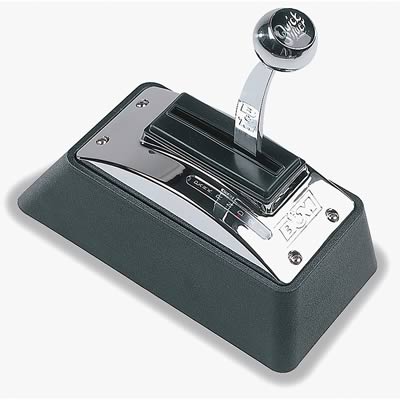

    • Ideal as a column shifter replacement.
    • Includes neutral safety switch & black T-Handle.
    • Backup light not available with this model.
    • Includes 5' cable, hardware, boot & plate.
    buy now[​IMG][​IMG]

    Look around for one that you like and has what you need. I got the Hammer shifter, it has both switches.(y)
