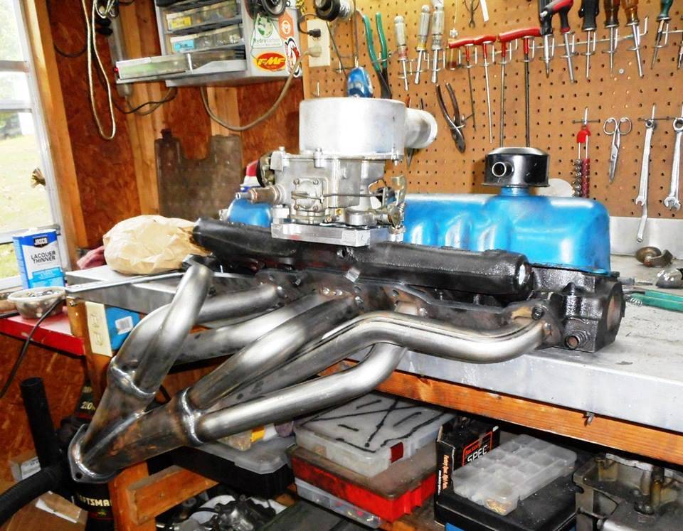

    yup. did that (myself on a Bridgeport) with mine about 5? years ago. had the machine shop deck it after i opened it up for a 2 barrel. its been working really well since. [​IMG]

    Did you notice much of a difference in performance w/ this upgrade? I know someone who has talked about doing his 250..

    yes, absolutely. I didnt just bolt the 2bbl on either , i milled the crap out of and blended the large oval hole i milled into the log the aluminum adapter(which i also made) went onto. My original plan was to get the 6-1 and turbo it, but I didn't want to go through that much fuss on this car. So, i would up using a 1.08 bore carb with some earlier discharge nozzles to get the mid range right, bumped compression up some, run an HEI distributor, port matched the header, used a divider on between the 3&4. I bought the head remanned from advance auto of all places, i think it was 220 bucks on sale, but had it torn apart immediately to do all the mods and have it checked out. and yes, its a 250 head. Def worth it if you can do the work yourself. The cam was a big help as well, i did all the upgrades at the same time, prior was a good running stock 250 with less than 60k on it. Since my wife at the time had a V8 72, I wanted to try to upgrade an I6. even with all the mods, its stone dead reliable and pretty quick. The exhaust has a nice tone as well, 2.5" all the way to the back so its throaty for what it is.
    I just rerung it. and TBH, if it would have needed block work, it would have come out and a 351w I have would have gone in, and that 250 head and header would have gone on the 200 in my 62 falcon.. But, was all good so it got new pistons and rings an a hone and good to go.
