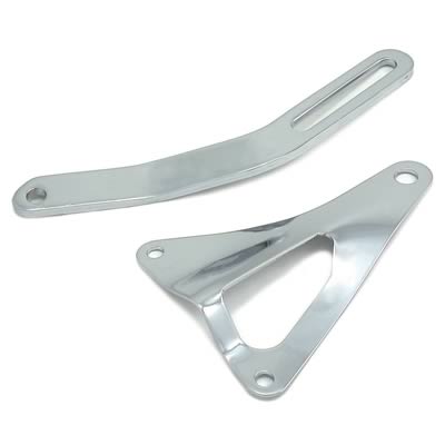

mo i see the problem. there is susposed to be a bracket that supports the top bolt. it goes from the water pump to the top bolt that is going to the head. with out that the pressure of the belt will pull against that bolt and cause the alt not be able to stay square to everything else. i think i have the bracket somewhere, and i might be geting a chrome bracke off another motor swap job i have at the shop, that i might be able to get for you.

ok nobody laugh but I actually have those 2 pieces. bought it a while ago and looked at the triangle and thought it was unnecessary. ahhhhh
Also, without the bracket, the mounting hole of the upper bolt can strip out (don't ask how I know). Hopefully yours is in good shape.
