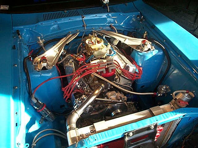

    Radiator picture!
    Here is a picture of my Griffin Radiator....not a great pic but should give you an idea....

    Very cool engine bay!
    Is that pimp daddy gold??? :D :D :D

    thanks for the pic on your griffin. I must say your engine bay looks great! How much did your Griffin cost?
