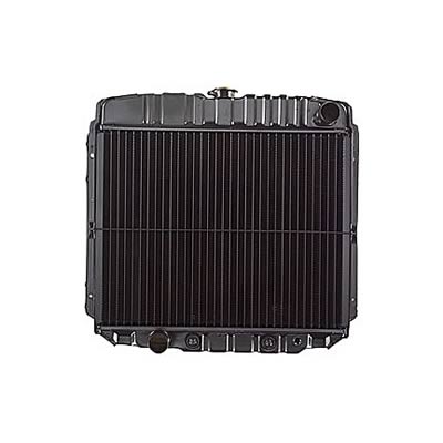

    I think I zero'd in on the part I want, but thought I would run it by you guys to make sure I am not missing anything.
    From my search, I gathered that the widest possible radiator before needing major surgery was 26". 19" seems to be a common height.
    Also found that a 'bolt in' affair is about twice the price of a universal, and that 22" wide universal is a very easy fit.

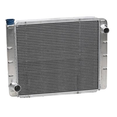

    So, here is what I came up with:
    http://store.summitracing.com/partdetail.asp?part=SUM-380425
    It is the same price and height as the 22", but is a bit bigger, while still coming in just under 26" wide.
    I thought hard about the 22", but since the money is same-same and cooling should be better... I went with the other.
    It is around 25.5" wide x 19" tall.
    The hose fittings are same as stock and same location.
    The only thing about this one is that it has no drain cock.

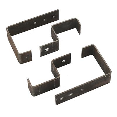

    So I purchased a hose drain fitting and also got the brackets for it so the install might be simplified.
    http://store.summitracing.com/partdetail.asp?part=SME-2201
    http://store.summitracing.com/partdetail.asp?part=SUM-380100
    Actually, I haven't purchased yet, the cart is sitting open waiting for that final click.

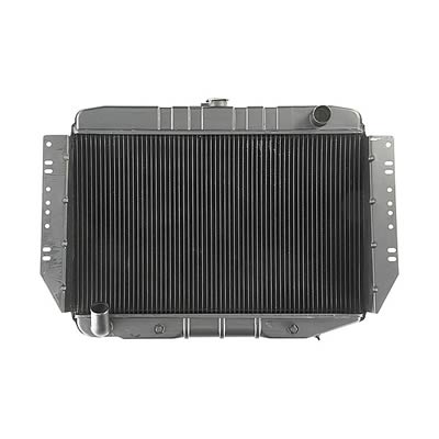

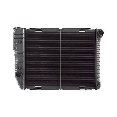

    Other options that would probably fit:
    This one is a full size car rad (390-428, and one 429 application).
    About 26" wide overall, but if you look at the lower portion, it actually gets narrower. Proabably fit fine... Looks like a stock version of the aluminum one in my first post. The inlet/outlet is same-same as ours.
    Is almost 50 bux more than the aluminum one.

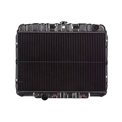

    Next one is BBF Stang.
    Not only are the hose fittings same size, they are exact same location. Not moved in the slightest. I have seen this in Mavs and all it needs is converted to the Stang mount bracket to work.
    Very large, 3 row, and I have seen 4 rows.
    The big drawback is this 3 row costs twice what the aluminum one costs!
    Then of course, there is the *bolt in 3 row.
    I really want this one, however it is the absolute smallest of the bunch AND it is well over twice the cost of the aluminum rad. It is by far the most expensive one I have posted in this thread. 360 bux!

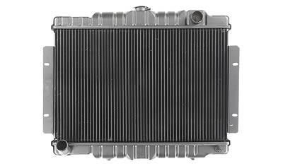

    Found this:
    Jeep Scrambler 4 row
    Same height as ours, same locations on the hoses. The lower hose is slightly smaller, no issue there.
    The width is 24", but has some decent mounting 'wings' too.
    About 230 bux.
    Should cool like crazy.
