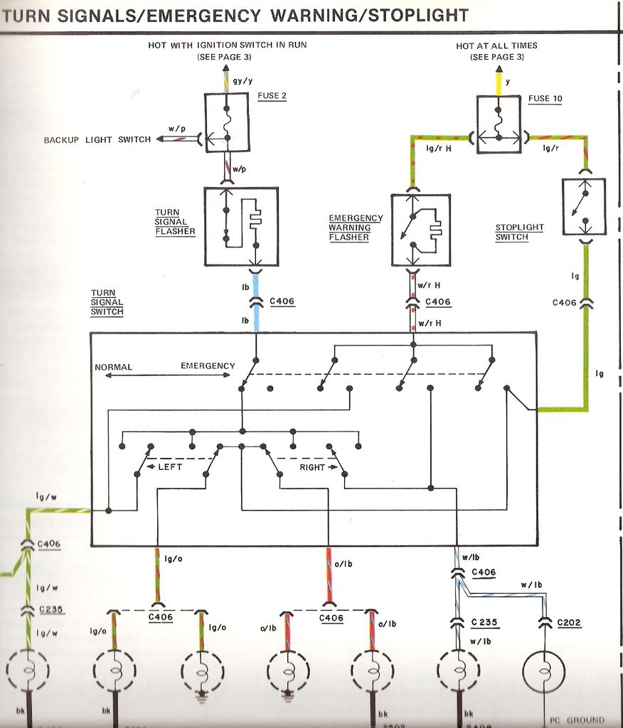

    Here's a drawing of signal/hazard/brake circuit, it's for a '76 but other than fuse supplies I'm 99% it'll same as the earlier models... Note wire color and check for power in/out of switch... Feed from sig sw to RR is Orange & Lt Blue wire, if there is no power at crescent shaped connector the problem is inside the switch...

    Alright the turn signal flasher i bought didn't work properly. Took one off my dads jeep to try and now all the lights work except the RR brake light. Is the problem in my turn signal switch where the single wire from the brake switch runs into and splits into both wires that also run the turn signals?

    Yup problem has to be inside the switch... Apparently the contact that feeds from green to the orange/lt blue wire is defective(dot the arrow is resting on)...

    Do i need a whole new signal switch/rebuild or can i go in and fix the connection?
  11. Krazy Comet
    7,710
    2,430
    Sorry I dunno, but may be possible with a cam repair kit(are you feeling lucky?)...
    Issue has to be with contact inside, if green wire into switch is broken neither brake light would operate, if it were the orange/lt blue wire neither right signal or brake light would operate...

    The RL brake light does work. The only thing that doesn't is the RR brake light. all signals work now since new flasher. Still think it is the signal switch?
  13. Krazy Comet
    7,710
    2,430
    Yup..
