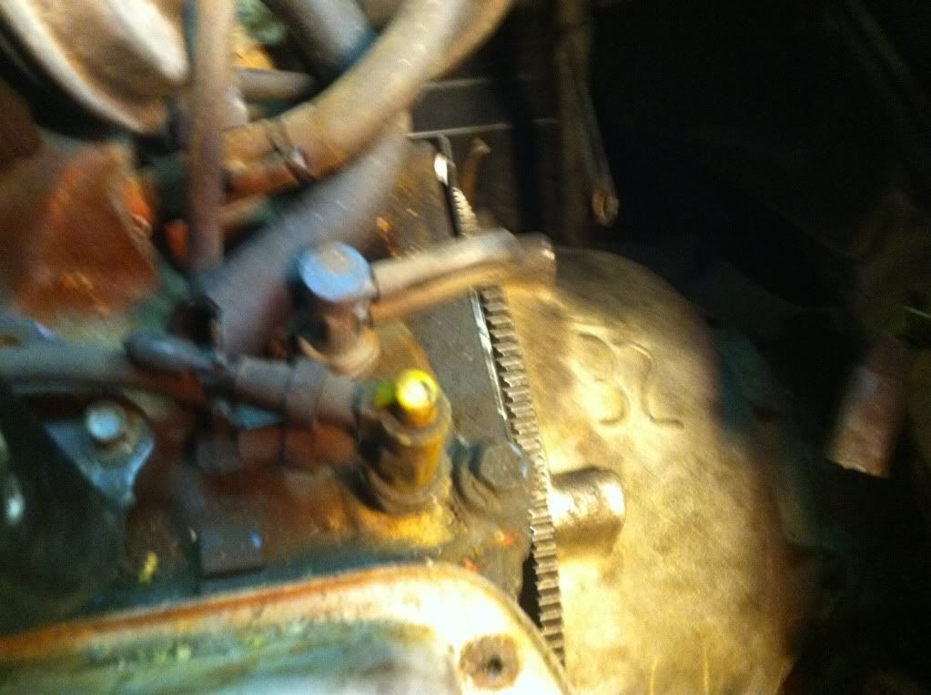

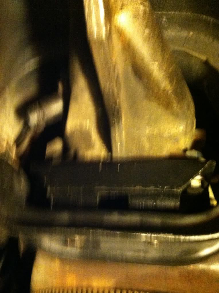

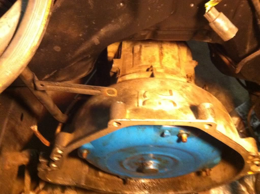

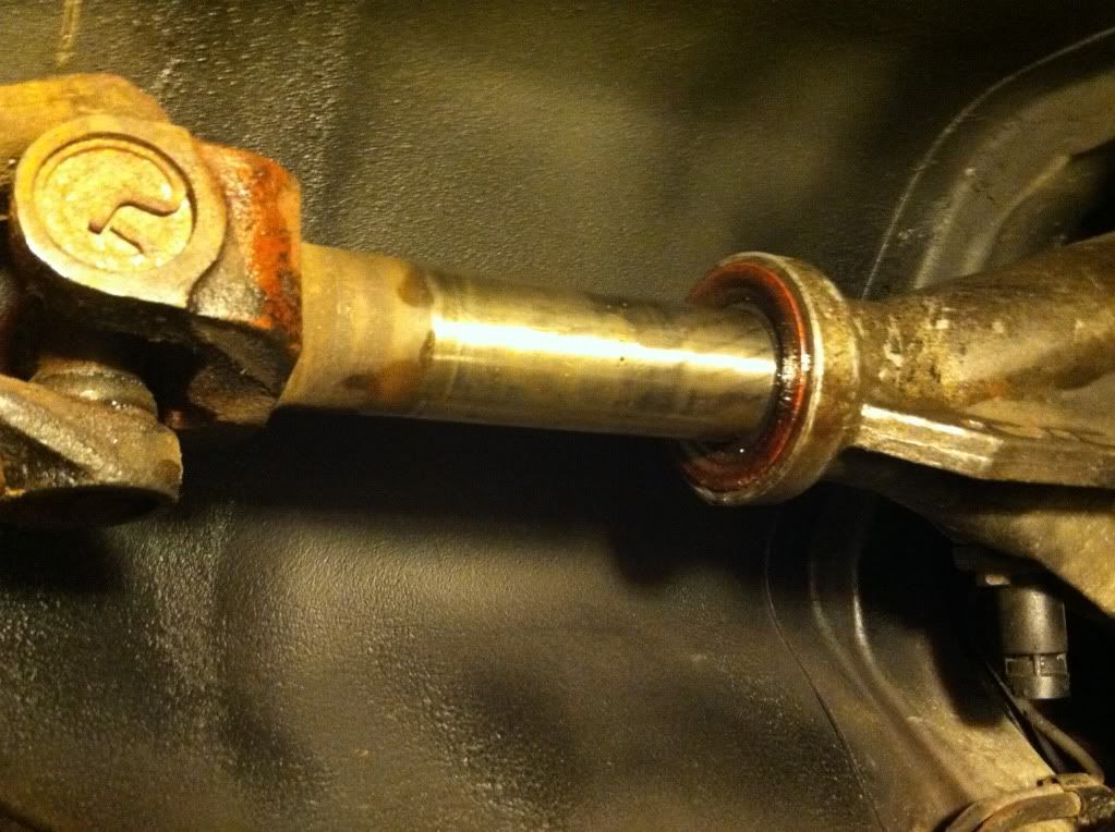

    I got it in, but it looks to be far forward. It will go all the way back on the drive shaft, then the trany mounts won't line up, but if it's that far up it lines up fine. I think I'm still having bad luck with this car lol.

    hard to tell what your asking.
    it looks like the aod is on the stock crossmember. this will put the trans to far forward in the car.
    you will need a custom transmission crossmember to make the aod work. frank (71gold) sells them.

    are your motor mount stands on the correct side?

    Be sure you connect the TV cable on that AOD, it'll be toast in short order if you don't...
