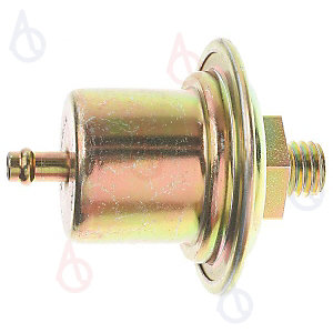

    Comet Fever hit it pretty dead on. Replace your vacuum module. They're easy to replace, and about 10$ or less from Napa

    Can Lzoesch or Comet Fever tell me where exactly is the module? I look but I just can't tell it apart from other things. Not too mechanical, that's me!

    Before you start swapping a bunch of parts, FIRST check for a vacuum leak.

    I still can't find the transmission modulator on my Maverick. Is it inside some other contraption,, so I have to remove it, like inside teh fluid pan or something? I looked all over the passenger's side underneath the car and nothing.

    Look on the passenger side of the transmission. Above the transmission pan. It will have a vacuum hose on it. If it's a 72 it will not screw in it will have a clip that holds it in. The clip will bolt to the transmission.
