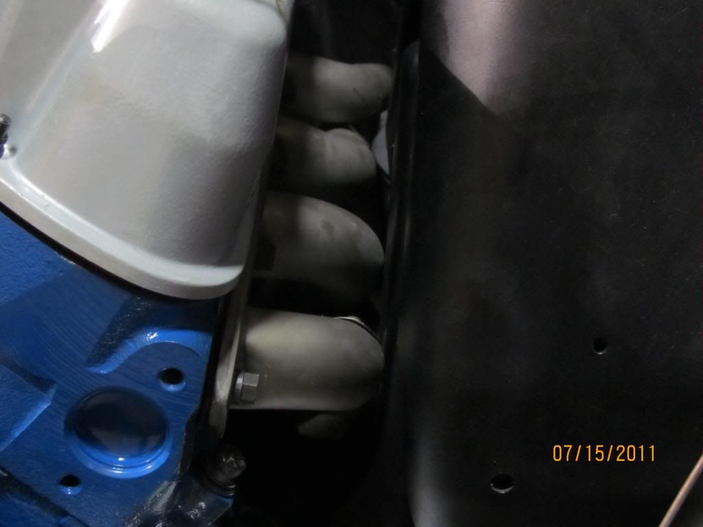

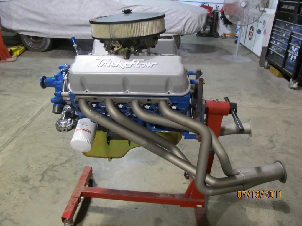

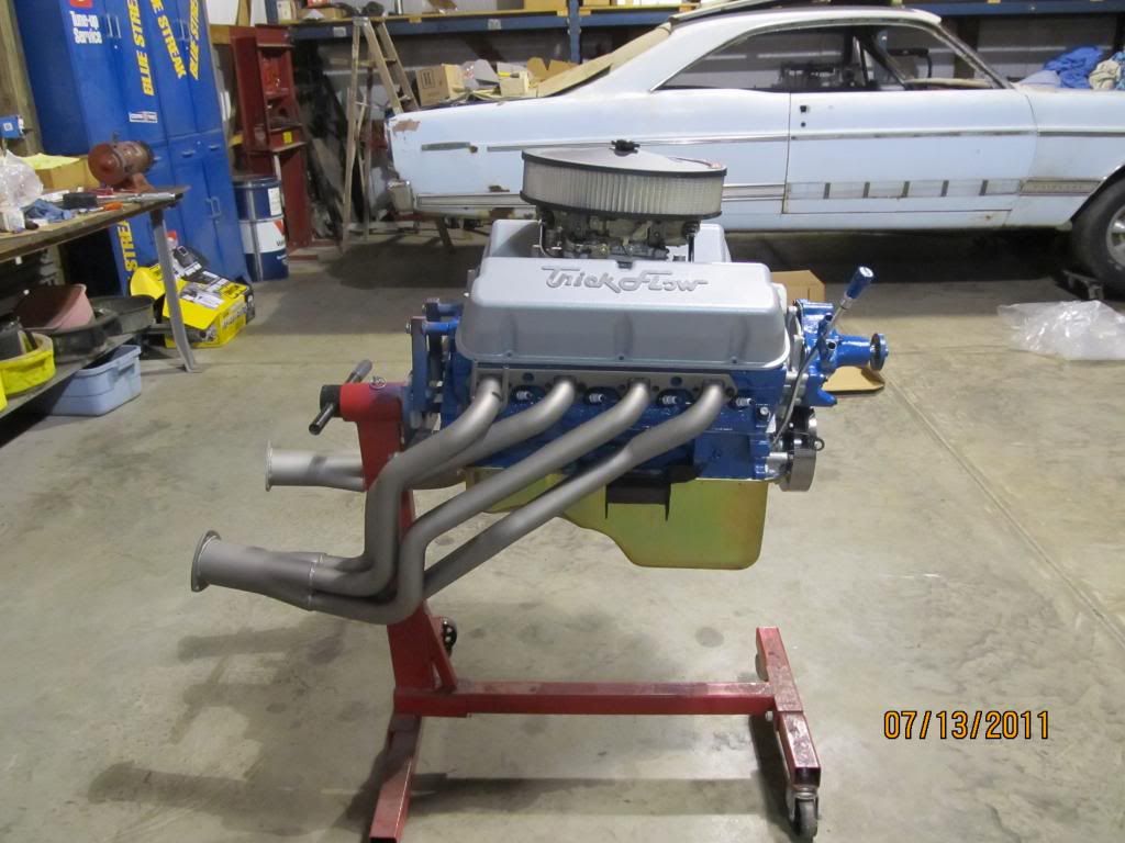

    Pictures of 6901's on stand, and installed, hope this helps ya. I am not saying one brand is better than the other, i have only used 6901's, this is my 3rd set, 3 different Mavs.
