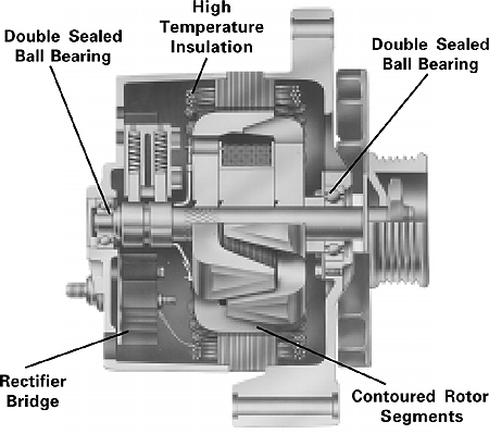

    Found it. My alternator locked up yesterday. Apparently, that bearing is supposed to go in the back here.

  10. scooper77515
    Usually just a brass bushing back there, I think???
    Might be a high-end alternator?

  13. simple man
    simple man Member
    Jan 30, 2009
    1,507
    Bunnell,Florida
    Me either! That has china wrote all over it! It looks just like the upper spindle bearing in my riding mower. I just replaced the China ones with, you guessed it, new China ones. Just for ha ha's see if your alt bearing # is 6202. The only ones I could get ( reasonably close ) were " Peerless ", made in China. :huh:

  14. rthomas771
    8,091
    980
    The CS-144 Delcotron used bearings
  15. blugene
    10,775
    That's alot bigger bearing than I have seen in an alternator.. I guess bigger wasn't better in this "case" :rolleyes:
