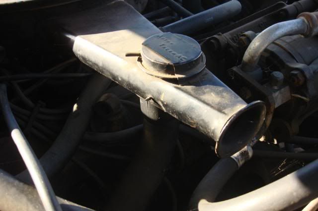

    Ill post a picture up in a bit, but I have a pipe leading from my breather back to the carb to circulate the warm air back. Right now so that air isn't flowing into the card I have clothespins holding the valve shut and so that the warm air is going directly back to the carb
