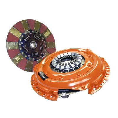

    What clutch kit are people using nowadays. Need somthing that will hold up a little better then stock but not bend factory linkage or make my leg shake at stoplights.

    I used a Centerforce ...

    I have a CenterForce that's a diaphram clutch that bolts in place of the old Long-style clutches. Less pedal pressure and about 30% better holding power.

    I have the Centerforce with the counterweights.
    It makes the pedal light, but the weights spin outward and hook harder and harder as the rpms increase.

    I have the same one as Barry.

    I have same as Dennis and Barry,, best setup I have used yet.

    Centerforce works great for me

    So the centerforce is a good choice. I was looking at a zoom but I`ll look into the centerforce do any of you happen to have the part #. Thanks for the help Chris

    I'm installing a McLeod dual disk unit with a long style pressure plate.

    Thanks for the advice. I ordered a ram heavy duty unit. I`ll probally be sorry but I like to expereiment.

    Not trying to hijack the thread, but I do have a question.
    I am adding a 4-speed toploader and 302 V8 (estimated 380 hp) to my Maverick. I am trying to select the right clutch. Should I go with a 10" or 11"? And would the long style recommended or would I be okay with a diaphragm style?
